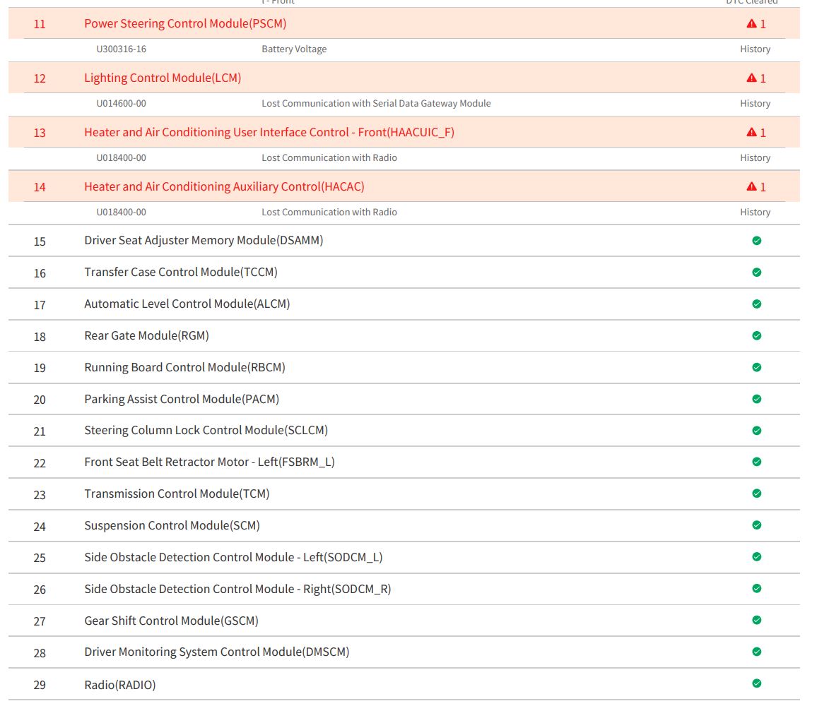

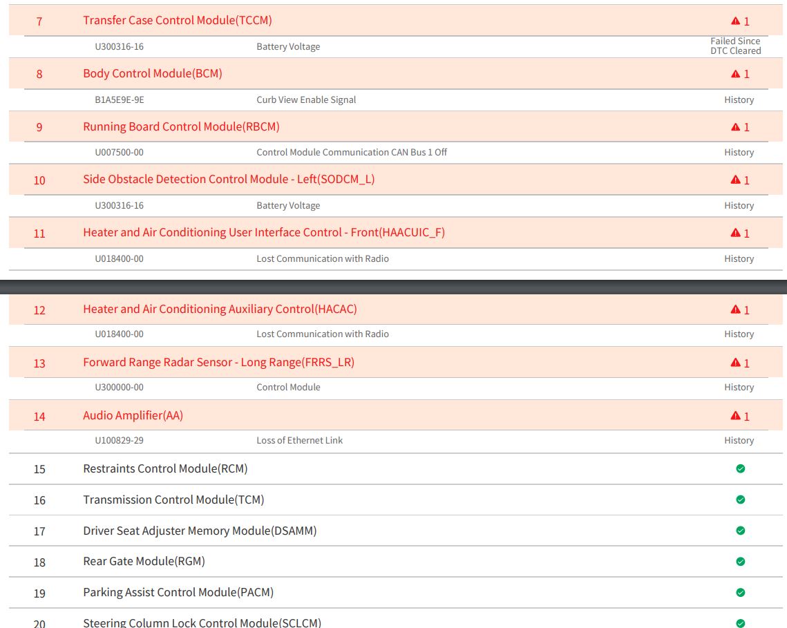

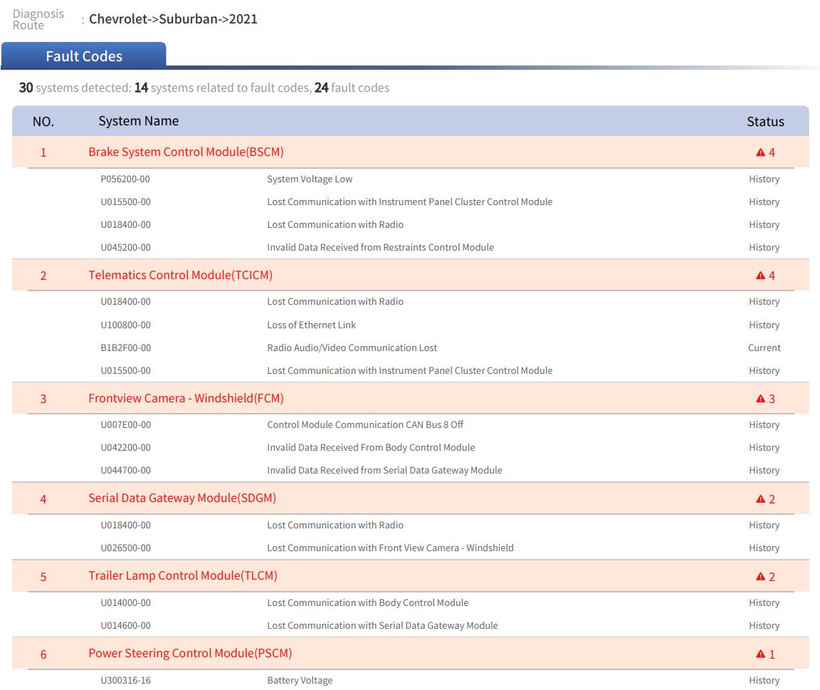

- I came back to the truck a few hours later. Truck refused to crank. Numerous errors popped up again. I pulled on my OBDII scan system, over 43 fault codes across 14 systems.

ya your code list is showing the open code for telematics, you might try digging around the web for where the radio grounds are and fuses, might get lucky
New scan; we're down to half the fault codes, still have the telematics as you saw above.
B1B2F00‑00 Radio Audio/Video Communication Lost

telematics is the only open code though, and still showing low voltage
i would use a meter and check the voltage at the battery and then check it again at the obd port, just to see if there is a drop somewhere in between
maybe also check it at the radio fuse, my guess is there is a poor connection somewhere it's kind of hard to kill a radio by just changing the battery.

I cleared all of the historical codes. Drove for about 20min and now have a persistent CEL which is new. Remaining active trouble codes are:
Engine Control Module(ECM):
U220F00‑00 - Serial Data Gateway Module Lost Communication with Transmission Control Module
Telematics Control Module(TCICM):
U100800‑00 - Loss of Ethernet Link
B1B2F00‑00 - Radio Audio/Video Communication Lost
Something is up with the TCM module, or so it seems. I guess I'll just need to deal with it until I get the truck into service.
