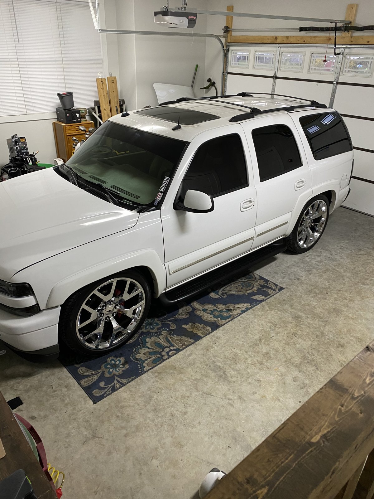

Mine drives like a dam car. It’s so low an just hugs the road no sway. I have all Spohn in my rear end also tho. I also took my bushings out an cut grooves in them and drill an tap grease fittings into my sway bar so I can grease the bushings. Don’t know if it helps but I did it lol. Should of got the ones already made that way. Less work lol. View attachment 277279
I do haul 1000+lbs of audio equipment in the back.
how big of difference compared to stock on the rear arms?
I think I’m a good bit lower than you are in the front. There’s absolutely no way in hell I could have fixed my camber without these arms. I tried the moogs, belltech cams etc. no change. All a waste of money.

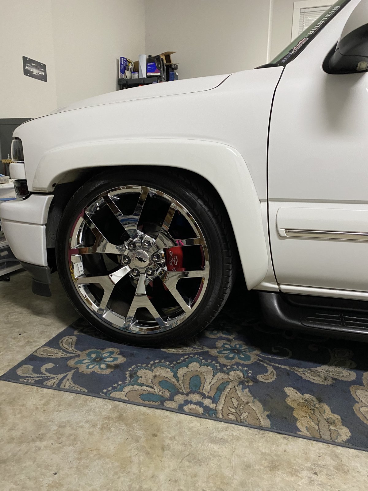

My front is exactly 31. And rear is 32 since I cut a coil an half out yesterday

30.25 front ground to fender, 31.25” rear, cut stock coils. No other coils would support the weight. Using belltech keys, spindles, and belltech bumpstops, they are smushed down it feels sloppy like a butter churn.
