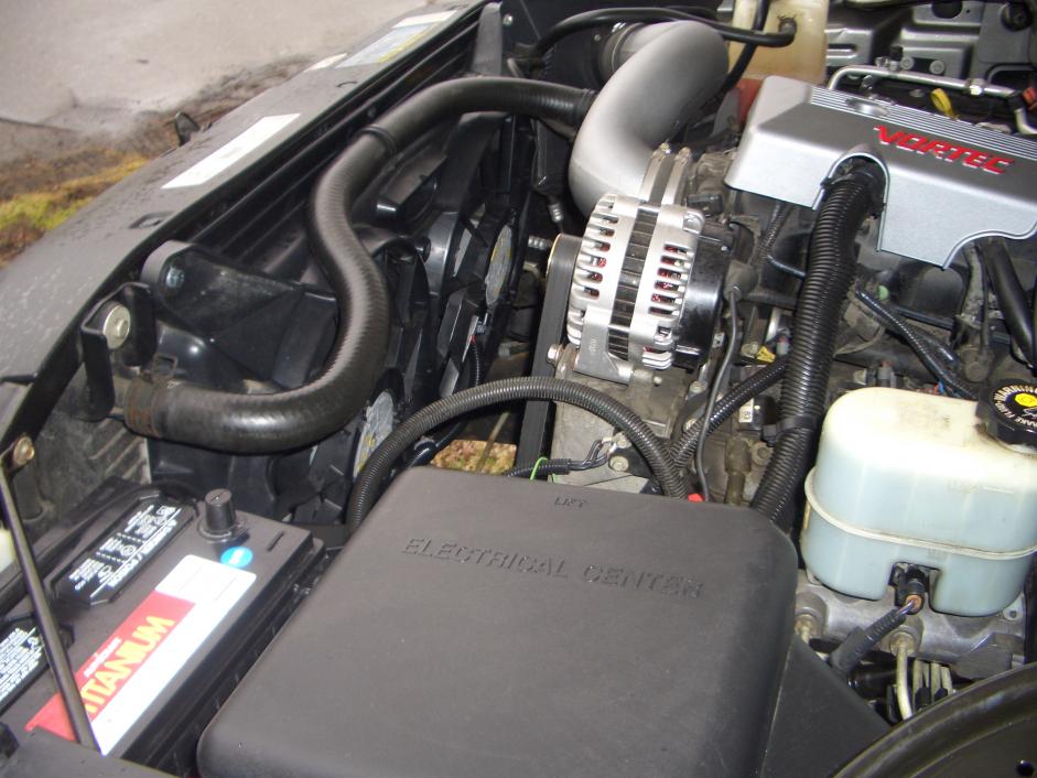

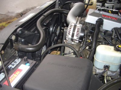

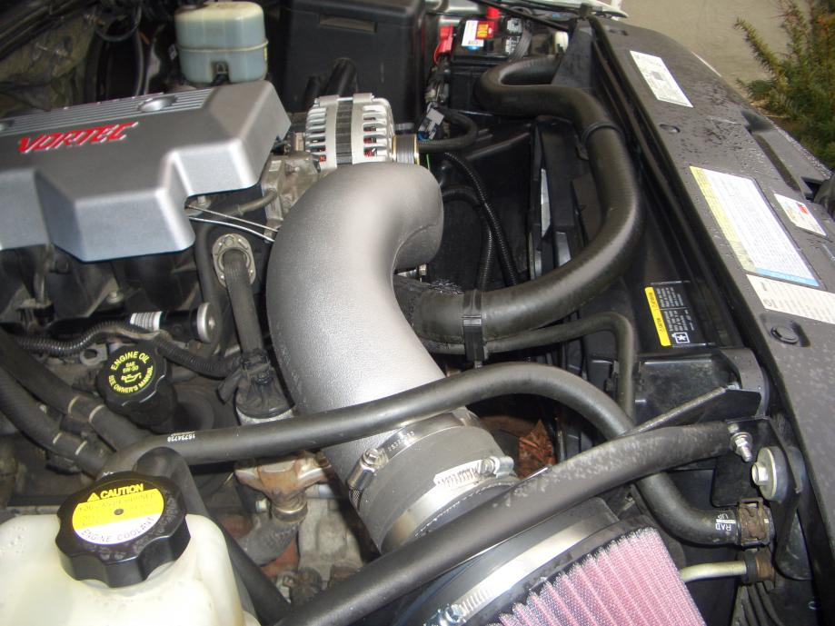

Took awhile but I finally got the e=fan mod complete, Viper smart start next and then the drop this spring

hehehehe....I JUST installed mine yesterday in the parking lot while Justin was tuning other peoples trucks...then the first thing he did was turn on my pins to make sure they work...then we tuned my truck...Installing the fans are SUPER easy...couple mins to do it...the wiring harness takes a lil longer to hook the pins into the pcm...but WELL worth it!

I was lucky to remember my tools when I went to a warehouse to get it done, Took some pics with the cell phone but they were not worth posting. The hardest part was getting the fun clutch off, If you guys want I can go take a pic of the garage that I had remove it

NO WAY!!! lol...taking the clutch fan off was totally easy...with only a crescent wrench and vise grips, it will take you (me) 40 seconds to sit in my driver seat, pop the hood, open the hood, put the vise grips on the pulley, and break the fan loose with the crescent! but pulling the PCM out, taking it apart, hooking the wires up and putting it all back together was the hard part for me...
sliding the E-Fans into place after the Clutch Fan is removed takes about 13.9 seconds

The nut wouldnt budge, I soaked it and everything no luck. It was worth the $20 to have it done, I would have ended up flippen out and **** something else up
