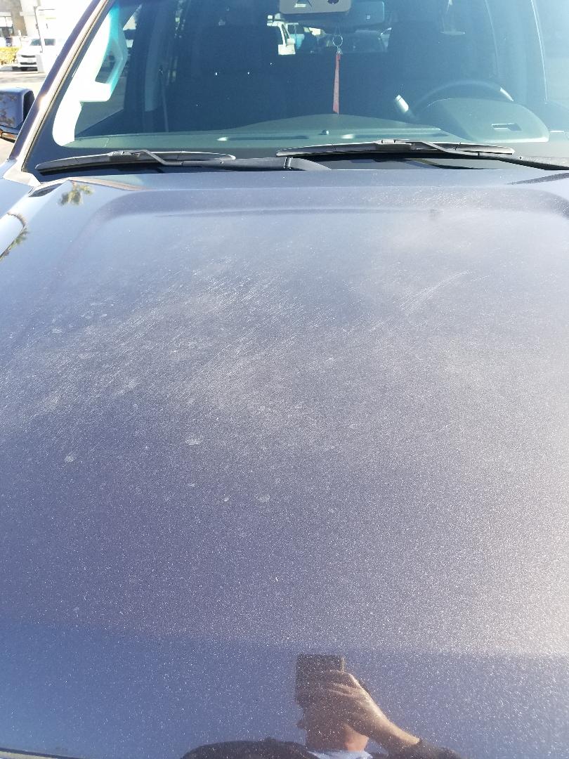

I have the issue - worst on the top and hood but now showing up all over. Anyone here actually use plastidip - it seems like a reasonable solution? Another approach - There are a couple of good videos on the issue of the clear coat failure - the guy sands and re-sprays 2K clear coat out of a rattle can. The results were impressive.
Plasti dip isn't the worst idea, I thought about it, my fear would be it would "grab" all of the little micro scratches and be near impossible to get off. I don't know if it would "stabilize" the clear coat underneath or if it would simply continue to degrade, eventually flaking off with the plasti-dip. I do love the metallic color of the truck, and I'll look for the videos of guys using rattle cans (I never had much luck with rattle cans in my painting days, too much Orange peel and such), but I'm willing to look in the attempt of saving almost 2K to fix a flawed clear coat right around the holidays. Thanks!

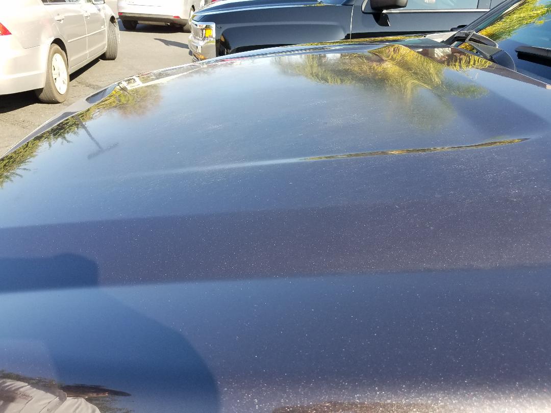

I feel your pain, the “I can’t take it anymore” scenario and then having a wash reveal your clear coat disappearing is horrible. It occurred on our 08 Yukon in 17. 1st the hood, then then the roof.
Ours is black and kept outside in SoCal 2 blocks from beach. Immediately I had it resprayed with clear. The old material kept coming up and compromised the new finish. It took a complete respray w/ prep, paint and clear again. It was $600.
The roof wants to rust really bad I can tell. That will likely be at least $1.2k. The islands are really rough on vehicles. The goal is to stop the damage before the rust begins and condemns the resale value. Wrapping it is an option that would avoid the scenario from happening all over again.
The prep for wrapping it and application may be the same as a respray. I’m am wondering what will work out best for you.

I was going to post a new thread, but then saw this. I bought my 2015 Yukon XL in 2015, from a salesman I had purchased my previous two Chevy trucks from. He's a good guy and always takes care of me. My Yukon is essentially, a "second car". I am retired, but work part time and the truck has 13,000 miles on it. I have had it washed about every month, and waxed (both by hand and machine about twice a year. The car sits for the most part in our driveway, under an awning. When you slide in, it still smells like a new car, seriously.

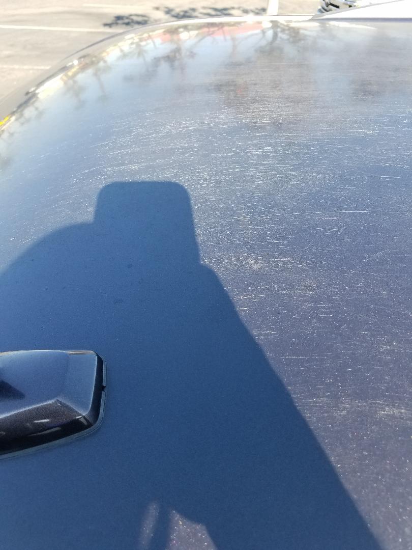

I last had it washed in August (around the middle) and the wife and I were out of town for the entire month of September. October was "wild-fire" season in Southern California and I didn't bother to get the truck washed as the ash and air would just settle on it again. Yesterday morning I just couldn't take it anymore and took it to my local car wash. I've been using these guys for 20+ years and they're typically great. As the horn went off, telling me the truck was done, I walked up to it and saw what looked like scratches and haze all over the middle of the hood and front of the roof line, above the windshield. I nearly crapped myself. I asked the guy what happened, he just stared at me and asked for the manager. The manager walked up and took a look at the car and said your clear coat is going bad. He told me it wasn't their fault and they did nothing wrong, blaming "Chevy" and their paint issues. He went on to say he's seen it happen over and over. Now, I'm no stranger to GM's paint issues, my first half-ton I bought in 92, (silver) developed problems with the clear coat in the first four months. After a rather heated debate with the service manager, they fixed it. My second truck, a 93 1 Ton Crew Cab, (white, this time) developed flaking paint around the top of the front doors and roof lines. I was able to fix it myself back and then and did so many custom things to that truck, the paint held up until the 13th year, when it began to flake off. 13 years for a paint job isn't too bad. Ultimately, I had the truck re-painted and sold it in 2015 after I bought my Yukon.
Once I calmed down and brought the truck back home, I climbed up and looked at the roof, seeing all of the same issues. This wasn't here in August (at least there were no signs of it). Seems odd it just "failed" within a two and half month window, but I suppose anything is possible.
I just received my 4th notice of recall for this truck, something to do with the possible failure of brake mechanical vacuum pump being decreased and will schedule another appointment with the dealer. When I call the dealer this morning, I also intend to tell them about the paint. I also purchased the "upgraded/extended" warranty when I bought the Yukon, in 2015. This extended warranty says it covers "everything", bumper to bumper (excluding of course damages due to neglect and excessive wear and tear) for 8 years or 180 k miles (or so). So, we'll see what they say.
After reading so many posts and discussions in forums around the web about failing paint, and/or clear coat issues, I am concerned about it. I know paint is a tricky thing, the "trick" is to get a quality, lasting paint job, while maintaining profits and complying with the environmental requirements. But so many issues, I'm sure one could make the "environmental" argument (truck is parked outside, isn't properly cared for, living near an airport and getting covered in jet fuel, etc. ) but if that were the case, it would be every car in my neighborhood, including the wife's 2014 Toyota LC, which sits outside as well and the paint is fine, aside from the scratches on the side when she sideswipes bushes on the side of the road, but that's another issue. The photos don't do it justice, and maybe I'm getting worked up prematurely and when I call the dealer will say "no problem, we'll fix it", but.... I may be a bit too cynical for that. Wish me luck- I'm hoping they'll either sand/repaint the clear coat, or remove it and polish. I still believe a good color sanding will fix it, but my paint expertise is 25+ years old. View attachment 233726 View attachment 233727 View attachment 233728
That is EXACTLY how my hood and roof looked before getting them both repainted. I mean EXACTLY!! I work at a GMC dealership and have yet to see anyone else with this issue just yet.. This thread is the first that I have seen of anyone else have the same issue.....I have extended warranty also .. The best you may get is GM doing what they call a "good faith" discount where they will cover a % of the cost to repair....Really comes down to how good the dealers GM Service Rep is for the dealer...That is the guy that the service manager will have to contact to help on getting it fixed...Either way it is disappointing to see this on the vehicle.. I ended up having mine re-done about a month ago on my own

My 2016 (brownstone metallic) is starting to show pretty noticable streaks/blemishes in a cross pattern. We have kept the vehicle clean and washed weekly with waxing twice a year. Has anyone else had this only on their hood?
Unfortunately, we are stationed in Hawaii. Detail places can't correct the issue, recommended new paint. Auto bodies state they can't repaint the hood and that the issue is how the hood is machined from the factory and that a new hood is required. Seems a little far-fetched and slightly sketch, but that's expected out here with labor rates through the roof.
Worst case, I may plstidip the hood black to match accents until we get back stateside. Open to other options as well. Thanks!
