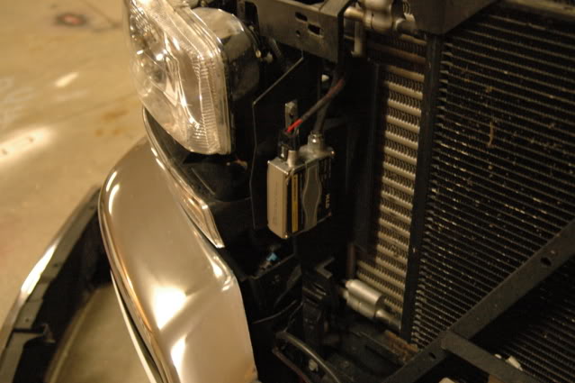

2) Ballast Mounting:
There are various locations to mount the ballast first lets start with the lows. The ballasts can be mounted on the radiator shroud either on the headlight side or radiator side. I mounted mine on the radiator side, I drove around in heavy rain and snow and not once did they get more than a few drops of water. Some people have mounted them behind the headlight assembly as well. Now for fogs. I mounted mine on the skid plate, I stuck them as far to the middle and as high as possible. Again, after some rain and snow driving I checked and both remained completely dry. There are many places once you crawl and look under the truck, I just found this to be the easiest and it kept them completely dry. Yes, a separate ballast is required for each light.
Here is where I mounted mine (not my pic but same place)

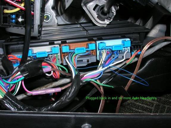

5) Auto-on Headlights
Probably one of the most asked question I have seen. With HID's if you run a harness than all is well with auto-on. However, with no harness the ballast is starved for power at start up and the lights flicker, this will reduce the life of both bulbs and ballasts. Auto-on lights can be disabled by connecting 2 wires at the BCM. To get to the BCM first remove the dash around the ac/radio/steering wheel, simple pull this piece off. Then you will want to unbolt 2 bolts holding the panel under the steering wheel on. There will be 3 connectors that can be seen. They are j2, j3, and j4 (left to right). To disable auto on you will want to work with only j3 and j4 (middle and right units). You can simply run a wire from the white wire on J3 (wire A4) to the black wire of J4(wire B7). This can be done in various ways, using a quick tap connector to run a 18 gauge or smaller wire between the two. You can also strip back some of the insulation and solder the connection (preferred). I will admit I used quick taps but I made sure to tighten the connection and tape all wires. I have used quick taps before and it lasted the life of the vehicle, but soldering is still the better option. You can also run a wire from the terminal of each wire if you would like. As a safety precaution unhook the negative side of the battery before doing any of the above. Here is a photo to help.

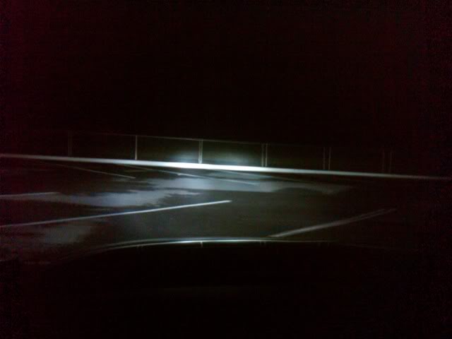

Lows only (slightly downhill)
Lows and highs

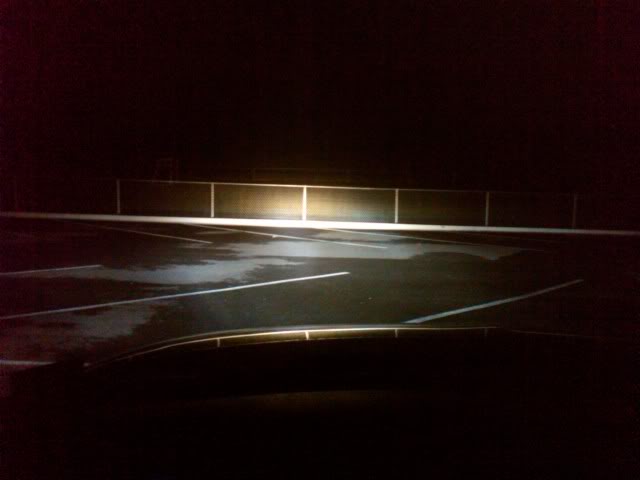

Lows and fogs

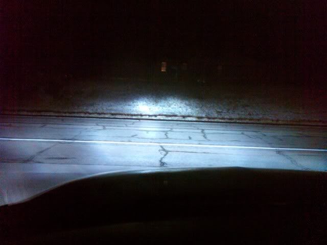

Lows only, even ground (wet)
6000k VVME HID's
