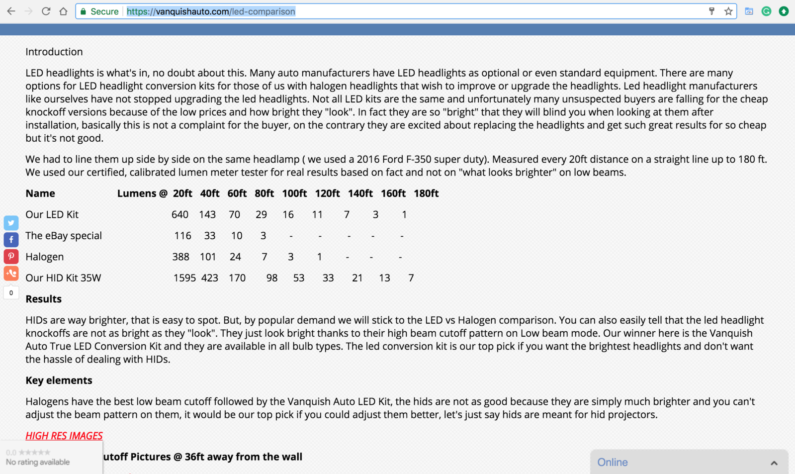

Hello folks, now I’m in a sticky situation I’m going to get some HIDs for my headlights and I’m stuck between getting 6k or 8k. I want my lights to have that new Audi headlight color so should I get 6k or 8k? Also if you have 6k or 8k lights please drop some pictures of them thanks!
Hello, i am more than happy to answer that question for you: HIDS will be your best choice but no any hids., we have a complete review between leds and our hids., our hids are brighter and give more light output than any led kit and our hids dont give glare!
Here is the review link you can look at it and decide what to go for! If you can tell us your car make model and year we will give you the right links for the lights you need. Thanks
https://vanquishauto.com/led-comparison
