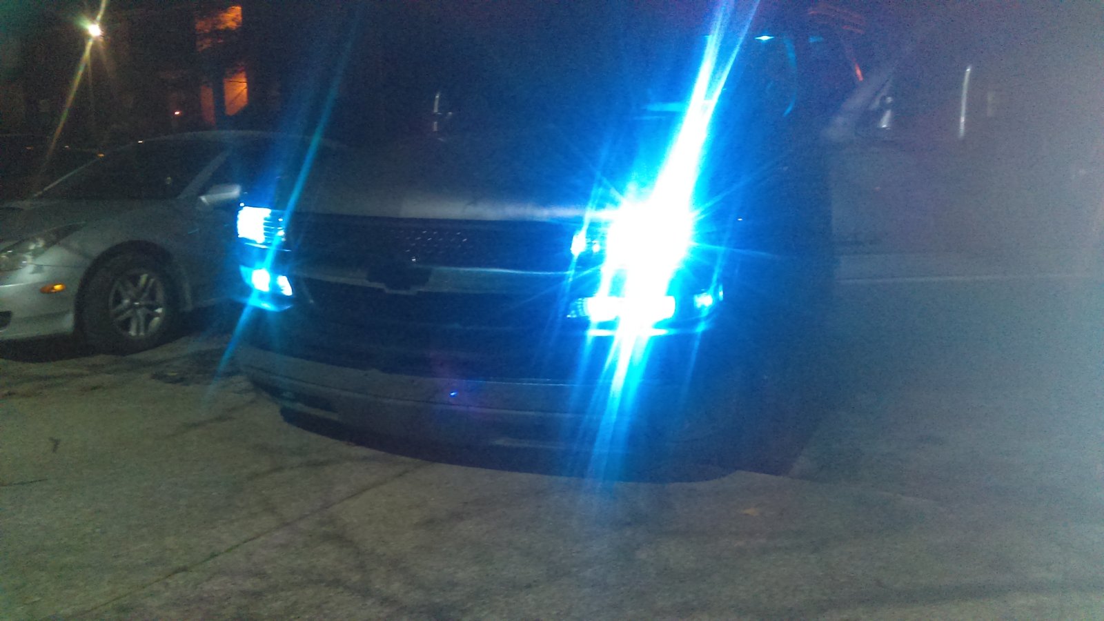

8000 k

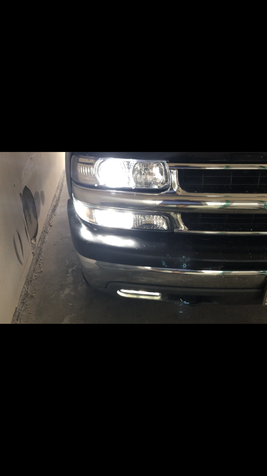

If you want Audi color then it's going to be 4300k bulbs... that's what every OE uses. Now if your seeing any blue when looking at it, it's because you are in the color part of the cutoff. They all have hid projectors.
Mine are 5500k bulbs on 55w. So pretty much 5k and pure white. But if you look at them in the color band of the cutoff you can see blue and purple.
View media item 23977View media item 23976
