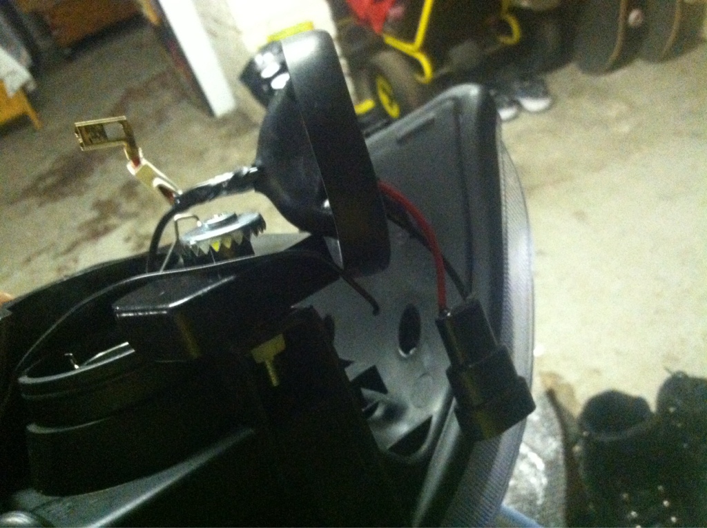

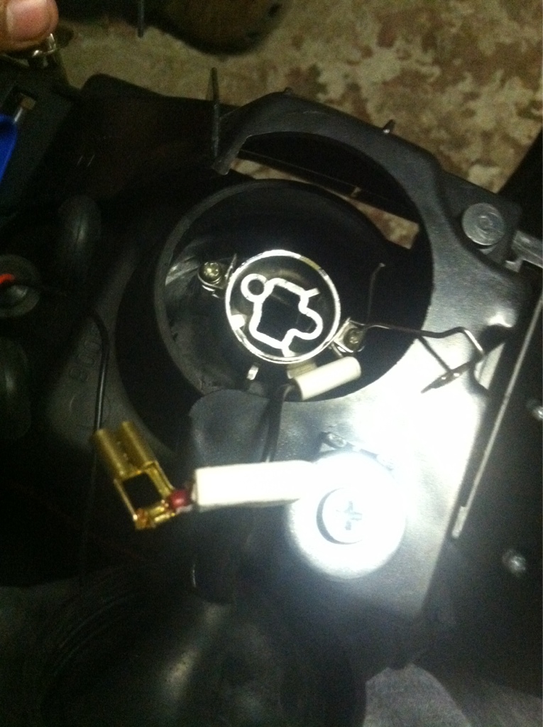

I know Hids should be put in proper projectors but i stumbled upon some cheap halos and need some help.
Will the h3 hid bulb fit in the socket? How would I wire the hid to the headlight socket which goes to the existing wiring?
Attached is a pic of the wiring and and socket.
Thanks

Ah. The pic wasn't showing up when I first posted.
It looks more like a h1 to me. But if the housing days h3 then it's a h3.
If your putting a hid bulb in, then you will have a h3 bulb with amp connectors, those hook to the amp connectors on the ballast. Then you can plug your stock 9006 plug straight into the ballst. Or the preferred way is to use a relay harness to power the hid ballast

It had a halogen bulb I presume, did the old bulb have a screw in it to secure it? Or just the fold over tab? Cause like I said it looks alot more like a h1 bulb socket to me.
Can you post a pic of the h3 to 9006 adapter. Particularly the h3 side? Just want to make sure

It is an H1 the lights came with a wrong booklet which states H3 should be used but the old bulb says H1
Here is the pic of the wire harness

Ah okay. I thought so. Just wanted to make sure you got the right bulbs.
Yeah thanks for the heads up, now wiring up the hids, what would I plug into the h1 to 9006 harness, the wire from the ballast?

No. You won't use that harness. Your going to plug your stock 9006 headlight plug into the ballast. Then the ballast and hid bulb will have amp style connectors to hook the bulb and ballast together.
Your going to have to take apart the amp connector to slide it through that weather boot on the housing.
Here's a how to on that. http://www.hidplanet.com/forums/showthread.php?36026-HOW-TO-Take-apart-AMP-Connectors
If I remember correctly, the last time I ordered the HID kit the connectors looked like that already, but if not all I do is stick a flat head into it to remove the plastic?
And thanks for the responses, I appreciate it.
Also do I need that metal base off the old H1?
