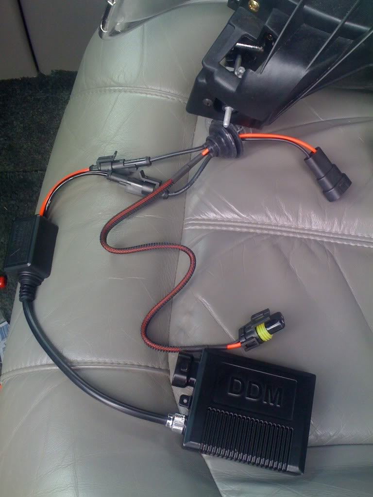

i bought a ddm 8k 55w kit for the high and low beams and a 8k 35w kit for the fogs and was wondering where the hell the stock plug goes in. i got 2 pics if you guys can tell me which is correct.
A.
or
B.
sorry if this thread is in the wrong place

There is a wire going through the black grommet that is loose and you can pull it both ways, you can remove that. with 55 watt kits you should be using a relay harness, usually the 35 watt kits your okay running with stock wiring. But your stock 9006 plug goes into the ballast, then the 2 wires out of that ballast go to the light bulb.
