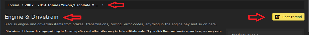

Click on the link that @clandr1 posted, that will take you to the correct forum for this subject. Then select the "Post thread" button and it will open up a new thread for you in that section. Give it a good title and enter your text for the first post. After you post it you can manage the title later if you need to.
If you want to start from scratch in a different location, select your desired year and sub-forum from the main page (like the 2007-2014, "Interior" etc.), and use the "Post thread" button in that sub-forum to start a new thread. If you happen to start a new thread in the wrong forum, let one of the mods know you'd like it moved.
