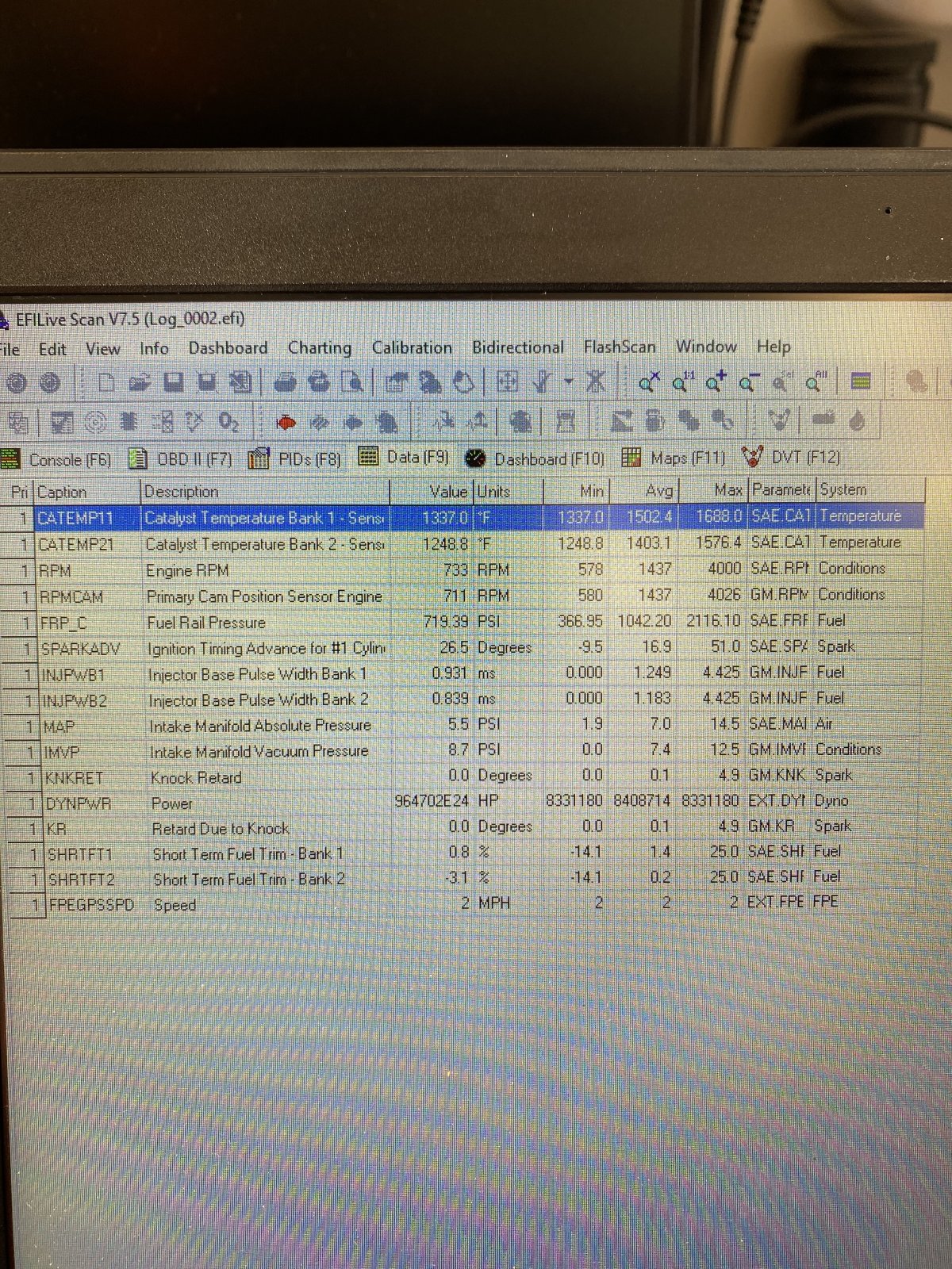

Here is a screenshot of the data from this morning at idle. I missed a couple important pids on this list, will add them for the drive home.

You have an injector leaking on bank 2 according to those numbers. The map readings are off too, you either have a bad MAP sensor or a vacuum leak somewhere. Look up the MAP readings via multi meter and check it or just replace it. It could also cause your injector issues. If it checks out OK, search for a vacuum leak.
Did you get the +32% fuel lobe with that cam?

Thank you. I can’t tell you how helpful it is having someone with experience look at these numbers. I’m very green with efi live. When you say leaking, do you mean leaking compression, or passing fuel?

Looks like an injector is leaking fuel but they could also be the source of a vacuum leak.
