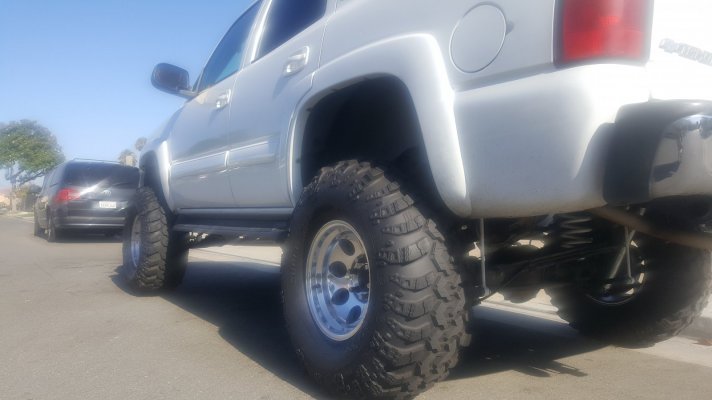

Its 2wd with a procomp 6 inch control arm drop bracket kit with 3 inch lift spindles on top of that for 9 inches of total lift.36 inch super swamper irok's on 16 inch procomp 69 series rims.i need to put a 4.11 ring and pinion because of the tires.does anyone know if it is difficult to change that out?i did the whole lift by myself and it was the hardest thing to do.nothing fit.the bolt holes were off.i had to pry everything in place.took me 3 days to do it.procomp had to send me a new main crossmember because the first one wasnt welded correctly..but i do have to say that it rides just like stock.its a very soft ride.i shouldnt have got these tires though because im rarely in the dirt so at $350 a piece it was a waist of money i think.but whatever

Its a procomp 6 inch control arm drop bracket kit with 3 inch lift spindles on top of that for 9 inches of total lift.36 inch super swamper irok's on 16 inch procomp 69 series rims.i need to put a 4.11 ring and pinion because of the tires.does anyone know if it is difficult to change that out?
Nice rig well im guessing its 4wd so you do no you have to change the gears-ring and pinion front and back right.Not the hardest job but setting backlash you should no what your doing.Get your check book out.Those size tires and stock engine i would say you need 456 or 488 gears,or you will be getting smoked by prius and chevy aveo.

I agree with @corvette744, your gonna need more gear than that. I had 5.13 in my OBS Chevy with 9” lift and 36’s. That was just about right. Could still cruise down the highway at 90-95 no problem and wasn’t a dog off the line.

I was going to say 513 but that would add another 500-1000 for 2 cases-with the 4 series gear he might be able to get buy with thicker gear.
I do believe your right. It’s been a while since I had done it but I think over a 4.56 you need a new carrier too. It was a big cost I do remember but I did the lift, tires and wheels, gears set too.

Well gear sets are like $175 at summit ,and the shim kit is like $80...im selling it for $8,000
