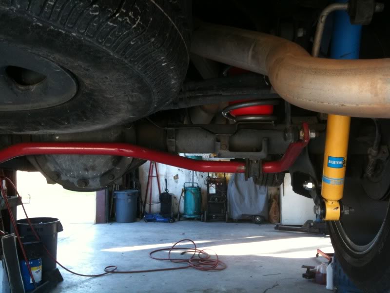

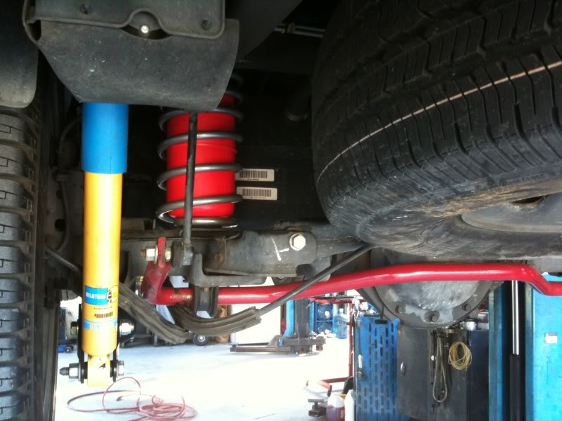

Finally got around to installing my helper bags. "AIR LIFT 60769 1000 Series Rear Air Spring Kit" was the kit I used. Purchased off Amazon for $75.

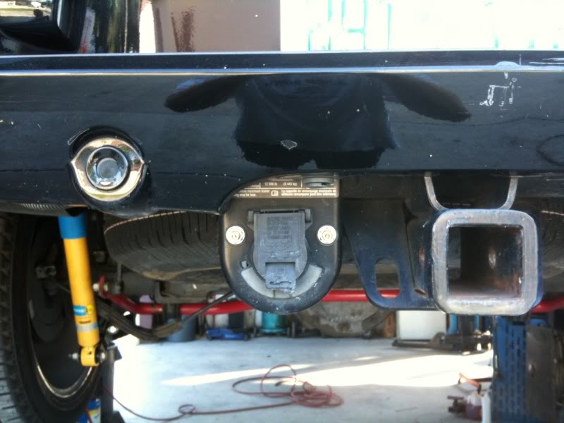

AMAZING difference, solid rear end now, no bouncing, no swaying side to side. I decided NOT to T the fittings together and ran valves to the back were my tow hitch plug is. I'll be painting the fittings black so they blend in, but it's about time I had this done...
Right now I have about 1 pound of pressure in each bag. Just enough to fill it and let the suspension firm, but if I put any more pressure in it, it would raise the rear end up.

very very nice...mine is still running with one blown bag...and I haven't ordered a new one yet...maybe I'll do that now...how did you like the Bilsteins?
Rides like factory. Actually, honestly, the whole truck rides great. I know I did EVERYTHING at once, but I really can't tell the truck is lowered. Feels like the factory ride.
