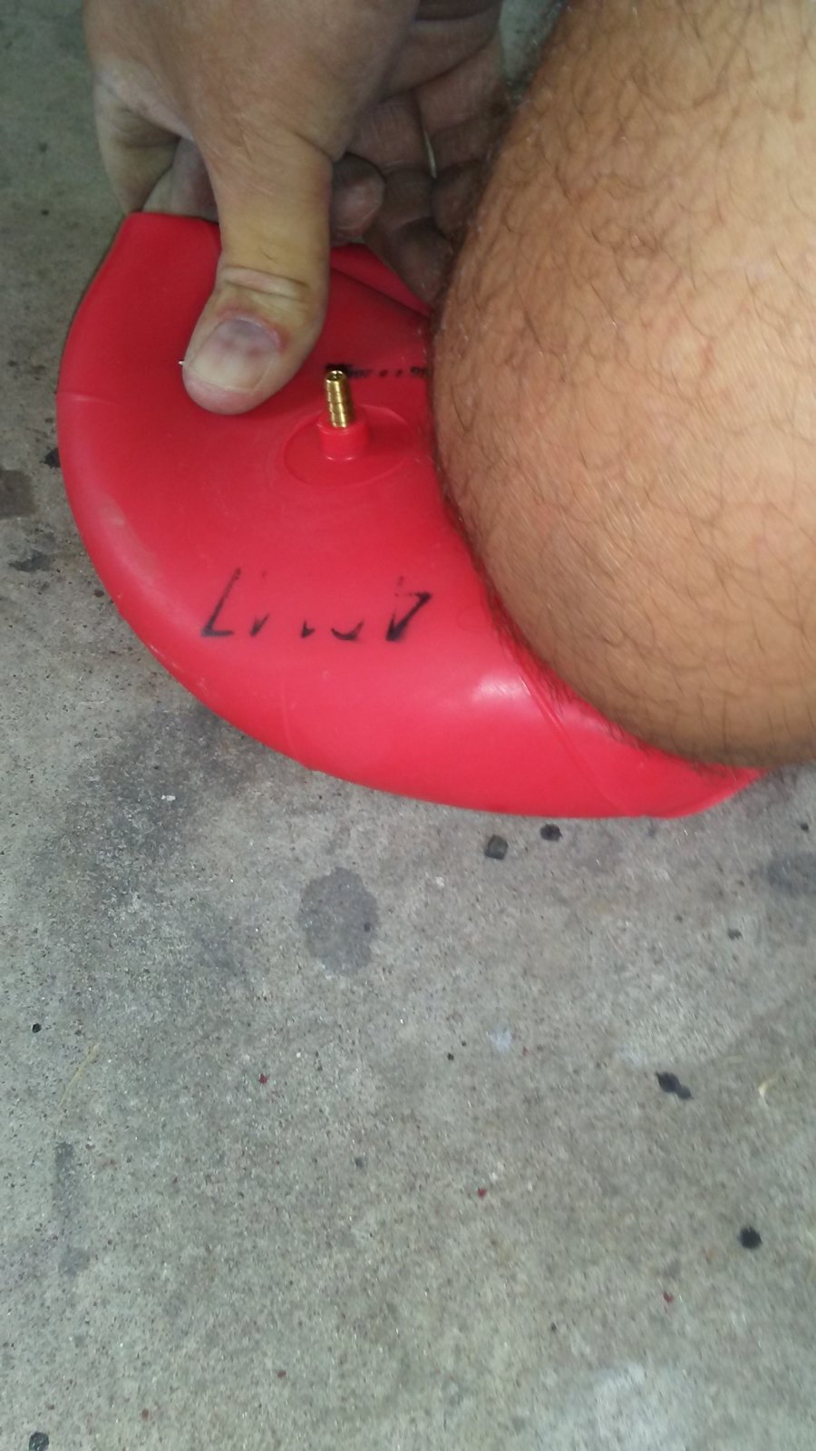

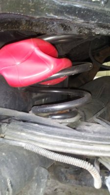

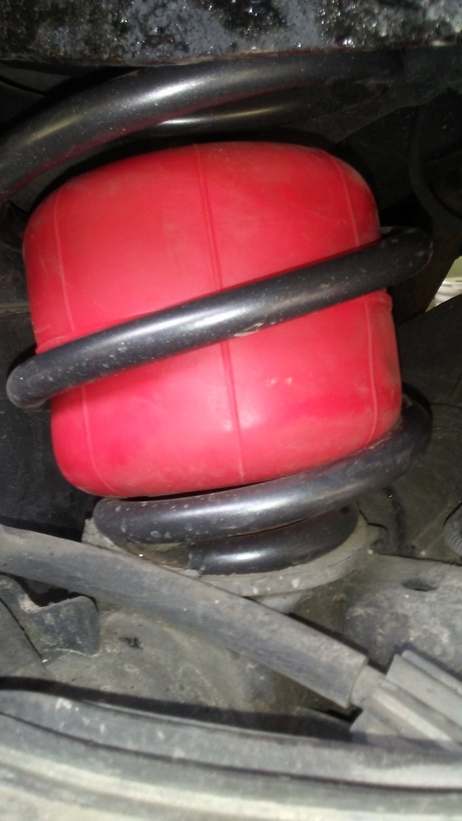

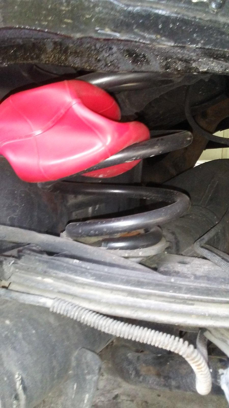

Well ,got the bags installed ..I think I need longer bags.But spring does compress ALOT when full weight is applied.Bag only inglates between two coils.To my surprise it lifted the rear with 25psi,guess we will see how they do when I go to haul my 85 c10 back from paint shop ..6 hour trip!Install was stupid easy ,I did have to put back with hose to the bottom,couldn't reach top to route the hose,plus these springs are progressive so no room..Should be ok.I hope..
