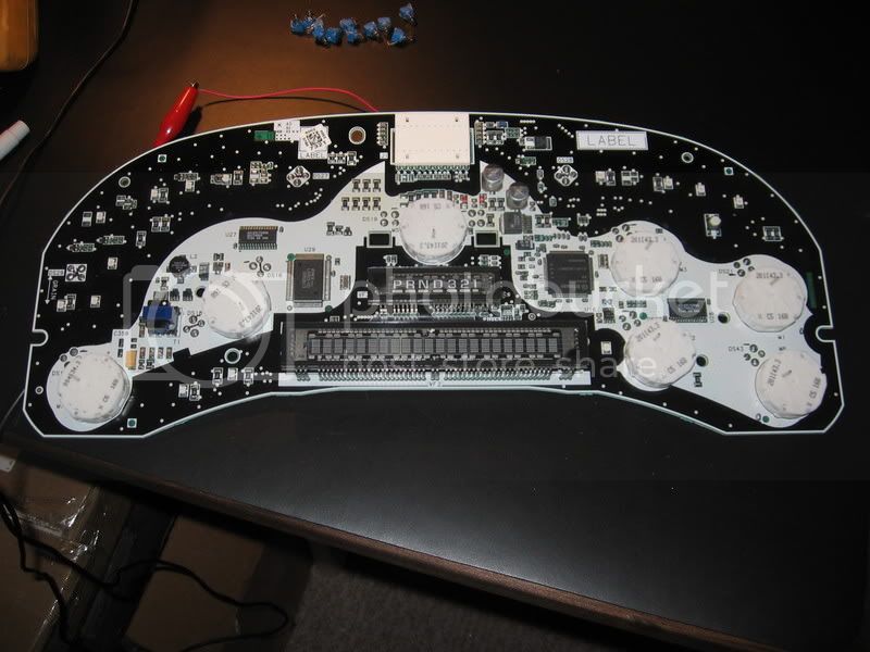

This is what the 03-06 gauges look like and you can see the LEDs

Nathan, you are correct that the 03-06 are not twist off 194's, but they are also not LED's.
If you look at your 03-06 pic, you can see all the mini bulbs with blue bases piled up at the top of the pic. That pic is actually a write up of switching over to LED's.
If you are good with a soldering iron, you can just buy mini-bulbs at Radio Shack and solder them in on the 03-06 clusters.
