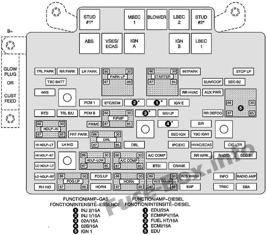

I would definitely check the fuses first. Start with the fuse box that is in the engine bay, and the inside cover should have a diagram identifying the individual fuses.

In the under hood fuse relay box there are relays and fuses that are related. You can swap other relays, that are the same, to see if that helps.

HERES THE PICTURE.
Thank you for the welcome.
Not sure where I have to type..
