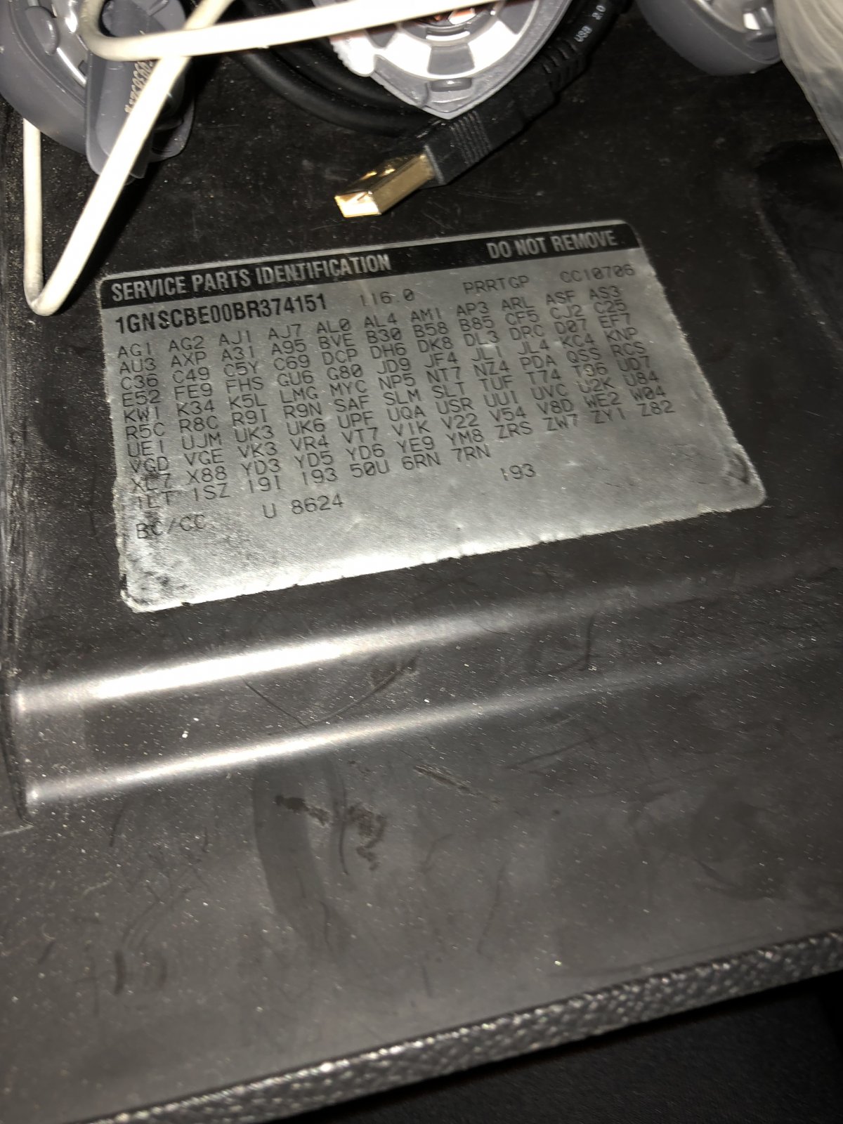

Hey all,
I have a 2011 Tahoe lt/texas edition, with the zw7, 6RN/7RN codes. Ill attach a pic of the build sticker
The last time I replaced shocks/struts I replaced with the following part numbers and the ride just wasn't the same... I double checked my work and part # and they kept showing as correct...but something was off..the ride wasn't as smooth, especially over bumps and stuff. I know its not going to be the same as when it was new but it felt like a completely different and much older vehicle.

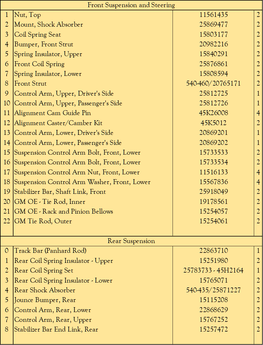

Those are the right part numbers. If you did not change ALL of the other components then it is not going to ride the same. The strut mount, spring pads, etc. all play their part in delivering a nice ride.
Mine rides like an old Cadillac going straight, handles better in the turns and these are the parts we changed:
Pay particular attention to the smaller parts like the seats and insulators and jounce bumpers.
