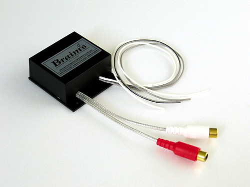

get a hi/lo all u do it tap of a stcok speaker wire and makes a low sig for the amp

thats what a hi/low will give u
---------- Post added at 06:18 PM ---------- Previous post was at 06:16 PM ----------
just what most of them look like can get them at an audio shop bestbuy...

Ok that makes sense, thanks a bunch! Just one more question if you don't mind what would you recommend for the 12v power wire?

its only pulling 25 amps.. u can run 8 gauge.. that amps not putting out 850 watts tho, more like 250 i know what it say . but most other amp draw like 80 amps if it a 800 watt amp. i would run 4 cause u might end up getting a bigger amp.

i have a pac module that will give you the rcas and the remote turn on , i will let you get it for a good price pm me if interested
