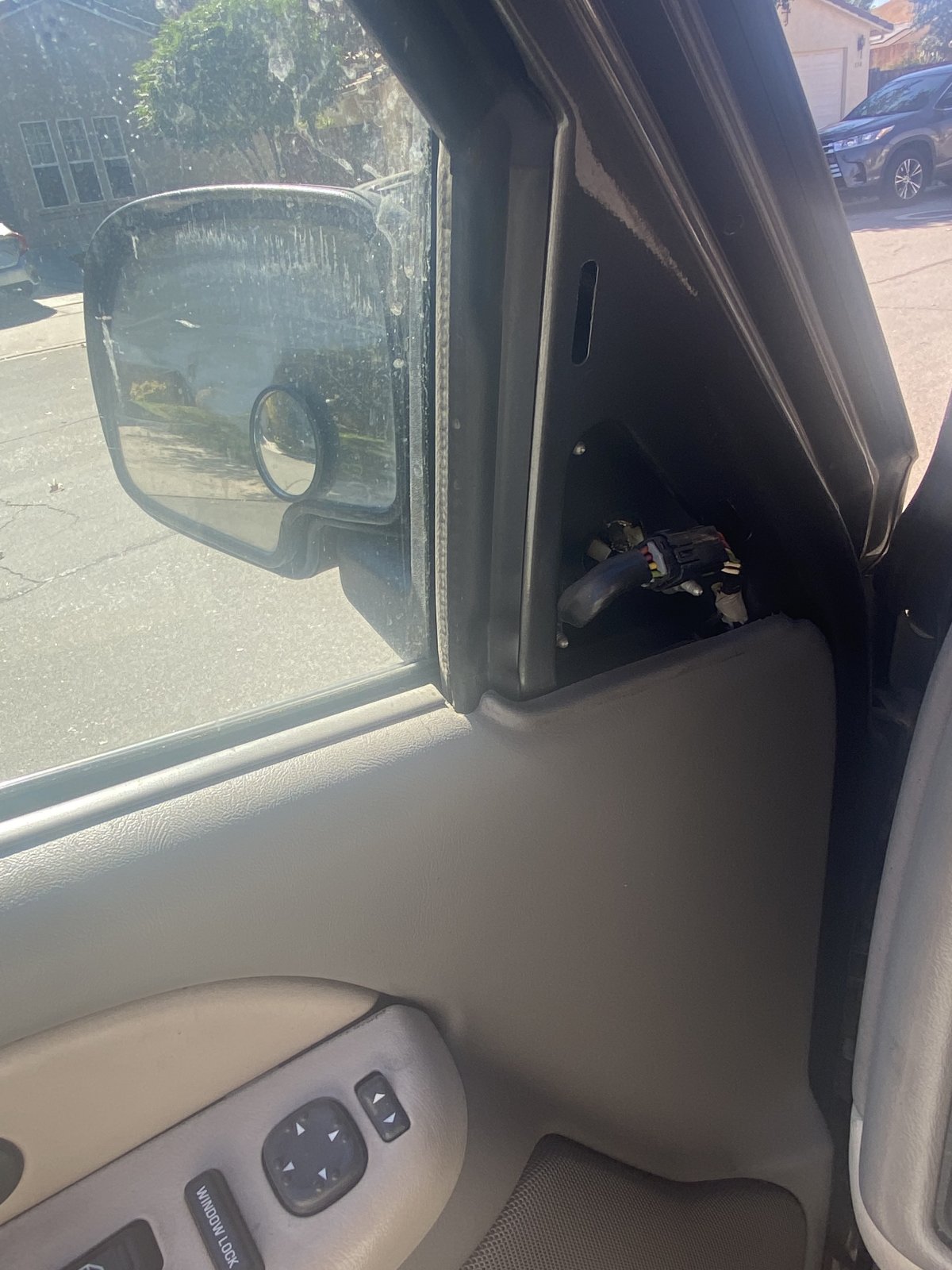

So I wanna order these today because my broken mirror is almost causing accidents I have factory power mirrors and heated but not turn signals , do I need to run a wire to the turn signals or am I missing something I don’t care about heated mirrors I just want turn signals I already have power mirrors minus a messed up door switch. I only have the one connector you see there if I need to run my own wires I might just order the turn signal glass.

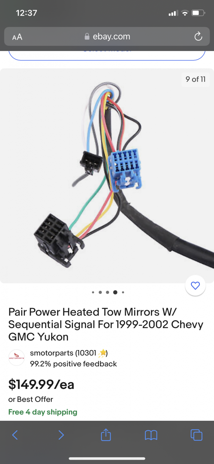

I figured out the wiring basically in short these will not work (easily) you have to merge those three plugs together if you want I can make a wiring diagram but basically these won’t just plug in because of the way they did the heated mirrors+power+ blinker to get the blinker to work you have to either merge the positives on the blinker to the light
and dark blue BCM leftmost plug to have turn signals OR run 2 wires one from the left positive to the left mirror and rightblinker positive to the positive of the right mirror blinker and put the negative wires of the mirrorblinkers to any bare metal piece if you want these to work it’ll be a lot of work they will not just plug in unless you have factory blinker mirrors+ heated + power.

The colors pretty much match up to the factory harness so if you cut the plug off the old mirror and follow the chart on the product images you can plug it in like it’s a factory harness minus the blinker which you can use 2 deans connectors for (professionally)

blinker function can be added by just running a wire to each mirror from the bcm, the other end of the blinker wire just gets grounded. it's the blue wire coming off the bcm info is on the internet.
Yes I just didn’t wanna mess with the BCM harness because if i mess up the BCM harness it’s a automatic mechanics trip the way I did it the worst that could happen is a blown fuse from crossed wires. this required just sticking a wire into the socket for the LED bulb and hood pin ground I only messed up stuff when I tried to do it the professional way it’s fully functional circa today my BCM already has one ghetto wire repair I believe, so I don’t wanna add more splices and make my truck more vulnerable to hit a bump and broken I have to zip tie the wire to the blinker housing and it shouldn’t come off unless I want it too.

on my 00 I just piggybacked off the blue wire and ran the ground, the hardest part was getting the wire thru the mirror neck all I had to buy was the mirror glass with the led in it. I then tried adding "auto dim" lol learned real fast that 12v to the dimming liquid inside the glass results in instantaneous failure, looked like a fried egg inside I think i had paid like $70 for the glass at the time it was very disappointing
