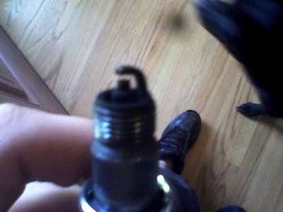

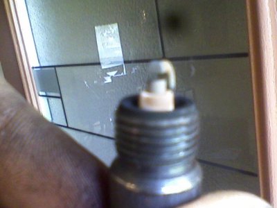

just pulled my drivers side plugs (they were the ones turning colors) and i took pictures of my number 3 and number 7 plugs. 1,3, and 5 were all scorched and dull like the picture and number seven looks how it does, although its ceramic was the darkest black, and there is a tiny little diagonal crack in the ceramic (much smaller than ones ive normally seen, kinda made up of a lot of smaller cracks making one larger one) so maybe thats why it looks different than the others?
number 3
number 7

yup those are the correct pics. i have an old flip phone. sorry if the quality sucks

If your valves were sticking open while the engine was running, the color of the plugs would be the least of your worries.

If scorched and cracked the temperatures are to high. Can't find a couple pics of own TBI but was thinking if each TBI barrel fed specific cylinders and not just all mixed together perhaps that can isolate a specific injector issue. Otherwise along with something else something might be goofed with ignition system. Maybe wrong plugs even.
