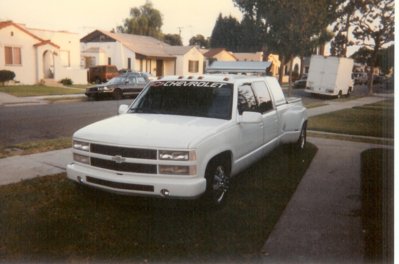

I bought my 2015 Yukon XL, SLE new in 2015. I got a great deal on it, and have never experienced so much as a hiccup with ANYTHING- It's only got 8000 miles on it (being retired is nice, by the way) and love it-
I had a 1993 Chevy C3500 Crew Cab dually that I drove for 20+ years. If I had the back windows down, without the front, I'd get the air pressure "buffering" I hear so many discuss, it was increased when I put a "1/4" shell and removed the back window. I found that if I cracked the front windows, or rolled up the back, the buffering stopped. Ambient pressure in a vehicle, should remain consistent with the atmosphere, when you start to "funnel" air, you can create "higher/lower" pressure zones, which may cause a "buffering" effect on your eardrums and other air spaces within your body- This is all pure speculation and there is no science to this at all, just sharing an opinion. It is also not my intent to "dispute" any other opinions on this, but offer the observations in that someone may find them useful... or just keep scrollin' on.
