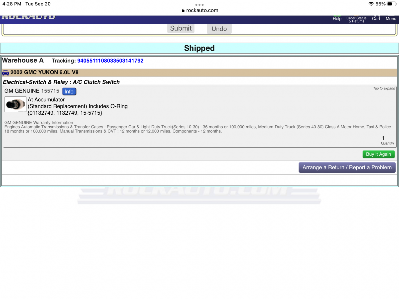

Here’s a pic of my part order for that on RA for my 02. It was called an AC clutch switch, listed under the category shown. I just replaced every component in my ac system. Look under the same category on RA and make sure it says “at accumulator “ or “ accumulator mounted”. The other one ( high pressure) is in the backside of the compressor.
