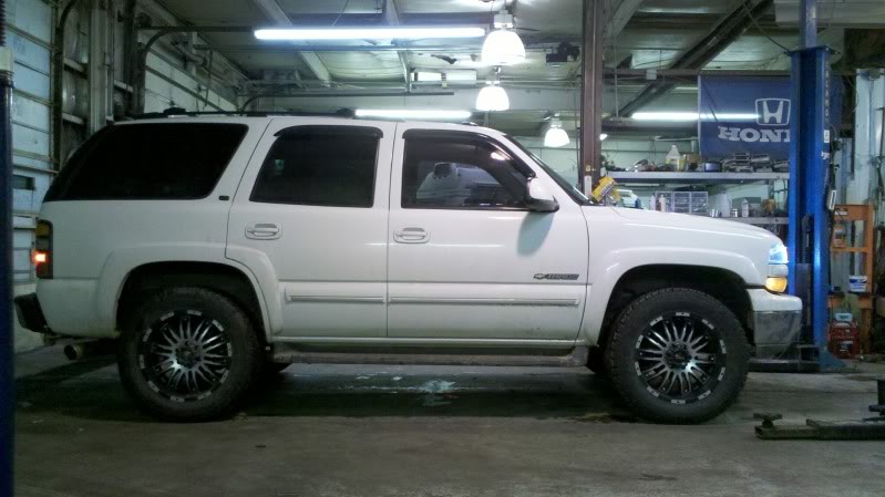

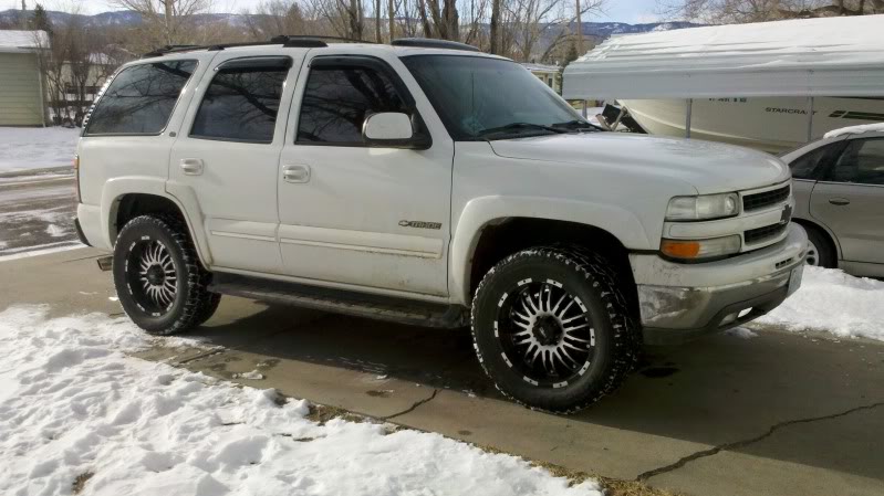

305/55-20 20x9 +0 offset. 02 LT with Autoride deleted and the rcx kit.

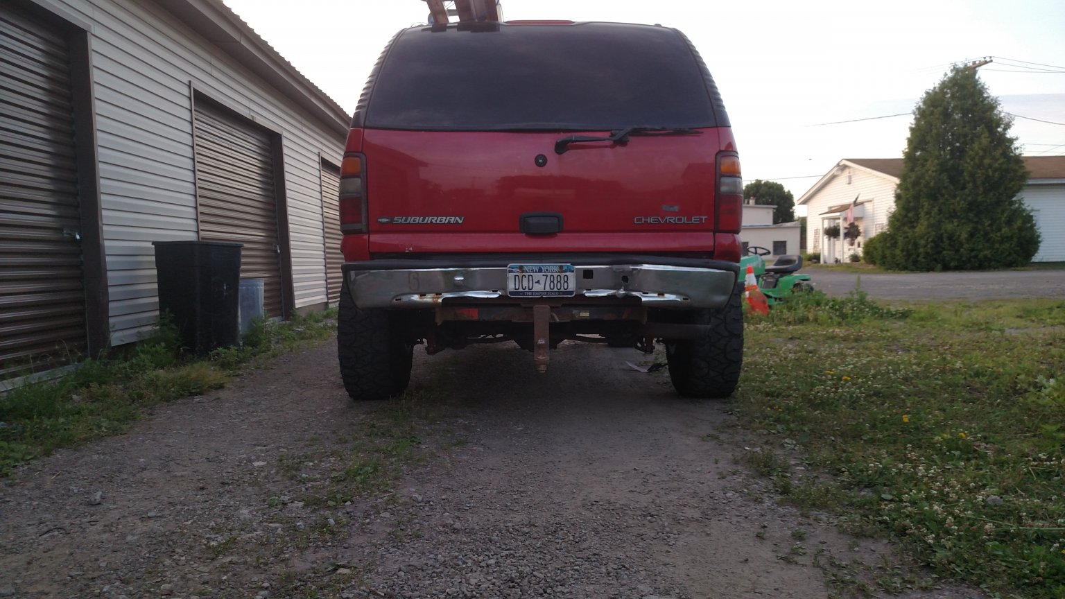

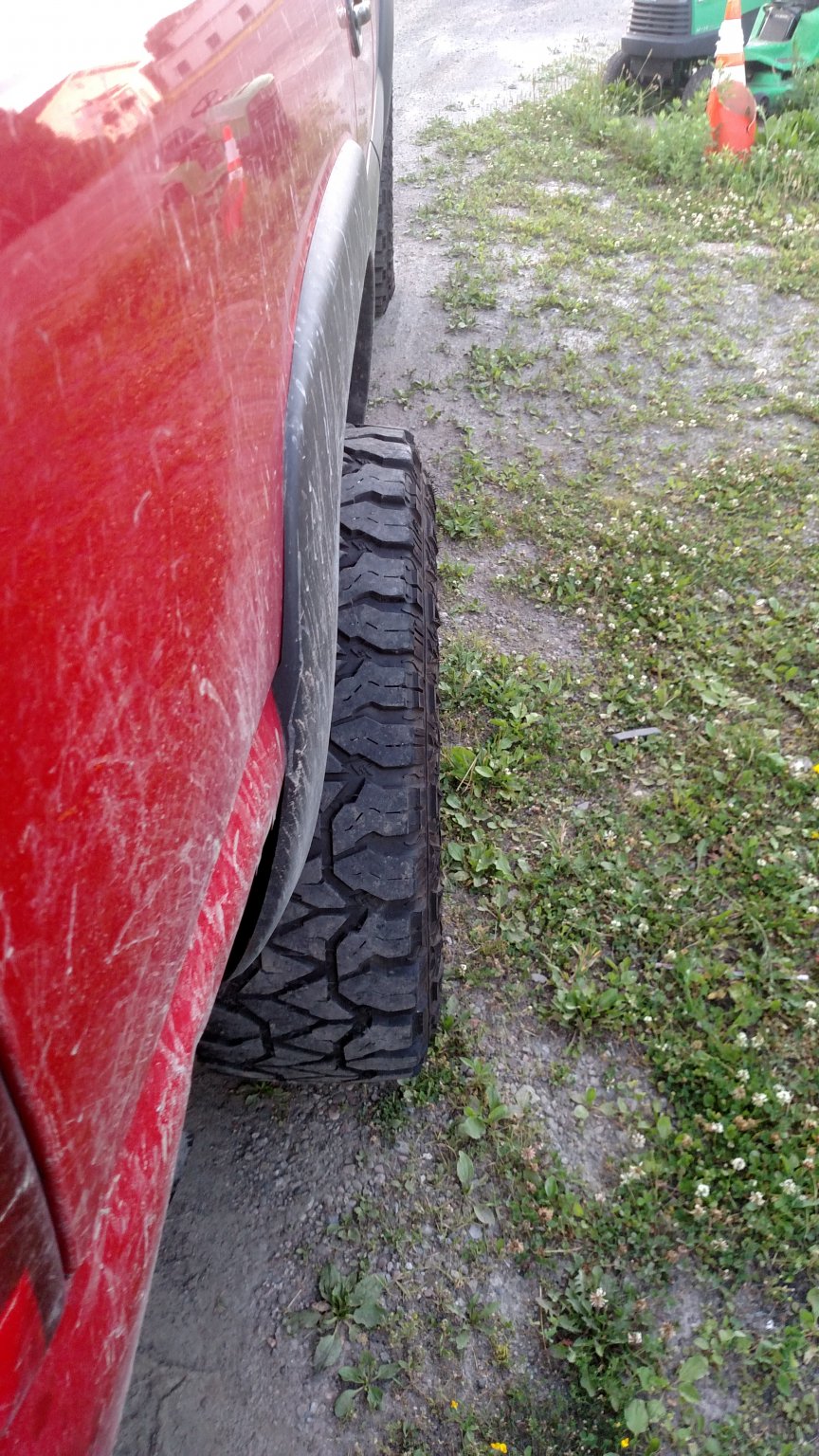

A little closer look of the Fierce's, sticking out over 2" past the flares.
Pretty much dead even with the flares in the front - I did have to trim back the plastic on the inner fenderwell. I also pinched the seams behind the plastic, and bent them over with a 3lb sledgehammer. also bent back part of the body mount on the driver's side, the cable for my E-brake was in the way, had to move it over a bit.

After driving enough to deplete one tank of gas... I covered 363 miles, on 28.5 gallons of gas. Just under 13mpg. I'd actually accept the roughly 1mpg penalty for having 35's vs having 33's.
Except....
Ride is a LOT rougher having these on. They are worn, previous owner had a ball ball joint, so they are choppy. Feels like I'm riding on a John Deere tractor at anything under 45mph. Once I get up over 45, they even out, and hum along. And by hum, I mean HUM. So loud that I have to roll my windows up to hear any calls over my Bluetooth radio.
And, even though I've cut back the plastic fender liners, they still rub when in reverse when even slightly turned.
Going back to the 285 Kelly Safari ATR's until they are worn out. Then, I've got a decision to make:
