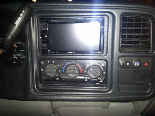

Here's the cut
Finished
Very worth the effort

I didn't move any of that, I just trimmed the top of the dash bezel and adjusted the stereo up
It could be trimmed more but I'll do that later

i used a dremel and used and trimmed my standard bezel rather than buying a 03+ bezel.
i used CA glue to glue the DD bezel to the dash bezel.
filled the gaps with Evercoat Maxim. sanded then painted..
i actually copied mine from another build... came out perfect.

I just did this using the bezel and radio cage from an 03-06. It wasn't too terrible. The metal bracket does not have to be cut, it really just depends on the radio you get. I used a Kenwood DDX470 and it fit fine. It was tight, but still fit.
