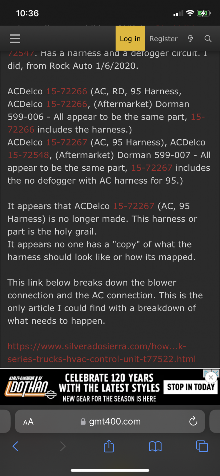

Here is part of a conversation on a different form that should help with your search.

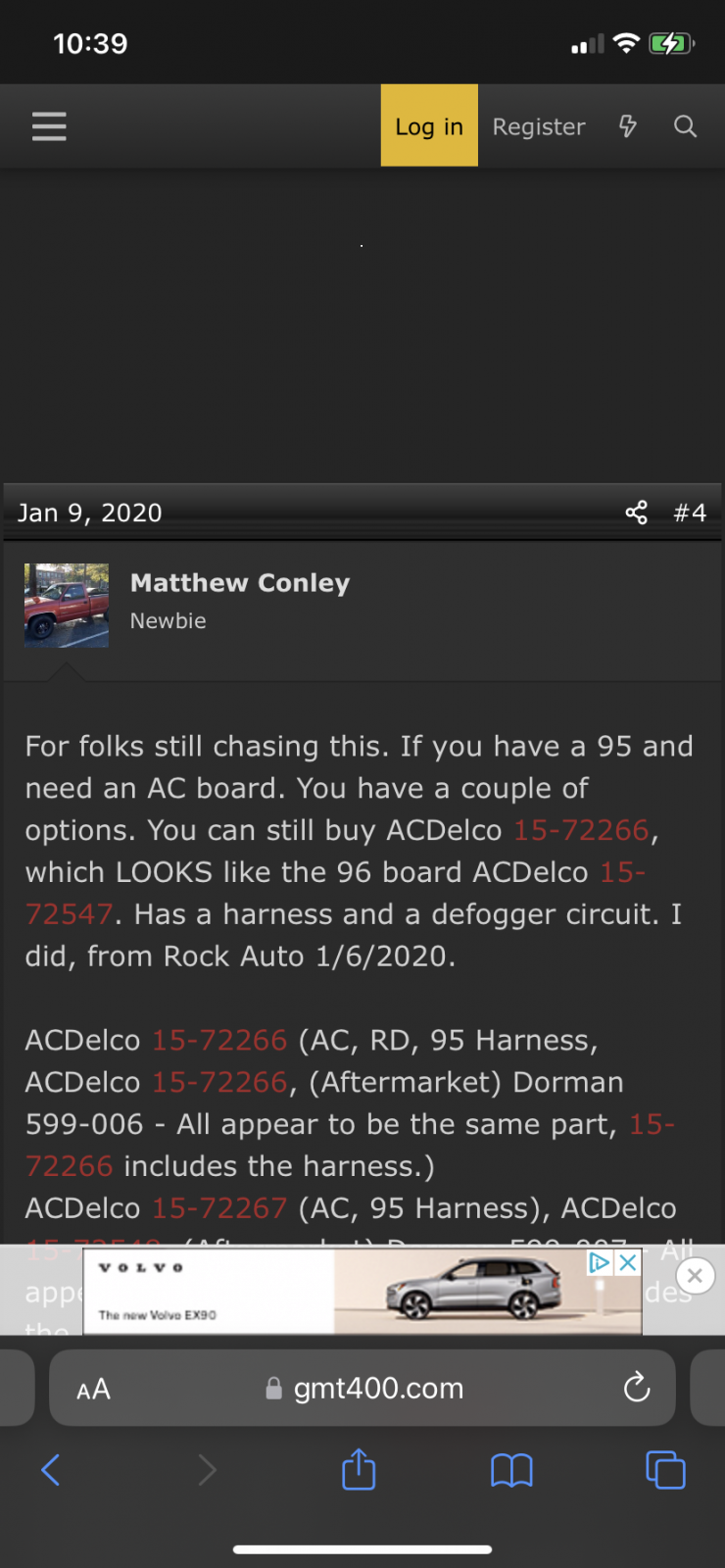

Here is the beginning of the conversation:
