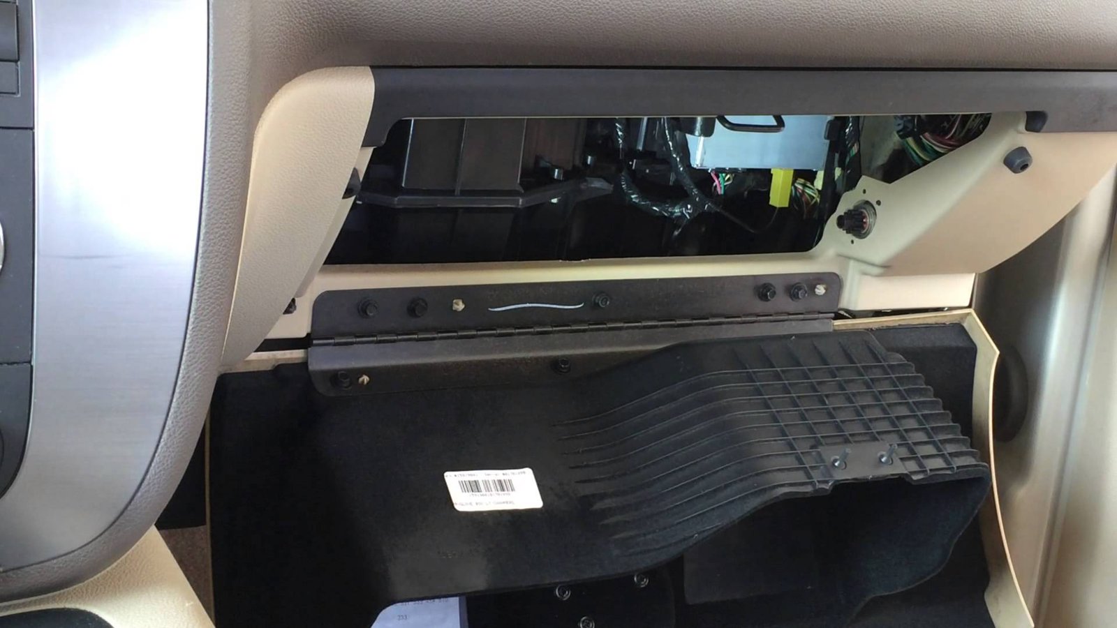

2.Disconnect XM module wires let it reset(Module locate under glove box. Try to pair your phone.

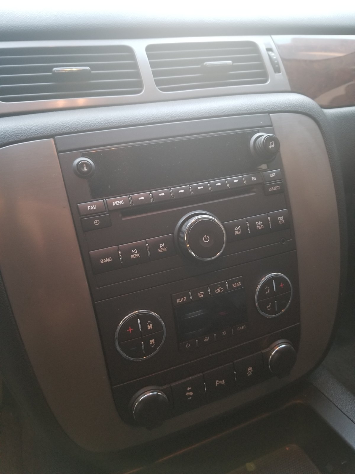

Haven't tried disconnecting but I'm now more confused at what I have. Here is a picture of my options and the radio. If I have decoded it correctly I should have a U2K unit. When I Google this unit, it doesn't look like what I have. The unit I have looks like most if the units that I saw in other similar Yukon SLTs that I looked at.
Unfortunately, there was no owner's manual in the vehicle when I purchased it.

edit:: actually I'm pretty sure your factory radio will not stream music from your phone thru usb or Bluetooth you have to use the AUX port and mini jack to mini jack cable, you can however use a ipod thru usb.
30,552
48,017
edit again after watching the video it may only be a apple thing I don't know, I couldn't get my 2012 to do it with a google pixel xl just phone calls
