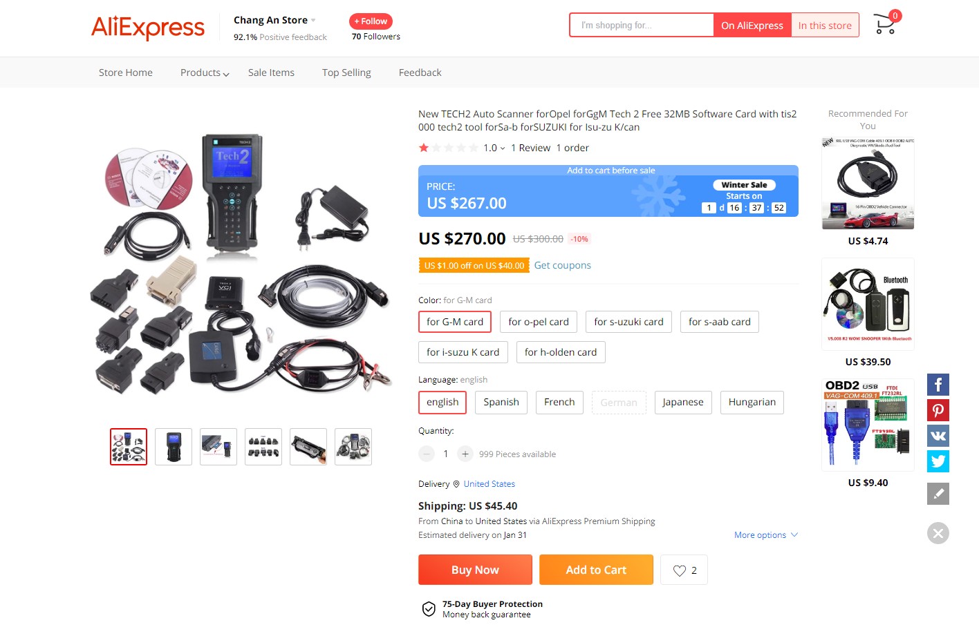

A Tech 2 can be purchased from AliExpress.com
https://www.aliexpress.com/item/100...;-1;USD+45.40@salePrice;USD;search-mainSearch

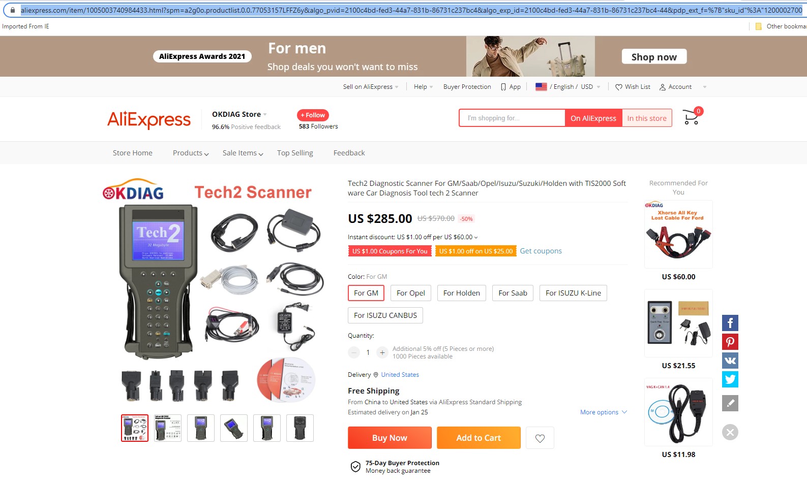

Or, this one with free shipping:
