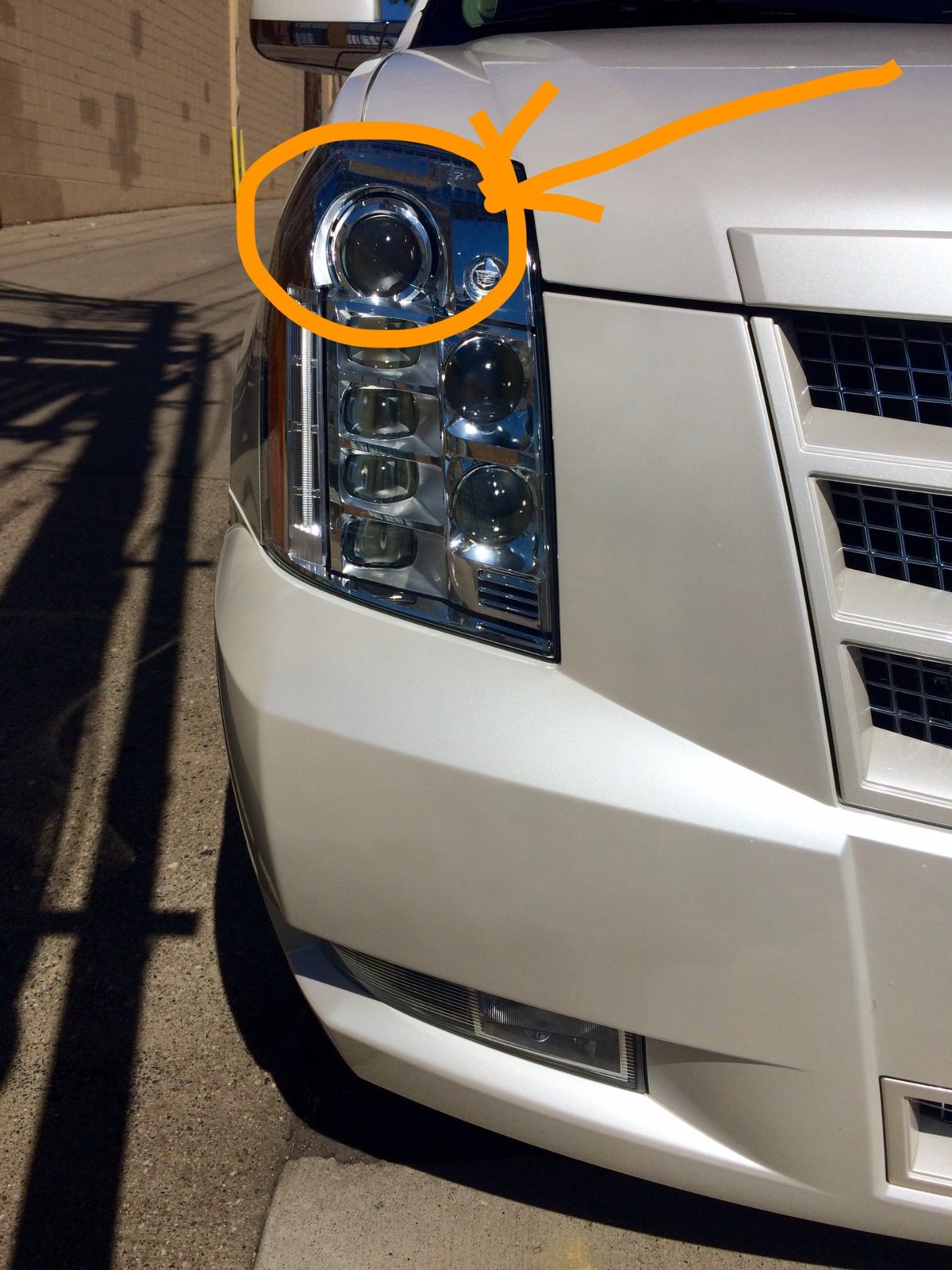

So the wife's 2012 Eski Premium has the upgraded headlights, which I believe are the Intellibeam lights ???
Well......the passenger side top light is out. From what I see and have come across this headlight is a completely sealed unit? So I'm guessing I'm screwed or is there any suggestions on how to fix this without breaking the bank, because I know what these cost !!

If you don't have warranty on it I would suggest to start with a replacement driver. I doubt they would sell one from a Cadillac dealer as they would want to sell you the whole thing which is costly. To confirm, is the passenger right side the one with the problem? The one in the picture you showed ?
No warranty.....it just went off two months ago!!!
Yes, it is the LED shown in the picture that is circled, is the one that is not working.

I would need to look for a broken headlight first but no more than $350 for my work including shipping to you. I'm certain the $19.99 fix will get it done just right. If it was the hid headlight( which they go out a lot) would be a $60 fix with a new ballast
Okay.......I'm beginning to breath again and the chest pains are subsiding.....ha ha. That started when I seen the 1600.00 price tag for a new light!!!! LOL I couldn't believe my eyes when I seen that!! Especially when warranty just ended roughly last month.
I'll let ya know when that module gets here and I rip into it, hopefully that does the trick.

I checked the Eski when she got home the other night and the light was working?????? I've been watching it the last few days and no issues. So.......either my wife was on crack ......or it was actually out and its back on and working fine.
I got the control module you suggested and gave me the link to, so I think I'll just wait and see what happens and go from there.

I think I know what could be the issue. Did it go through a car wash recently? Those headlights tend to open up by the corners over time. You might want to take them out and use the General Electric clear silicone II and apply it on every funny gap you see in there.

Ahhh very interesting with regard to the water! Don't really go through car washes but.......I did just wash it the day before with my pressure washer. I'll definitely look into sealing them up better!
I assume remove them completely to inspect thoroughly or is there a way to check these areas with leaving them in??
