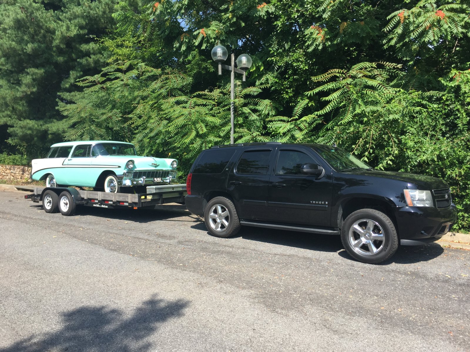

Heres a pic of my Tahoe on 33s with the MOOG springs and a whatever ACdelco shocks that rockauto said were Heavy duty (not really though). car and trailer are probably 5,000 plus a week's worth of luggage, golf clubs, tools, and a full cooler in the back. The 2" level really makes the front look high, but if you are stock stuff up front I bet the rear would sit about 3/4-1" higher than the factory springs unloaded.

That Moog spring #80169 is a universal heavy duty spring that do do fine and with the air springs, I would use Firestone, they combination would be great, IMO. May not even need the Bilstein shocks if you go that route.
Whatever way you go make sure you redo the alignment.
I'd bet you'd be surprised if you put that setup on the scales!
