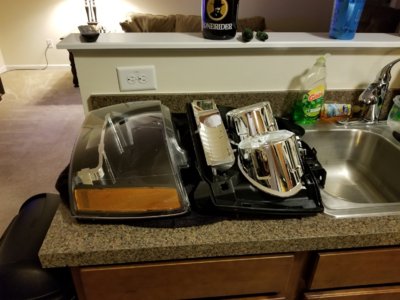

Thanks for the encouragement and replies guys. I had a couple beers to cool the nerves, and finally got the first one apart. I put this light in for 20 minutes, then gently pried around for 5 minutes.....then back in the oven for 5 minutes. Repeated until they were apart, which took 3-4 more rotations.

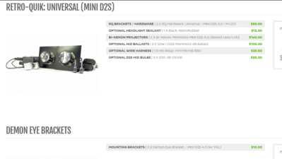

I've got D2S 4.0's sitting on the table ready to go. Except TheRetrofitSource shorted my Iris shrouds, hopefully they ship them priority to me....
Nice! They usually ship that method and only in Atlanta so shows up in 1-2 days. What bulbs and wattage you pick?
