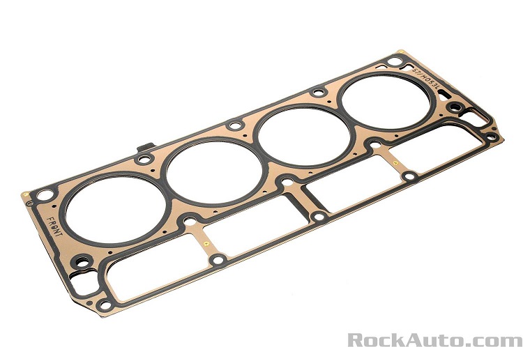

Any recommendations?
The Felpro advertises better sealing on rougher surfaces through some coating that covers the entire gasket,
vs OEM GM..
Apex and Elring brand look identical to OEM GM going by rockauto's pictures..
was leaning towards the felpro's, saw a couple negative reviews, something about edelbrock recommending against them.. now I'm leaning towards OEM.

Interesting that the LS9 gasket doesn't appear to have sealing beads...
