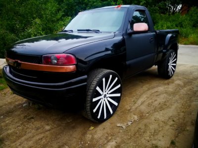

I pretty much just cut the grill where it mounts and welded back the brackets.
