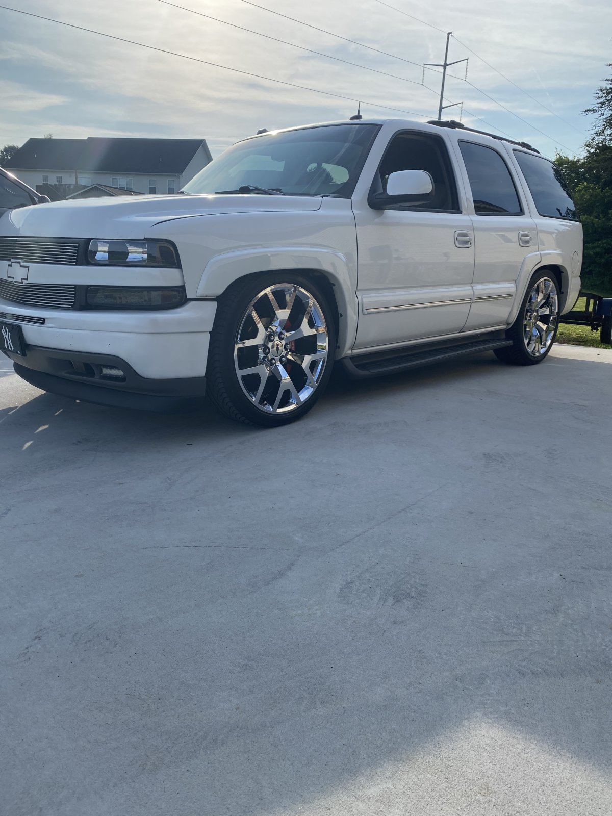

I have belltech 4230 for trailblazer on my Tahoe. Gave me about a 5 inch drop. I’ve also ran crown an mcgaughys. All have the small pig tail on end. I took them out about a month back an cut off 1 an half coil or a coil don’t remember. But it opened it up a lot where it don’t have the pig tail. Make sure u put the cut part up top. There is cups in the top that it will go in an help keep it in without falling. But I don’t think it would without it. I’ve not had any issues.

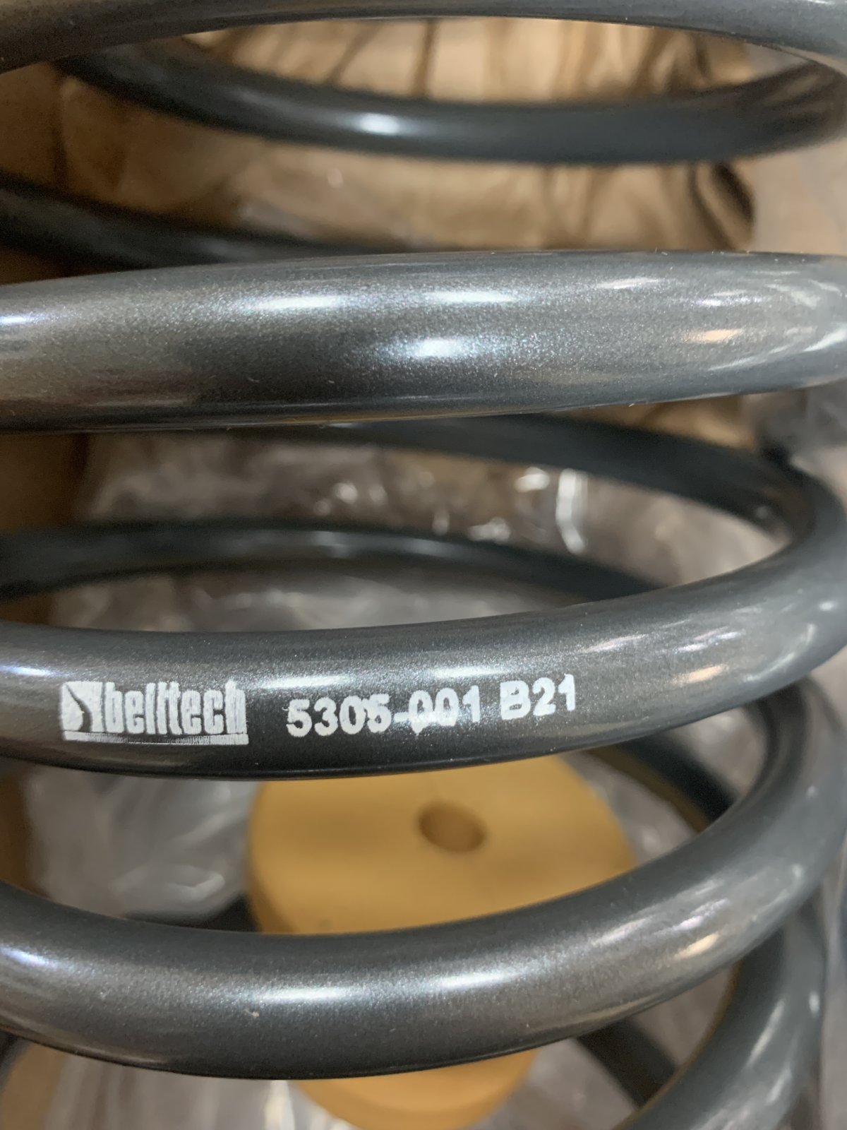

What’s up Brandon! Thanks bro I have the same Belltech springs and pulled them out and replaced with the Mcgaughy 5” Tahoe’s. Still not happy with the gap! Thanks for the info bro! I’m gonna cut my Belltech’s and install those then and see what’s what. Just needed to hear from somebody whos’s do everything this first hand before I made the plunge. If I’m not happy then I’ll go ahead and drop the cash and get the 5305’s and go from there.

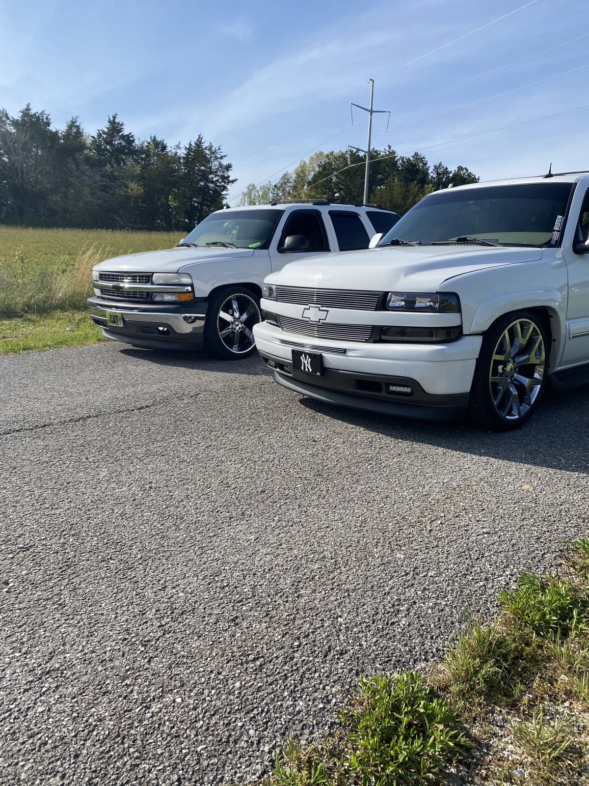

Glad I could help. An yes I’ve lowered so many of these an done all kinds of stuff lol. I cannot find the 5305s anymore btw. An I done both these tahoes. The one on right side is mine
