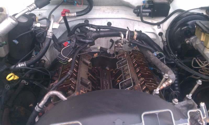

well started pulling stuff apart and came across my water leak..... here are some pics

im so glad i found this water leak before it caused catastrophic failure.. heres the underside of the heads. top of the pistons on respected valves look the same, but cylinders are still nice and clean and shiny.. i still gotta do a good inspection on the cylinder walls before i call them acceptable.. heads are gonna go to the shop to get pressure tested and milled...

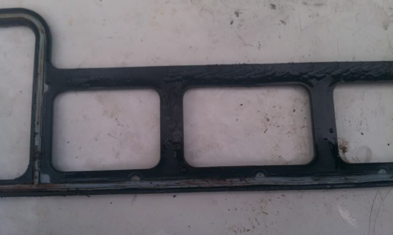

so i think gm designed intake manifold gaskets to fail from the start.. here is the old one on the left and the new felpro one on the right..
