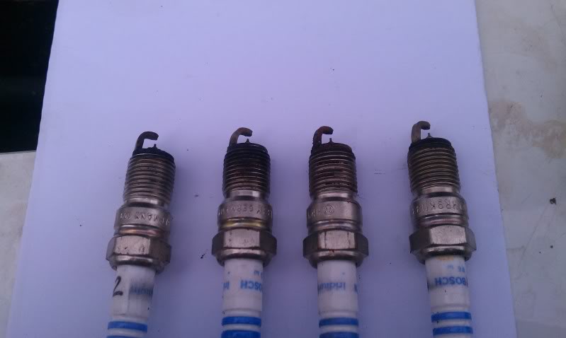

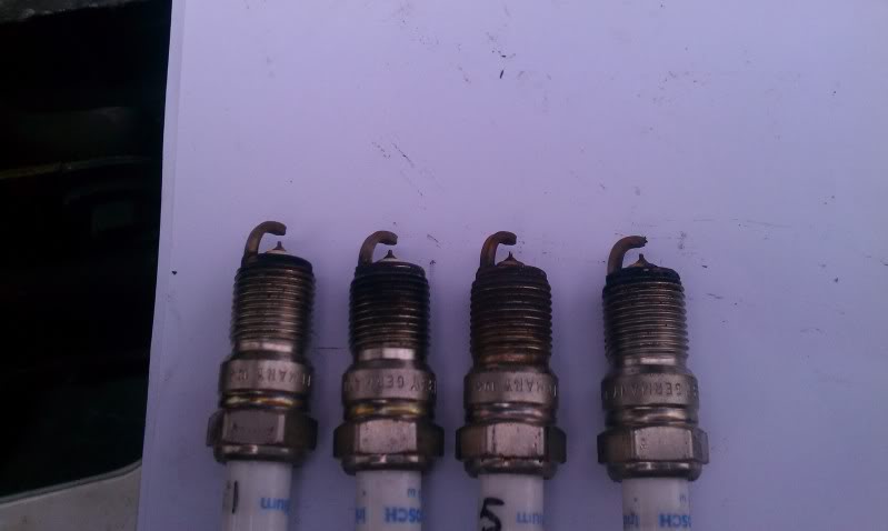

Ok so i got a compression test done this am.. Started the truck up this morning and let it run for about an hr.. pulled all the plugs.. heres what im looking at for values..

Now after letting it sit an hr or so(charging the battery), i went out to crank because it sounded weird while doing the test.. i noticed water coming out of plug hole 5.. When cranking i get a weird chattering sound, and it doesnt sound like the valves but since no plugs are in its probably what it was.. Any ways here are the plugs
1,3,5,7
2,4,6,8

I HOPE TO HELL YOU SCREWED UP THE TEST!!!
Do the test again if not sure.
If not your engine is hearby officially dead and need to be replaced. It sounds like it has done its bit for queen and country and with those pressures a little bit more. Sorry man.
