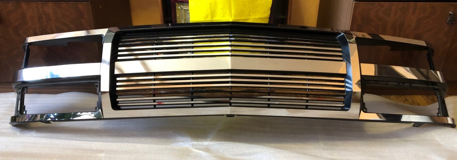

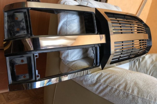

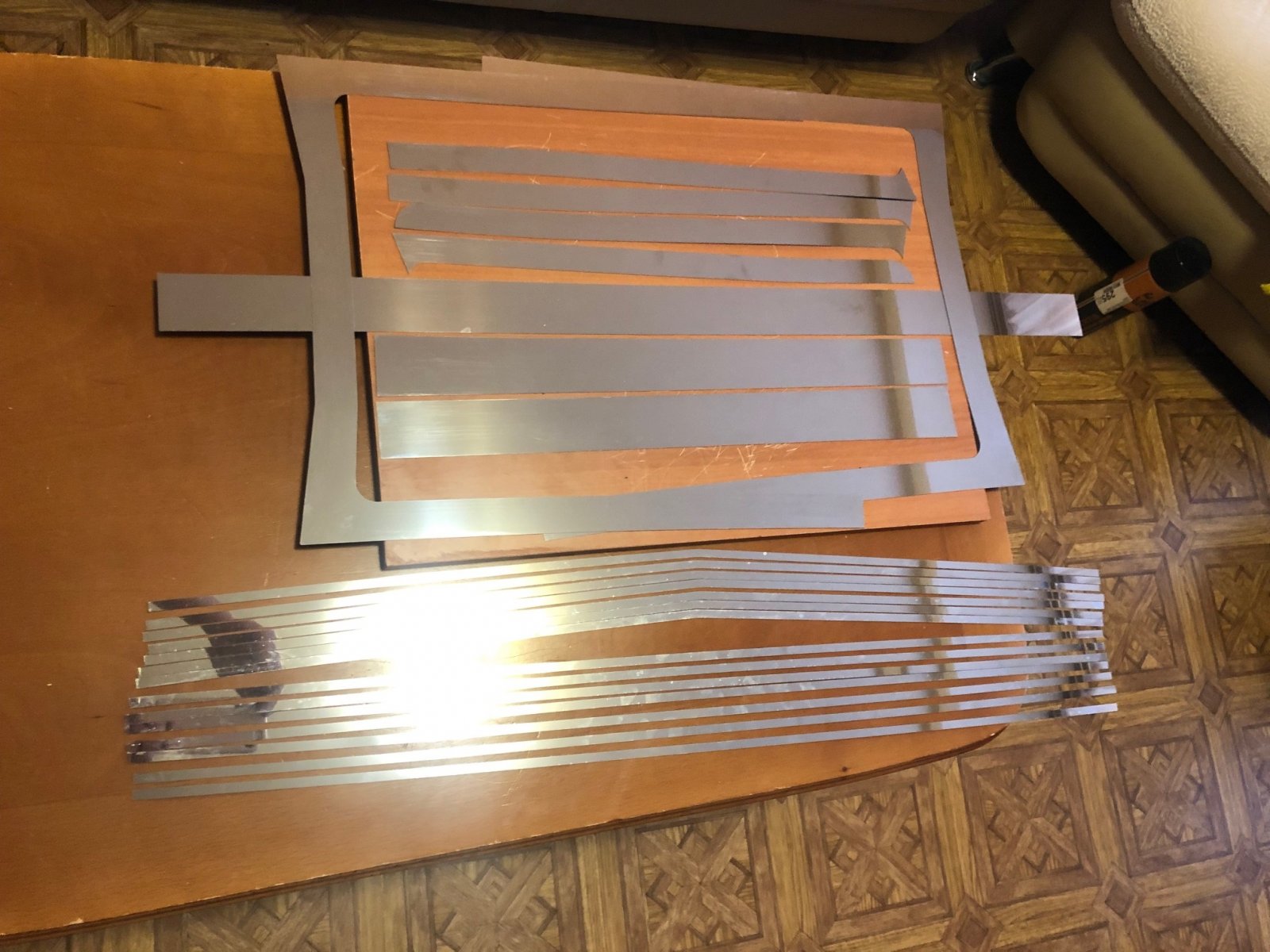

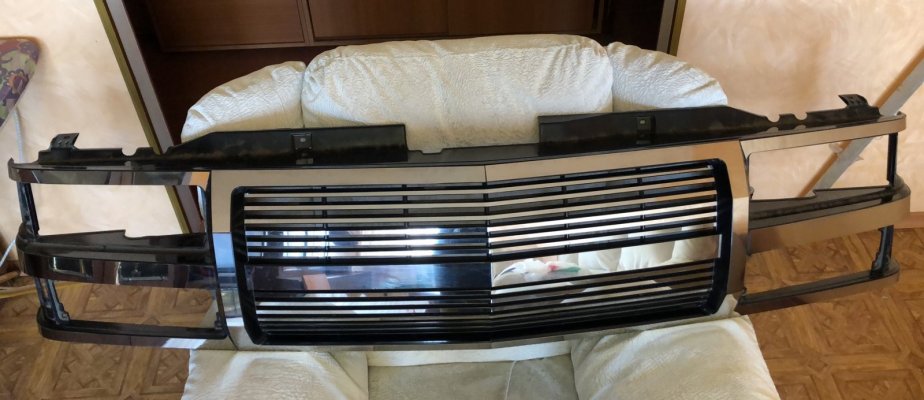

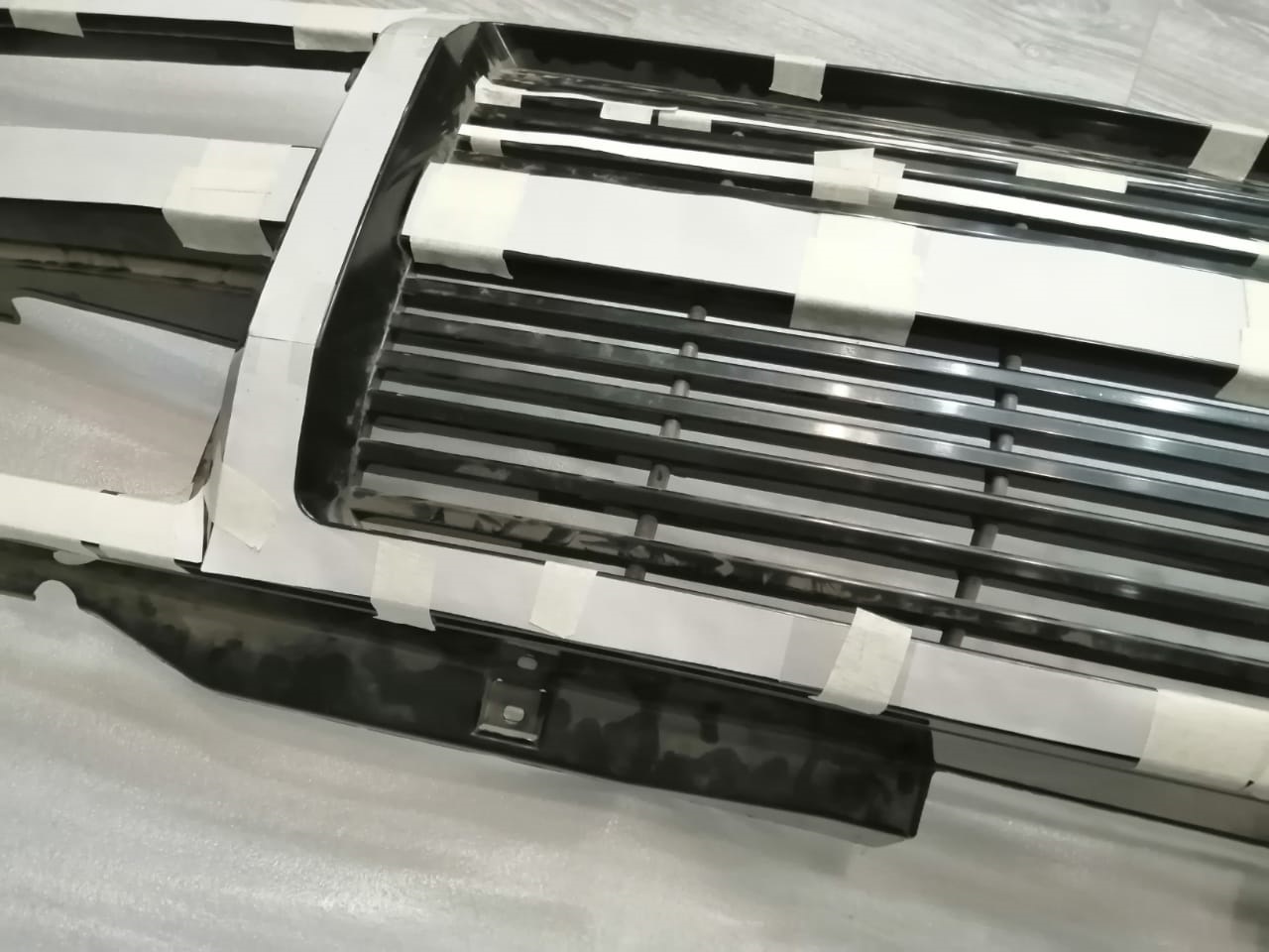

Hello!
Chrome slowly left the native grill)
Successfully acquired a fantastic grill in black plastic.
Luckily, because, as I know, it is no longer produced and sold in the homeland of GM)
I decided to lick all the frontal and linear surfaces of the grill with a mirror stainless steel.

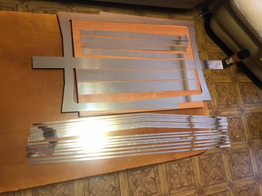

I purchased a sheet of mirror stainless steel 304 with a thickness of 0.5 mm

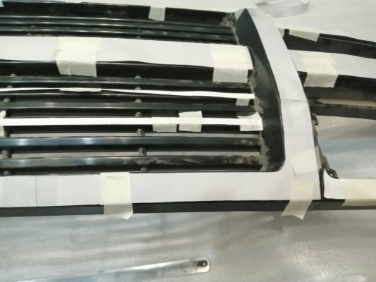

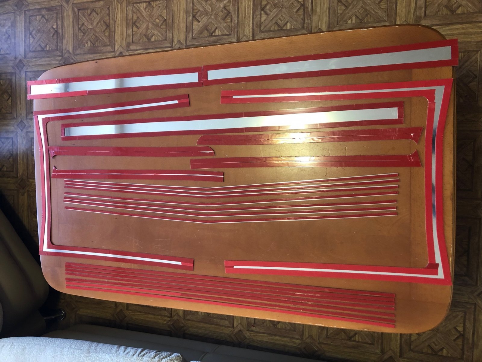

They measured it, transferred it to the program, cut it with a laser, bent it, rejected it ..... And so several times. So far, they didn’t get to the right size.
And the linear surfaces are not very linear.
The process and the result in the photo ....

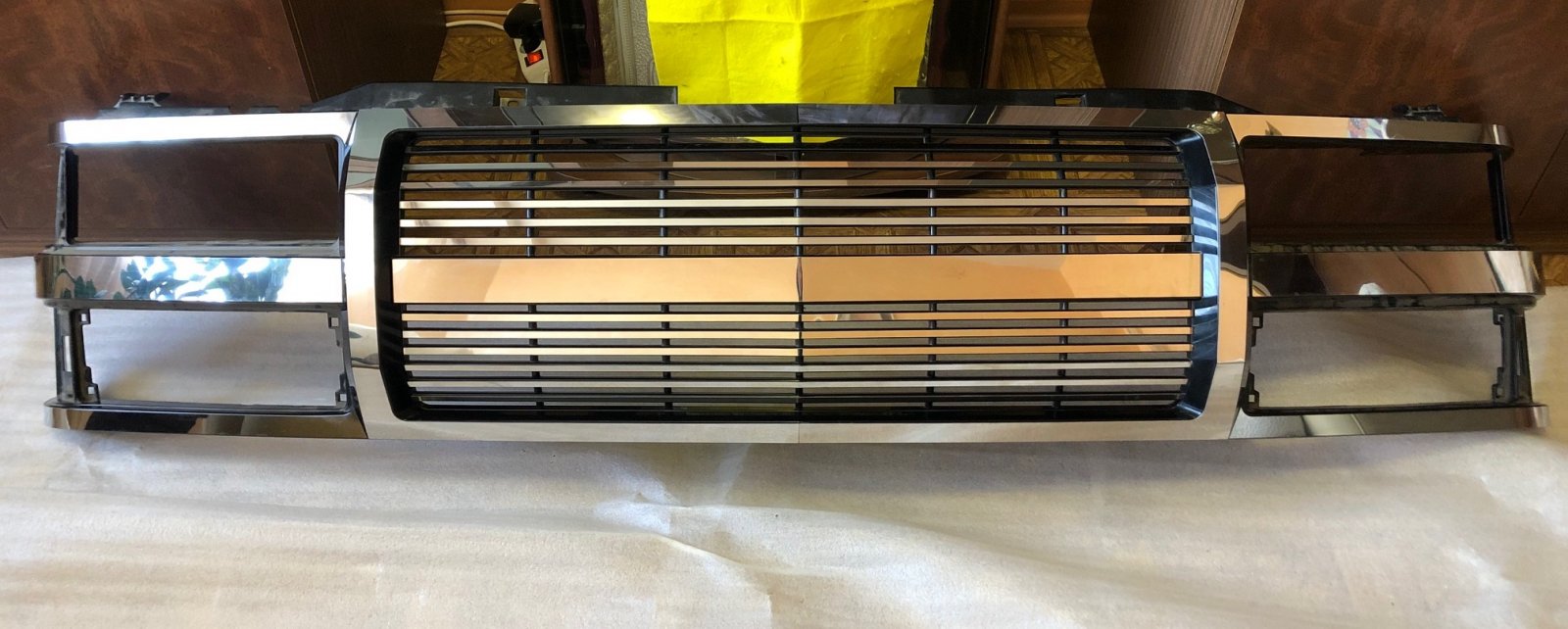

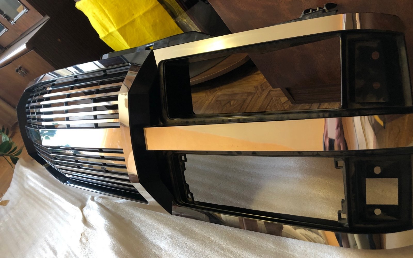

and....
