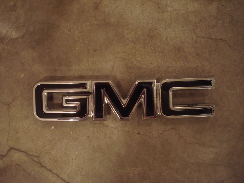

Got my front emblem painted today. It turned out pretty good. Still have to glue them back in before I can mount it to the truck but think its going to look good.

looks real good,
I taped mine all off when i did it
but ill probably end up taking it out then painting it...
how easy was it

I drilled some holes in the back (just till it hit the emblem) then heated it up with a blow dryer. Then pushed them out through the holes on the back. They came out pretty easy that way but still had to be careful not to break them. Saved me from scratching up the chrome though.
Used some Appliance paint on it so it would hold up better. Spend some time on a Harley forum and alot of guys use it paint there fork sliders and it holds up there so should do great on a small emblem.

Looks Great, I've been wrapping them to get the same effect. I like keepin the chrome too. Do you plan on painting any of your interior pieces?

Decided to do a little sanding and recoat so will be a few days...
