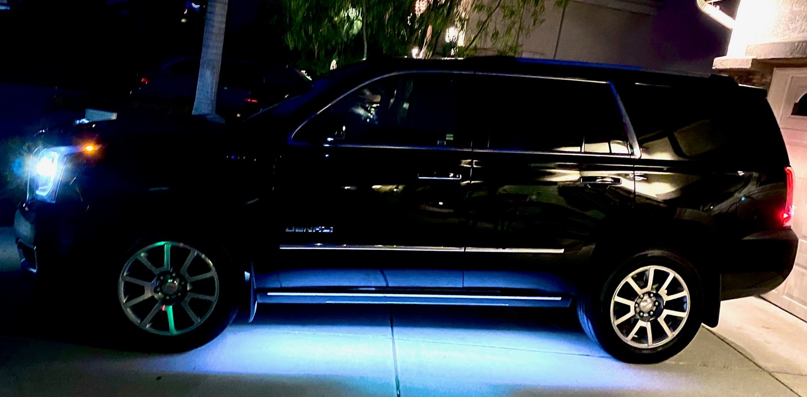

Oh the running board lights? So the stock Denali has a set of 3' lights that illuminate a small footprint underneath the running boards when they extend. The concept is good, but there is opportunity for improvement...so I did! I tapped the stock hot wire that provides power from the electrical system to the factory bulb, and soldered it to a waterproof LED strip that runs the full length of the running boards from front to back on both sides of the vehicle.
Now, anytime I use the fob to unlock the thing, or one of the doors is opened at night, the bottom of the running boards throw off a brilliant pool of white light along the entire side of the truck. It's all tied into the nighttime sensor in the dashboard so only activates when the outside light level is low.

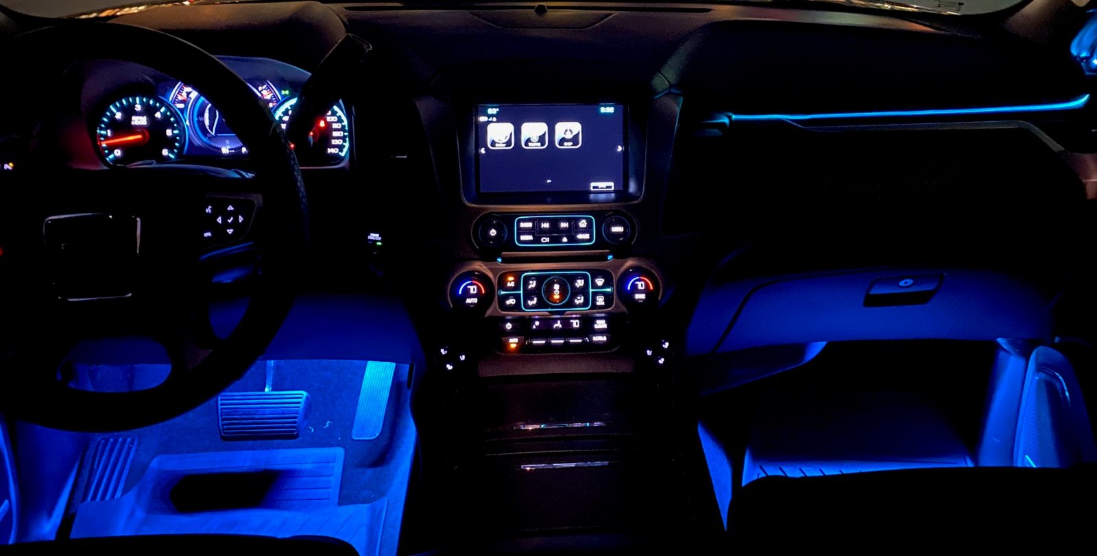

Here's the interior. I've got a pair of footwell lights in the front, a second pair in the middle row, ambiant lighting up the inside of the B pillars, under the third row and in the hidden rear (rifle?) storage bay. I've also added a fiber optic strip from XKChrome. I've seen some crazy add-ons with the fiber optic stuff...I wanted to add something tasteful and simple that didn't give it the "Tron" look.
Bear in mind, I cranked up the lighting to the maximum setting to take this photo, but in practice I keep it at a more subtle level.

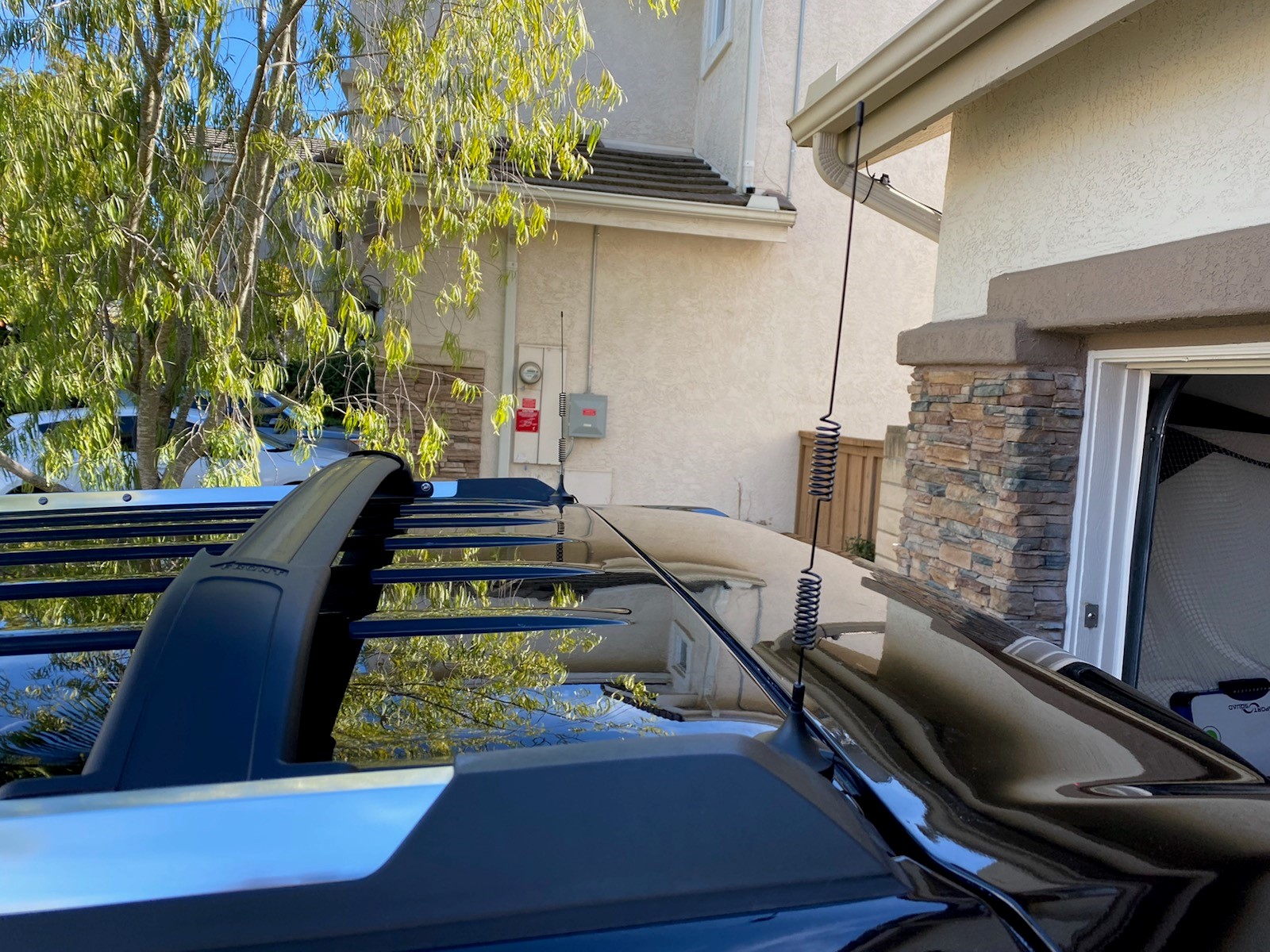

Hotspot antennas are installed...these make a big difference in reception on my Verizon system. If a work emergency comes up while I'm on the road, I'll be ready...

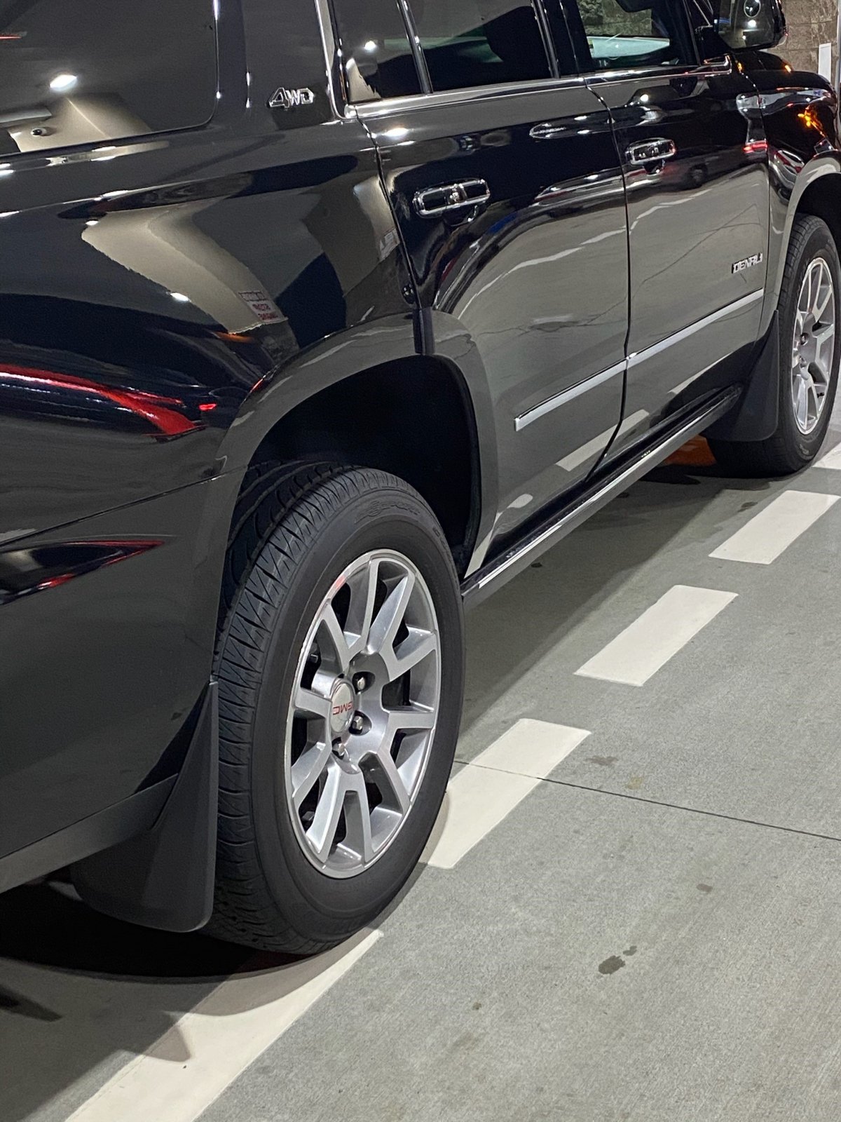

Husky mudguards installed. These work with the retracting running boards. I added adhesive felt sliders (from Home Depot) to the front end of each board to prevent scuffing from the running boards on the back of the forward guards.
