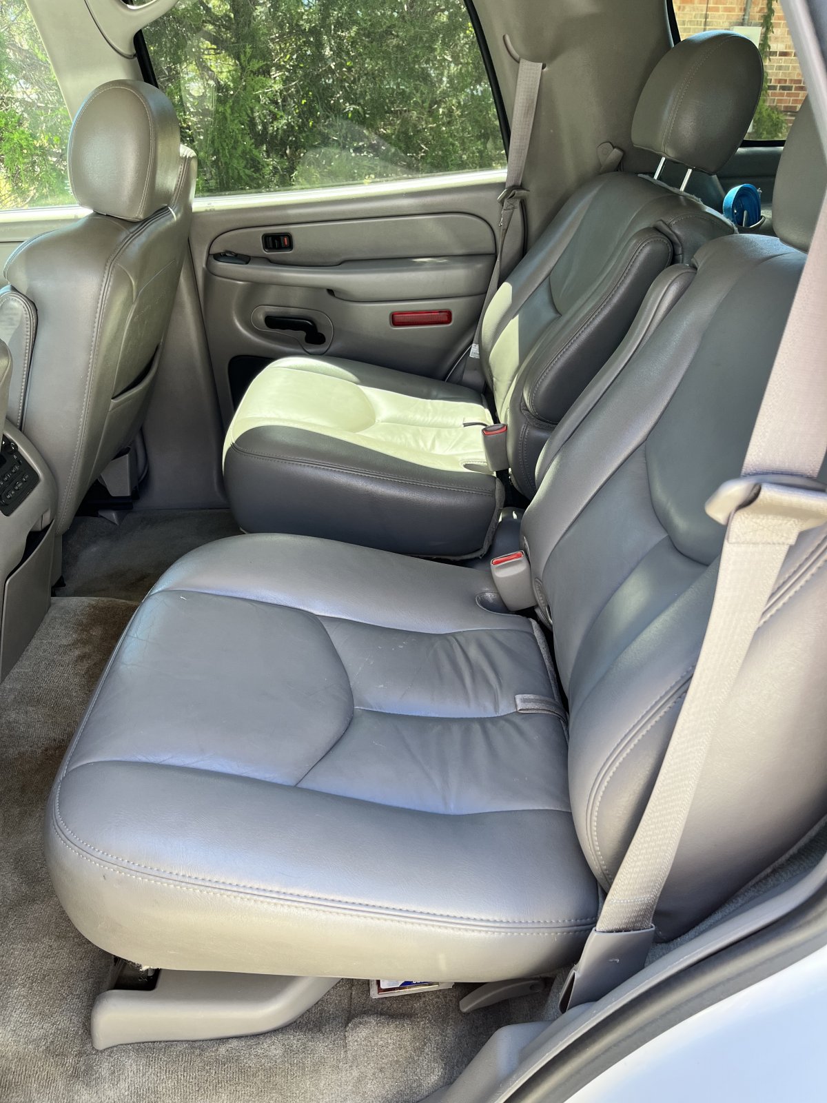

Kid is happy she can recline some now. I swapped my old headrest onto the right seat, since somebody drew all over it.

Looks good man! Those seats are in great shape too! Did you have to modify anything on the floor for the swap?
No modification at all, 8 nuts is all that secures them. Just make sure you get all the plastic snap on covers and the spring loaded seat back cover thing with the carpet on them. Super easy.
