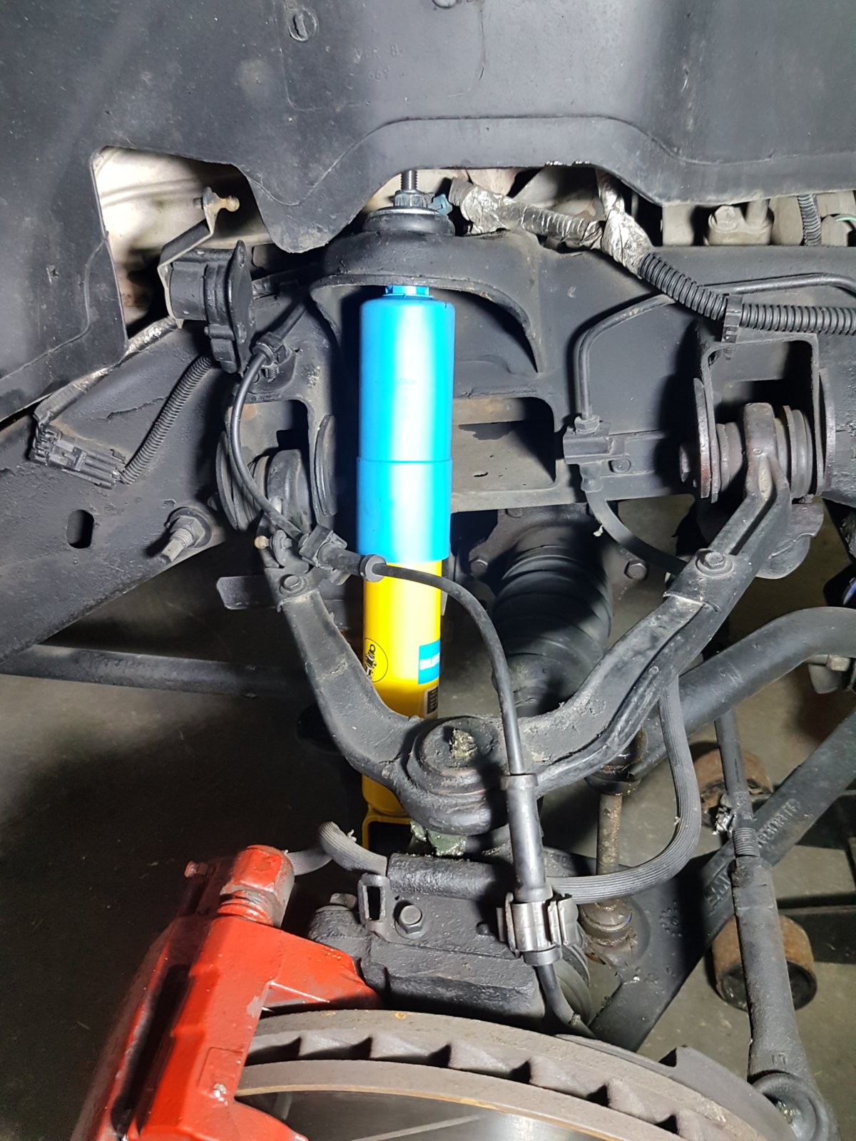

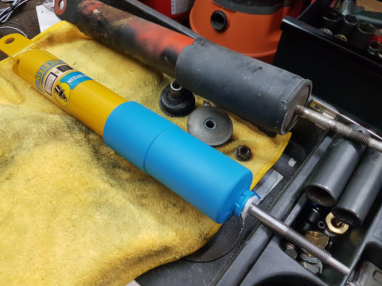

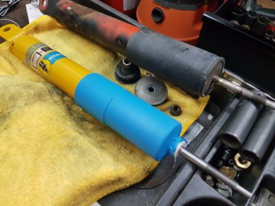

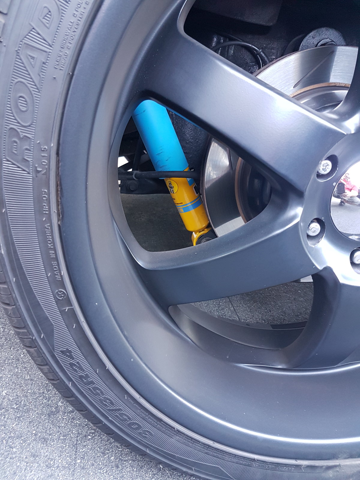

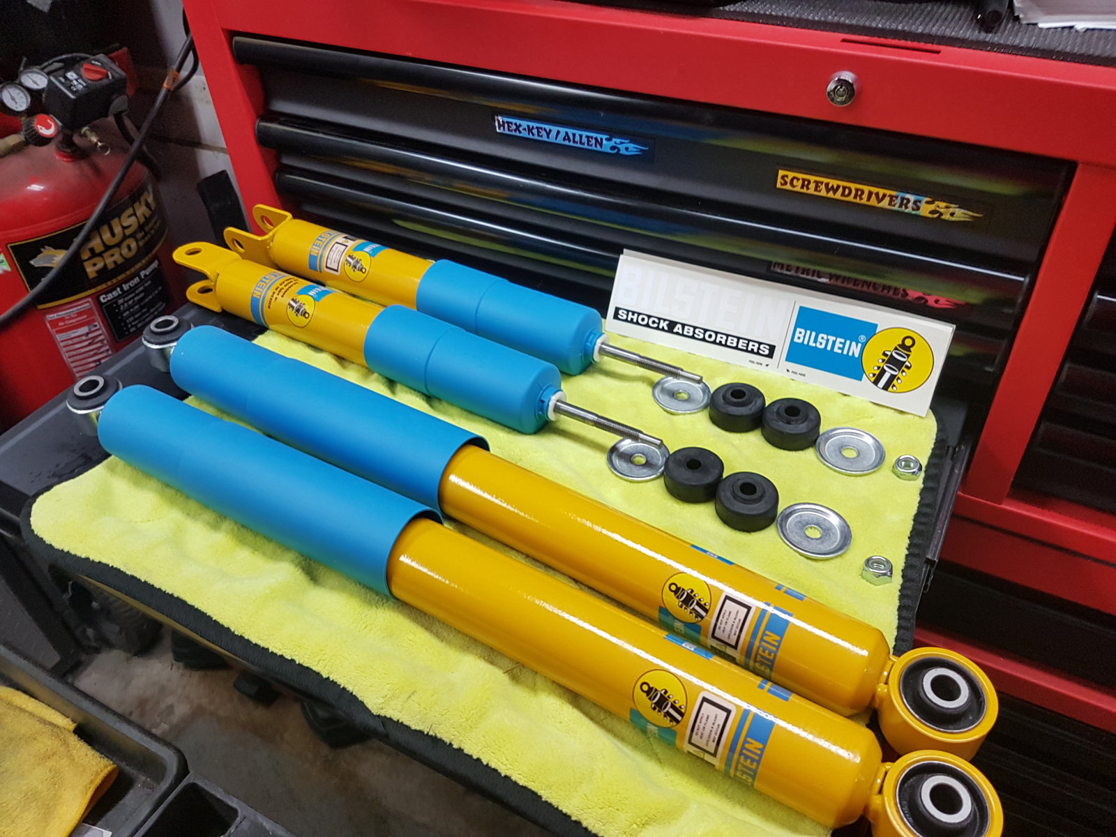

20180706_151403.jpg Just upgraded the shocks as well and pulled the fuse. Rides GREAT. No more pitch and roll on those dips in a corner. 20180706_182521.jpg 20180706_153635.jpg 20180706_155446.jpg
52,956
Shocks will bolt on but the springs might feel soft due to the autoride shocks doing some of the supporting of the rear. Most guys go with the Z71 springs to compensate.
