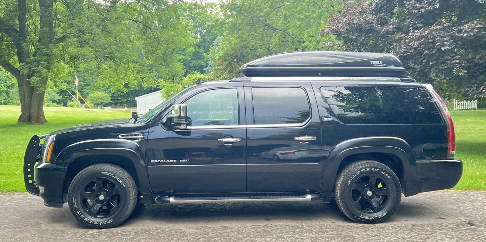

I went with 4600 and used some brand new cheap units off Rockauto to tear down and use as spare parts for the build. Turned out awesome. I do however have a new rear air compressor which works as it should so did not have to get the rear springs changed. They are easy to change if needed or you can use a spacer to compensate but to be honest the unloaded stock ride height does not change if the air system is disabled.
The ride is absolutely awesome soft and compliant and it slows down body movement greatly due to the monotube shock design. Worth it!
