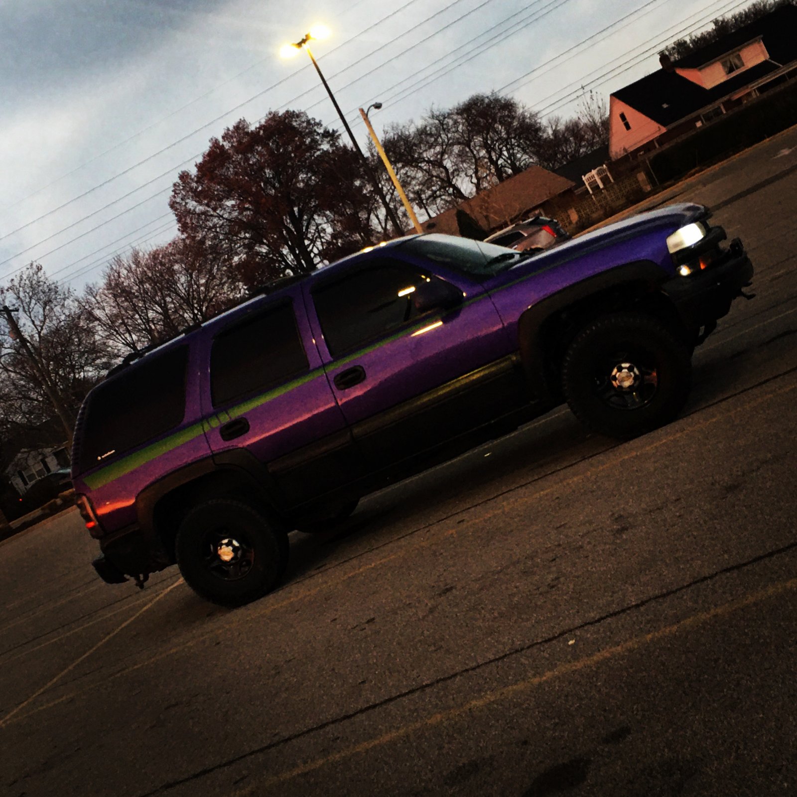

Picked up a set of 20” rims last night. 6x5.5. Going to be cleaning them up, and doing my own one-off design on them this winter.
I’ve been Looking for a set of tires, but I’m not sure which will fit under my 03 ‘Hoe running stock suspension. As of now, I’ve got a spare set, about 8/33 tread. They are 275/60/20’s. Thought about mounting one, and checking fitment, but figured I’d ask before I go ahead.

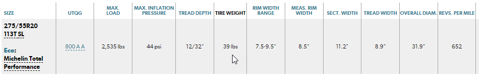

How about some more information on the rims? What are they? Stock size on 20"s would be 275/55-20, specs below:
Compared to your 275/60-20
EDITED: Corrected factory Tire Size.

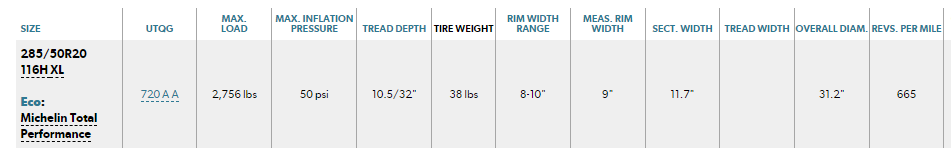

Yes, as stated above, rim width and offset for these rims need to be identified. For my stock 20" rims, the rim width is 8.5" and the offset is 31mm. With this stock rim, I run 305/50x20 Michelin Defender LTX tires with no rubbing on a stock height suspension.

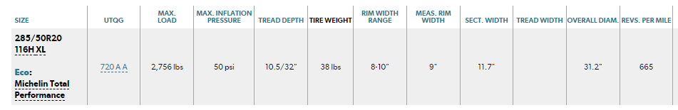

How about some more information on the rims? What are they? Stock size on 20"s would be 285/55-20, specs below:
This is incorrect for a 2003, GM mounted 275/55/R20 tires on 20 inch wheels on the gmt800 as well as the gmt900 rigs. I ran a 275/60 tire on my stock suspension 2006 and I had zero issues. I’m not sure what the offset on any of the wheels I was running previously were. But I didn’t have rubbing issues until I went with a 275/65 series tire and that’s even on a front level kit to gain clearance. My drivers side tire runs the inner fender liner when turning right over snap bumps and dips. But I think part of my issue is that I’m running an LT275/65 series and not a P275/65.
