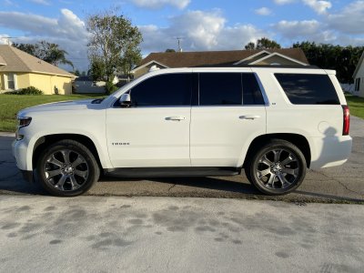

I have a 2019 Tahoe lt. 2wd the rear is lowered 2” with the maxtrac coils. I hate the rake the truck comes with. I have oem 22’s with a 305/45/22. The tire fills out the wheel well much better. Also provides a little more sidewall to protect the rims from women drivers lol. But there’s no rubbing at all unless your going in reverse with the wheel cut all the way and even at that it’s minimal. I have a Silverado also reverse leveled with the same tire size set up. No issues.
