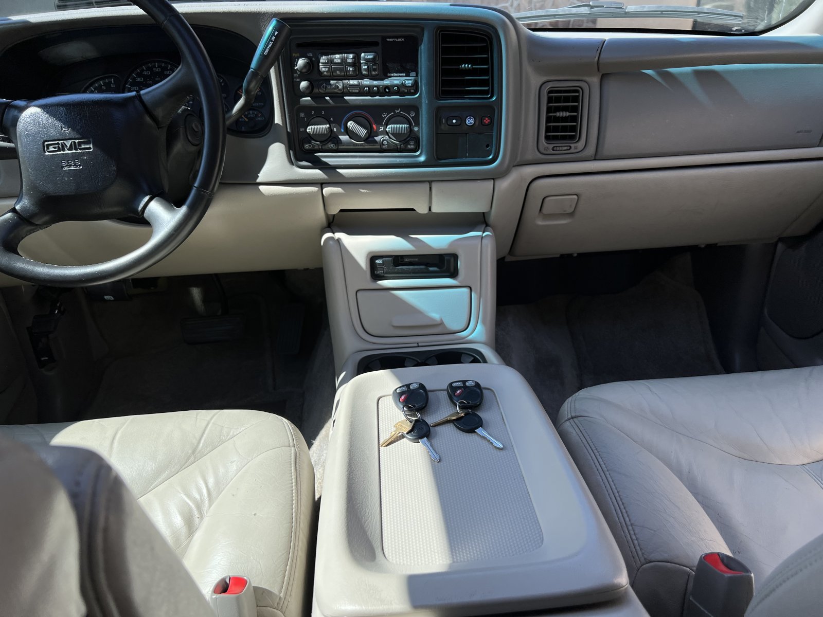

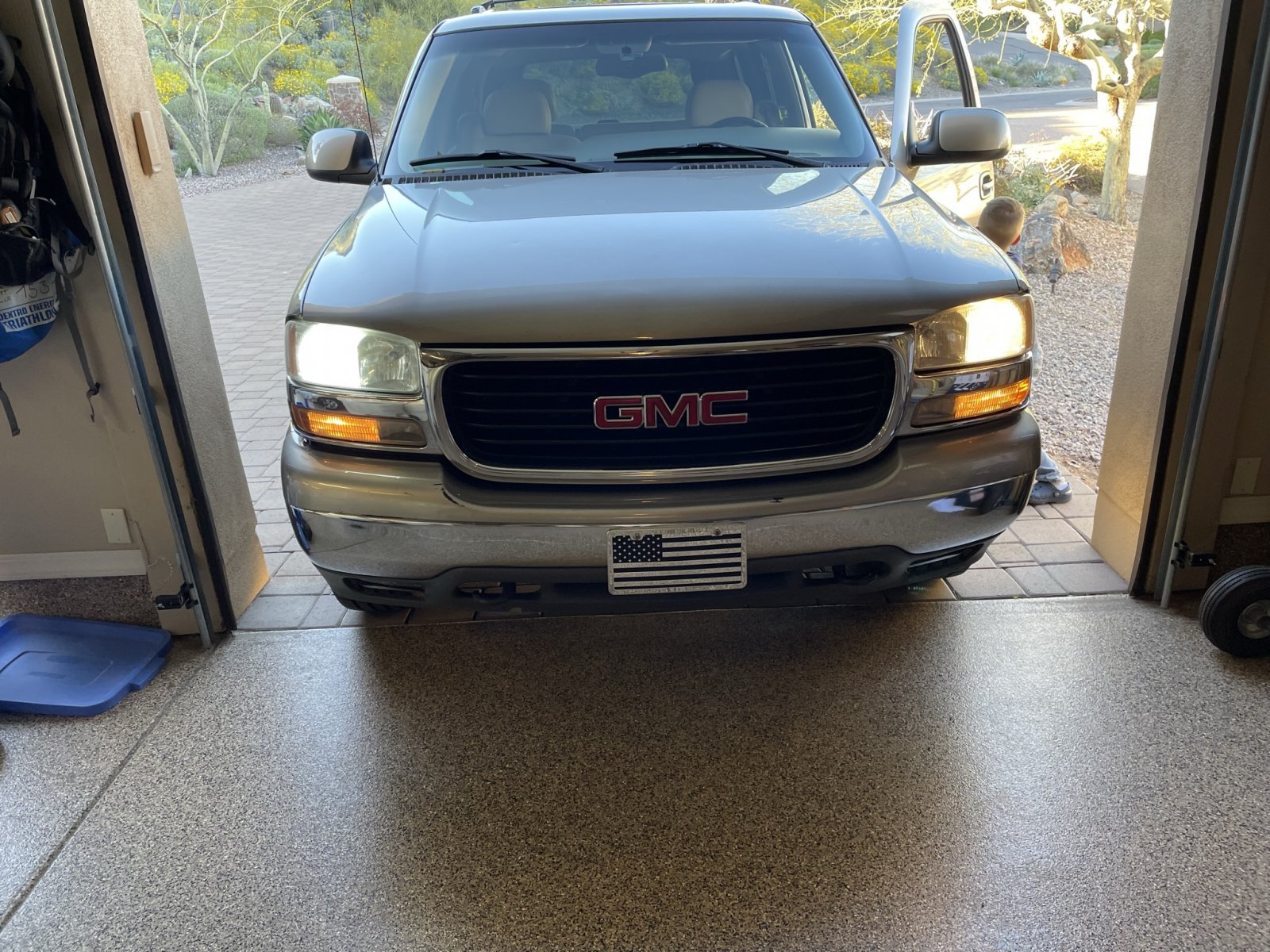

Hi from State48. I finished exterior and interior LED bulb swaps on my 2001 Yukon SLT 4WD. I also replaced the melted sockets for my Daytime Running Lights and when checking my work realized my low beams are always on. I’m pretty sure it’s the common problem of ambient light sensor on the dash has failed. I pulled the Audio Head Unit out and took a look and decided I can’t reach it that way. I’ve been in and around my dash and am patient enough for this but don’t want to crack the dash or lose the wire.
Does anyone have experience removing the dash top to access the sensor? Is this a good idea? Does anyone know which sensors I need (there are two different versions, 2-pin and 4 pin, I think)? Any help is appreciated.

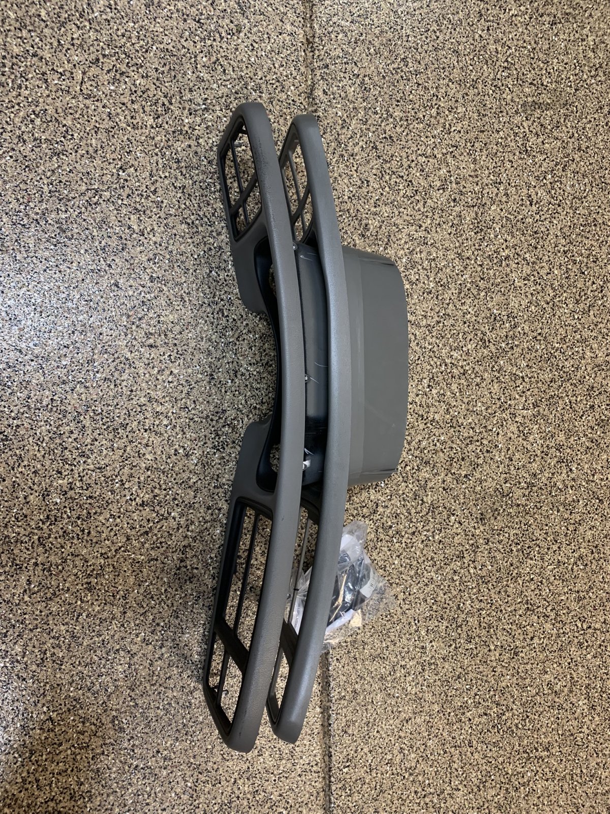

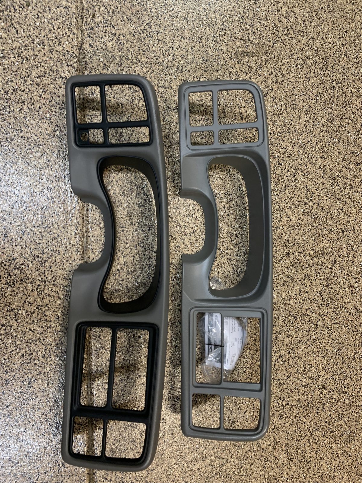

I would absolutely spraypaint it if anyone knows a good match color code for Pewter. I thought about painting black but not sure black would work on top. I think it would look good to paint the old dash top and the new monochrome Metra double-DIN dash front panel at same time. I’m sending back the pewter Metra front panel and swapping for black because not completely satisfied with the match.
