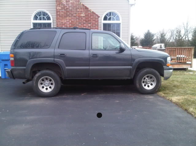

I just did a 2" leveling kit all around for under $100. Im still running 265s but we test fir 295s and i could clear them no problem. Im going 285s on my next set.
haha yes the running boards are "off". Im waitin to pull them any day now

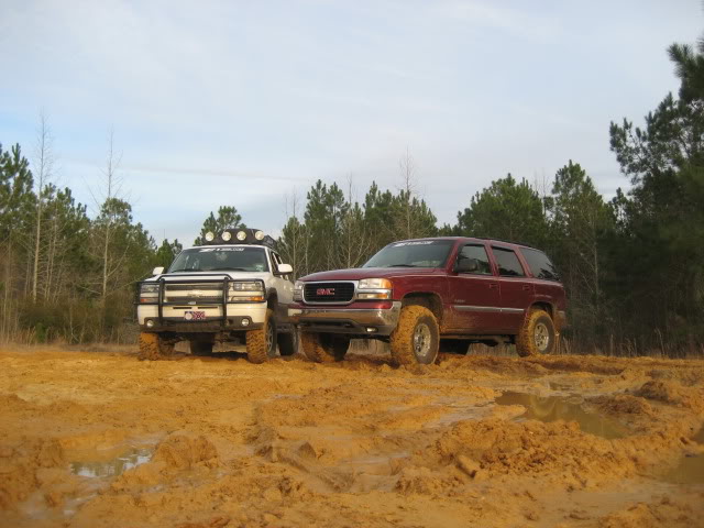

Thats what your truck would look like. Hes runnin ford keys and 3" ebay spacers on 33s. The white z71 has a 3" body lift on 35s.

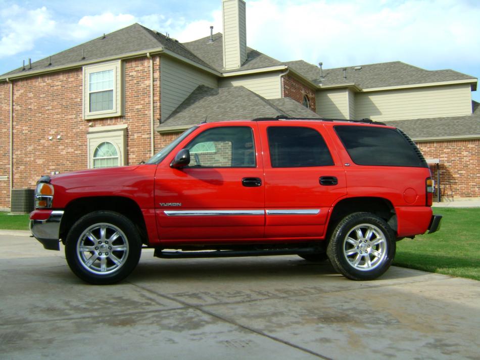

Got my Truxxx system installed and found some 20" BBS wheels on craigslist.
