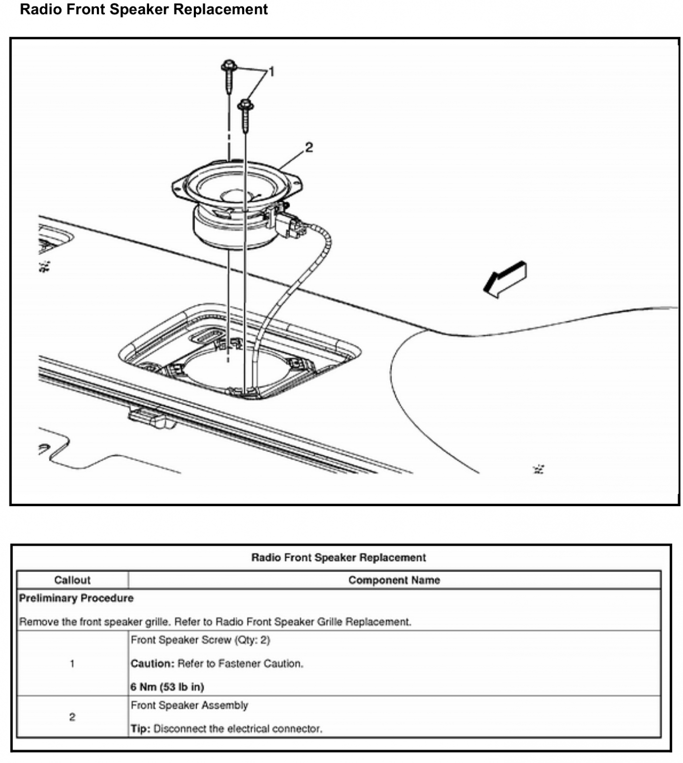

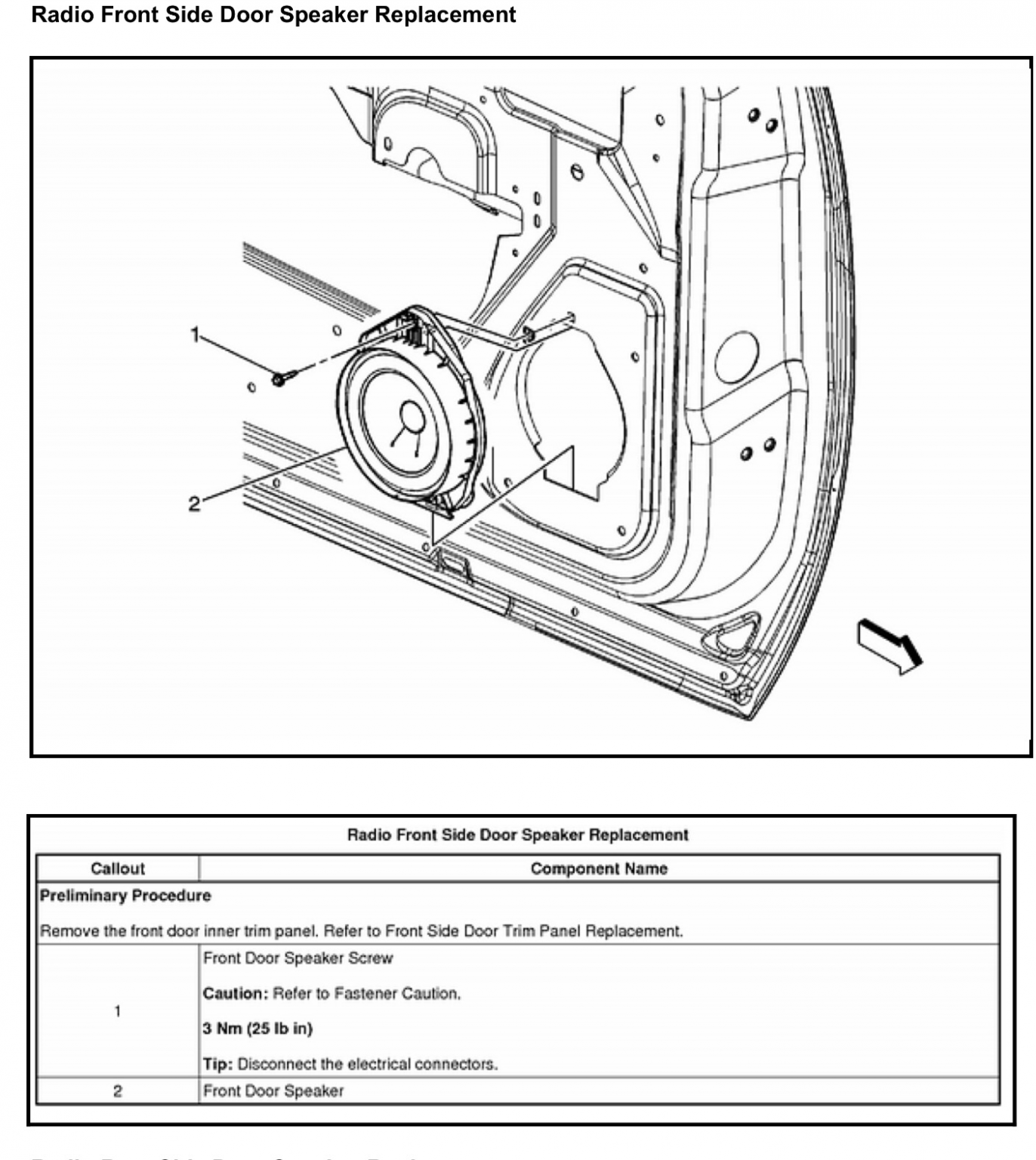

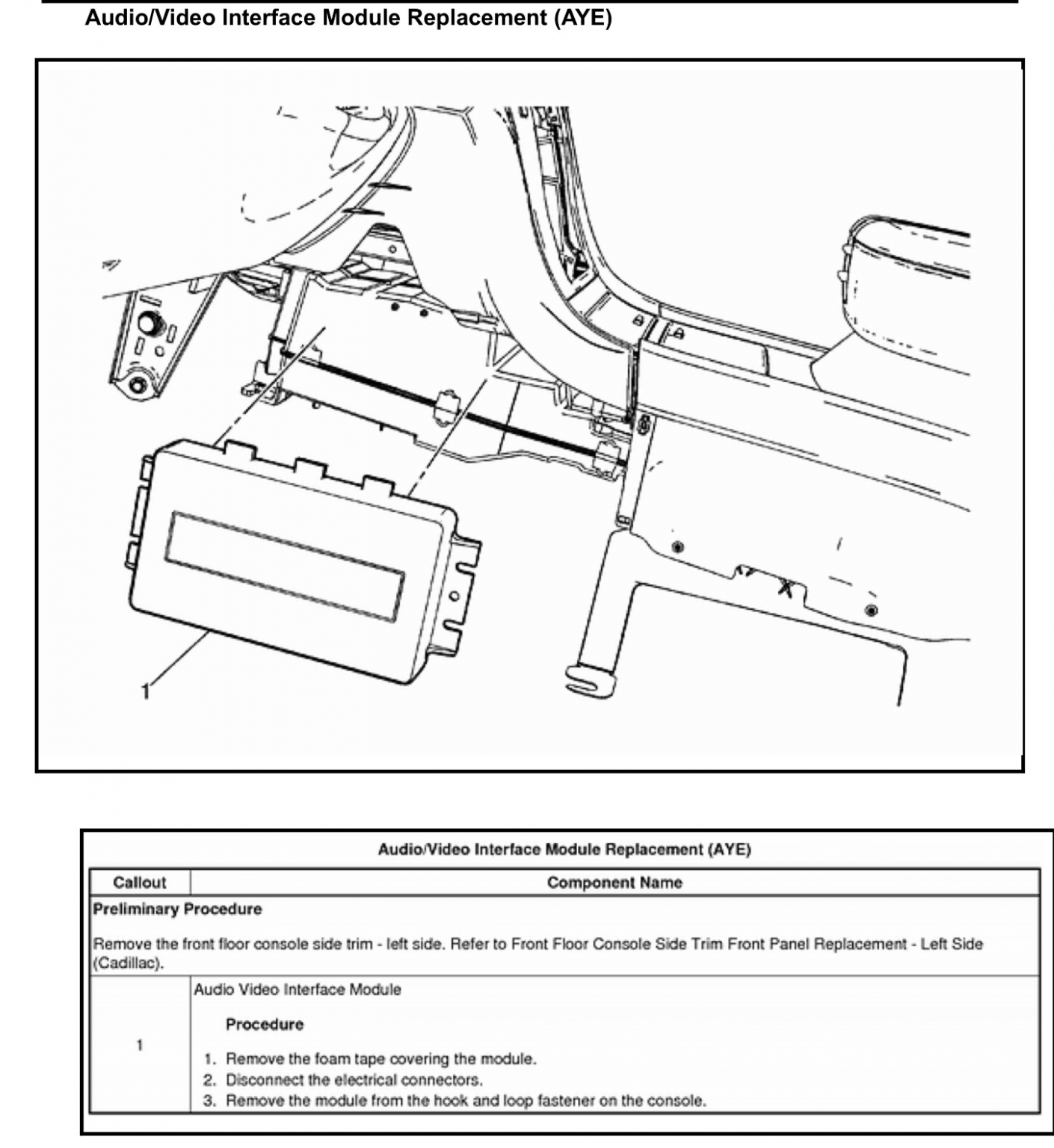

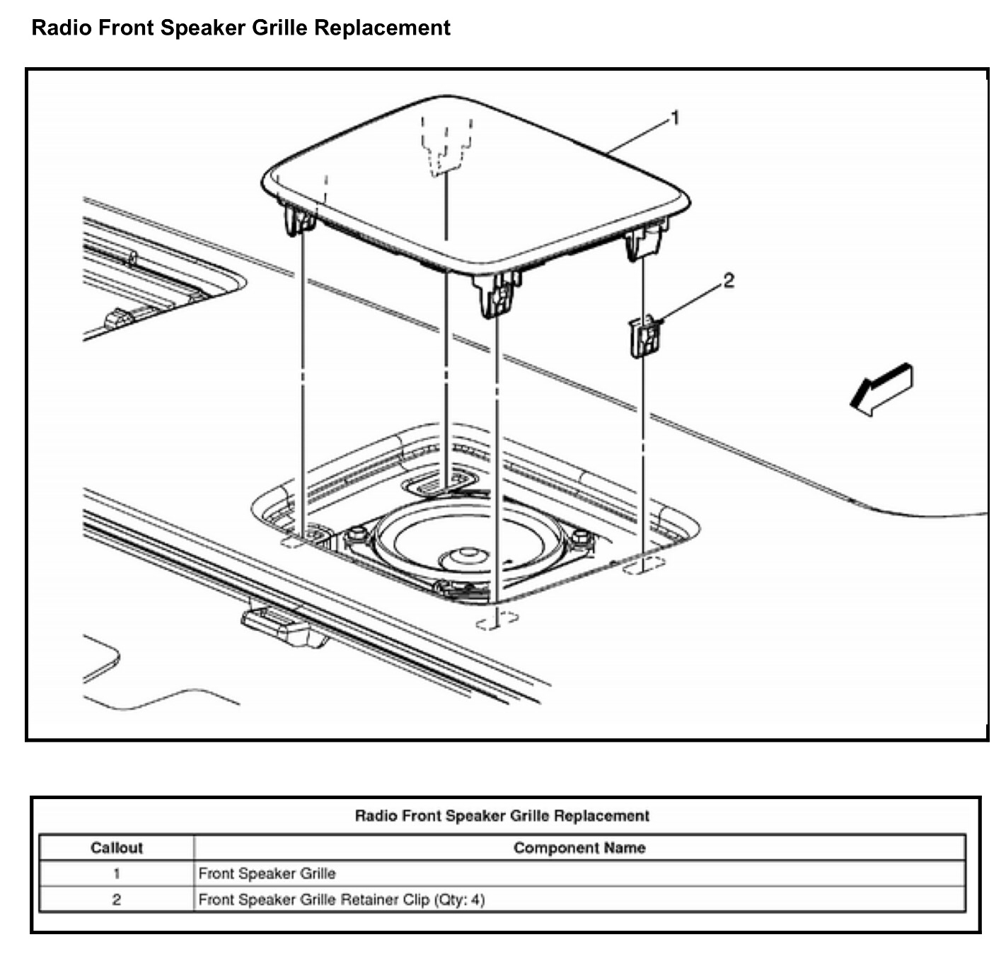

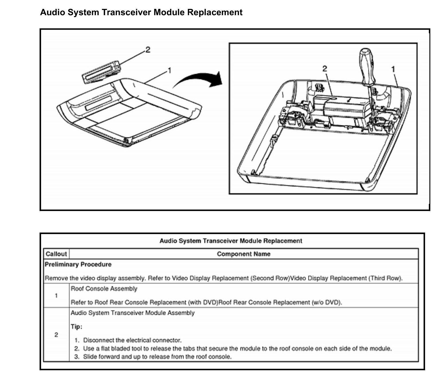

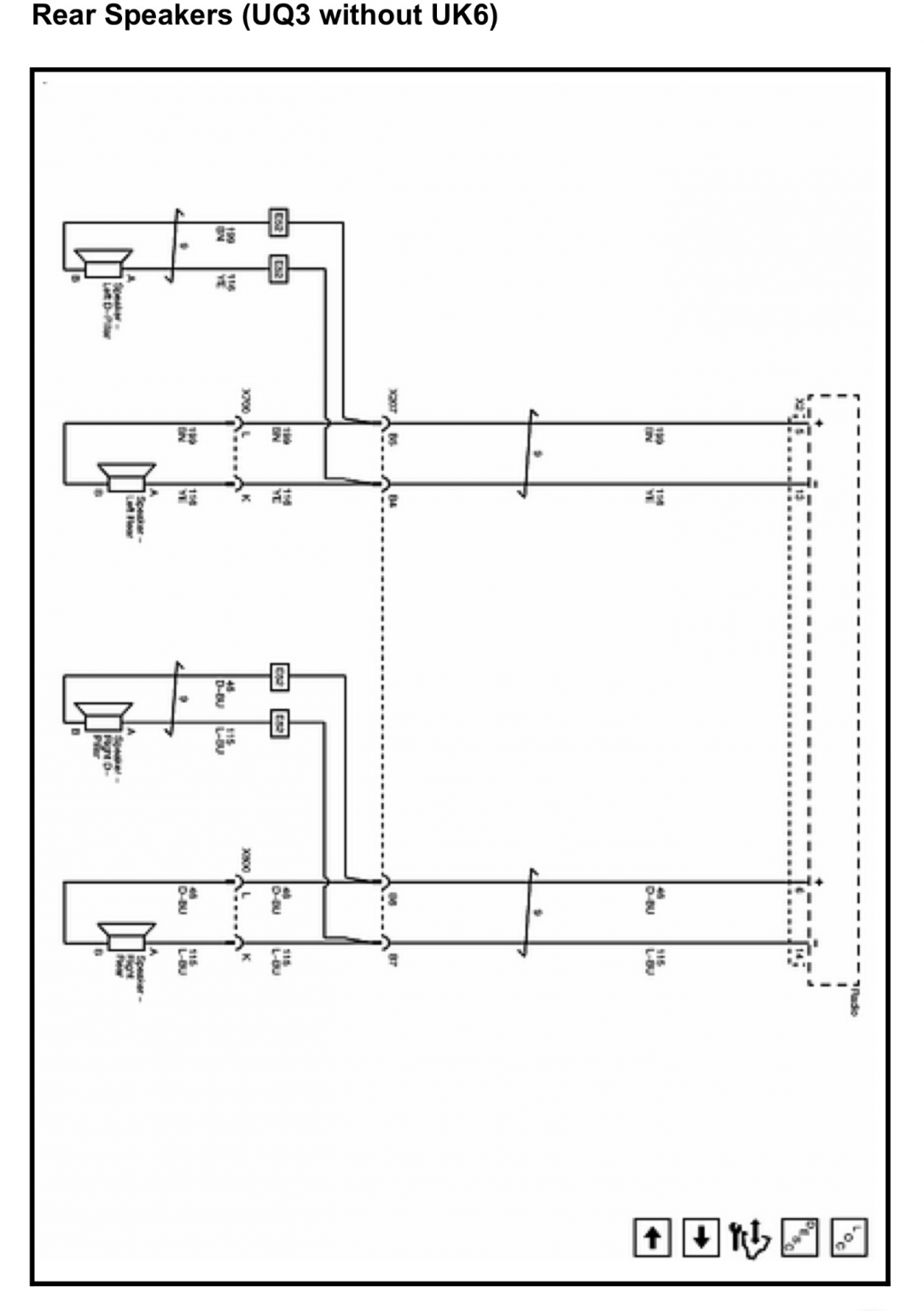

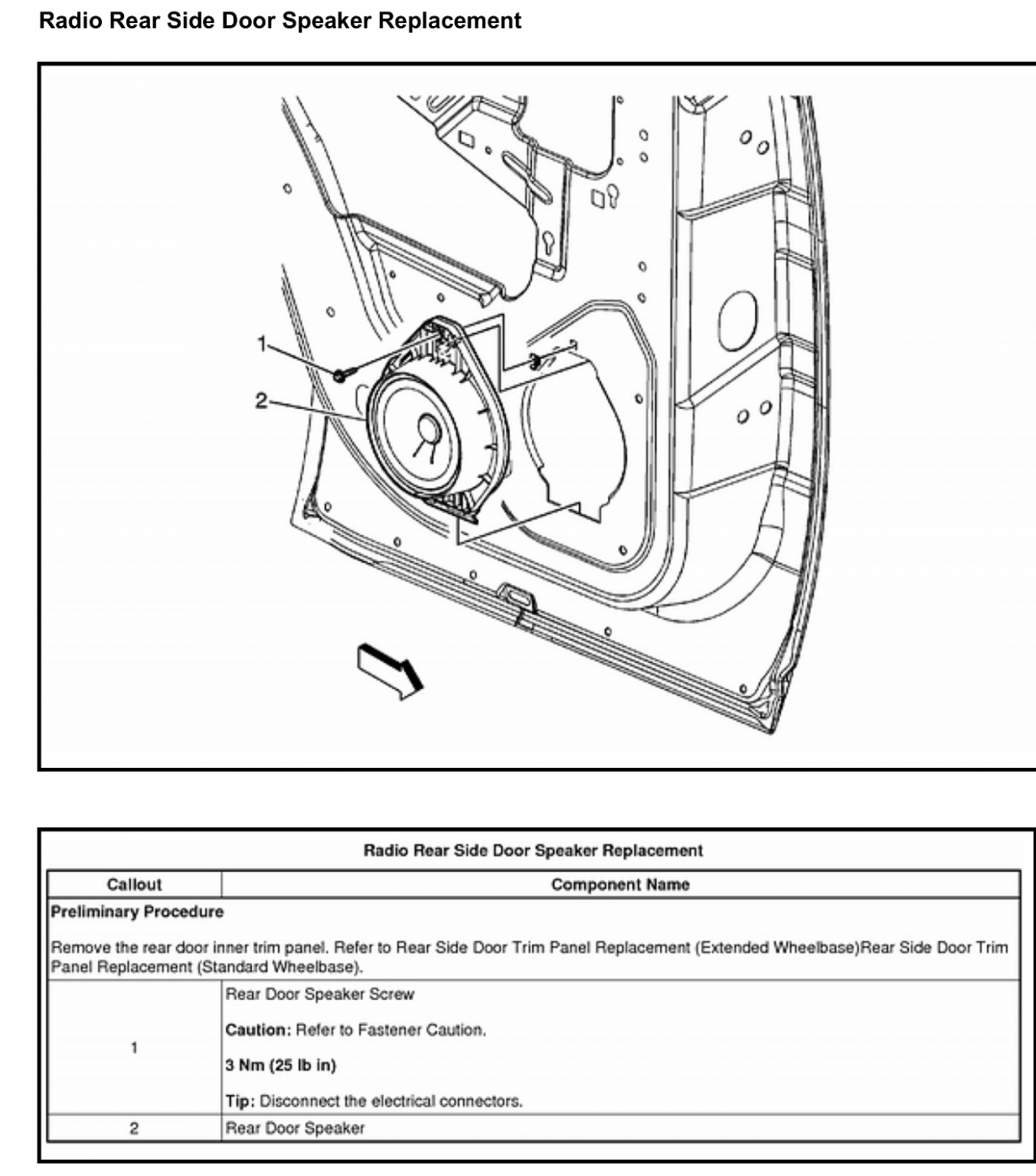

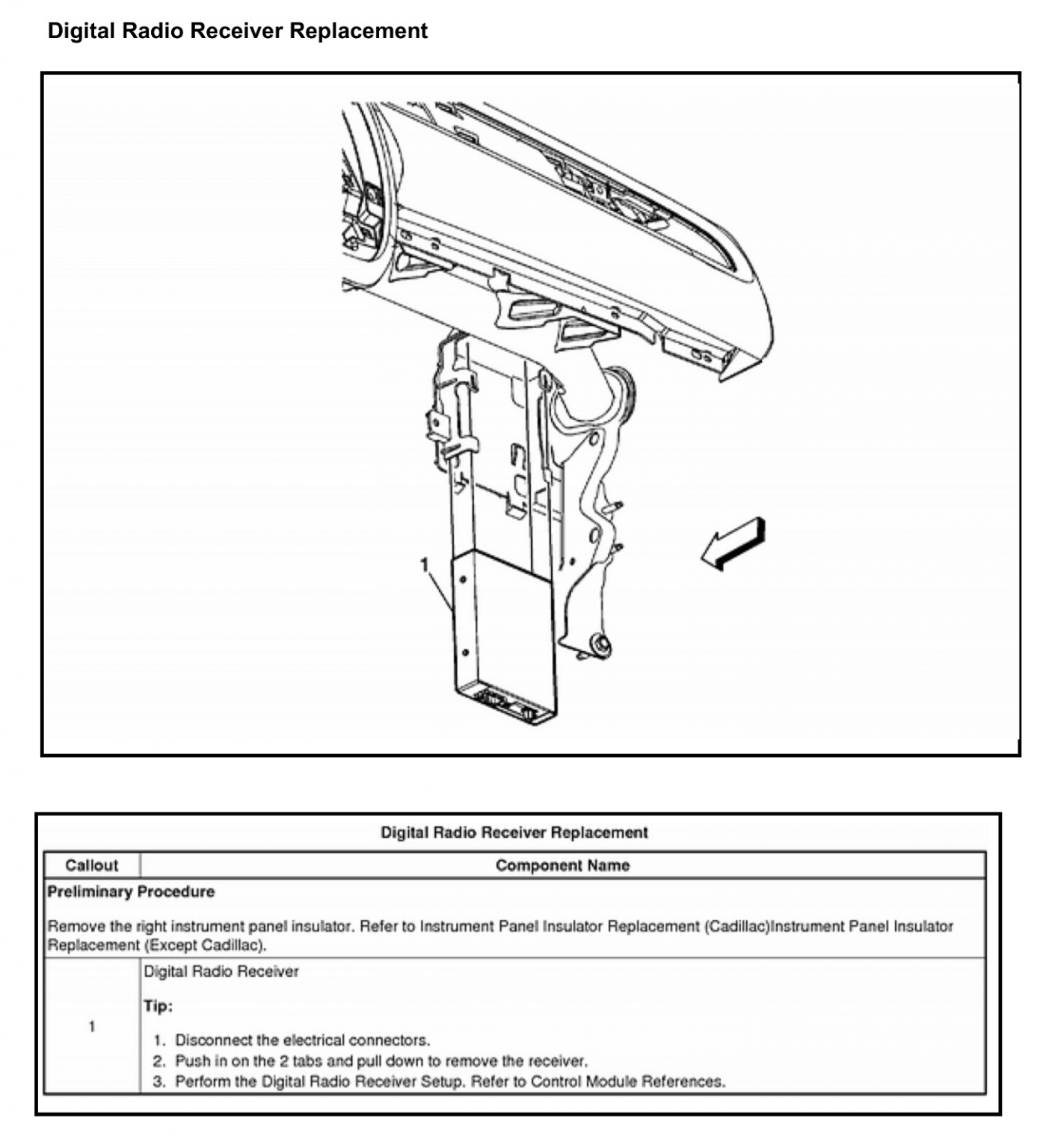

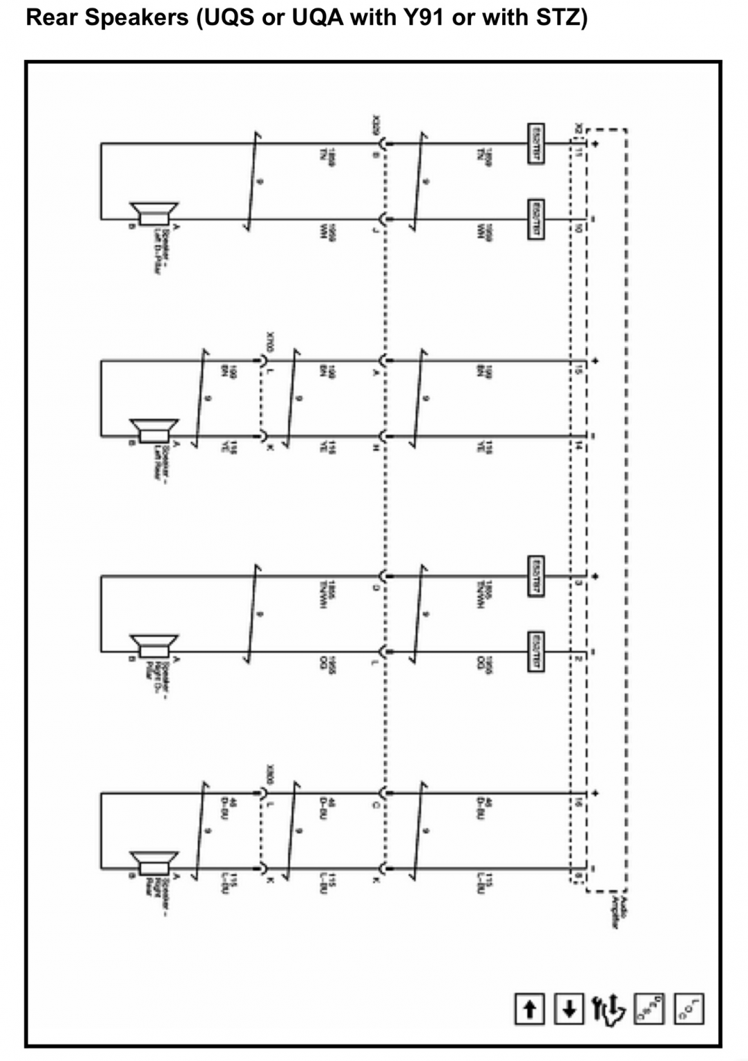

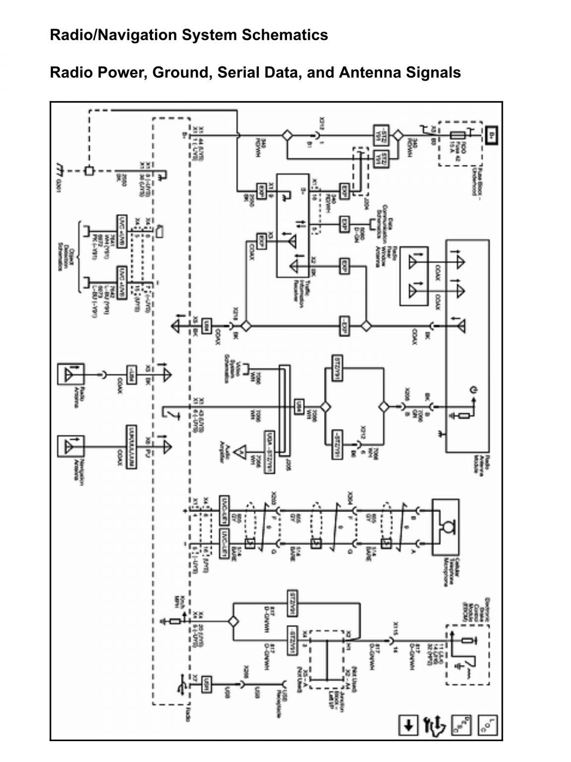

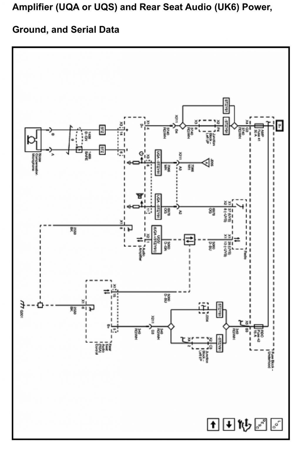

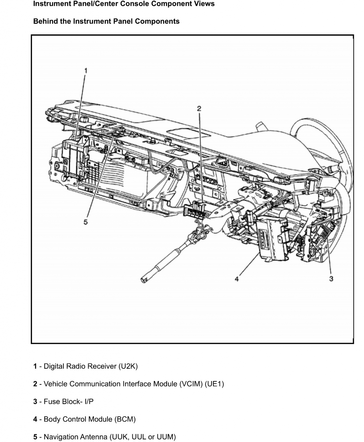

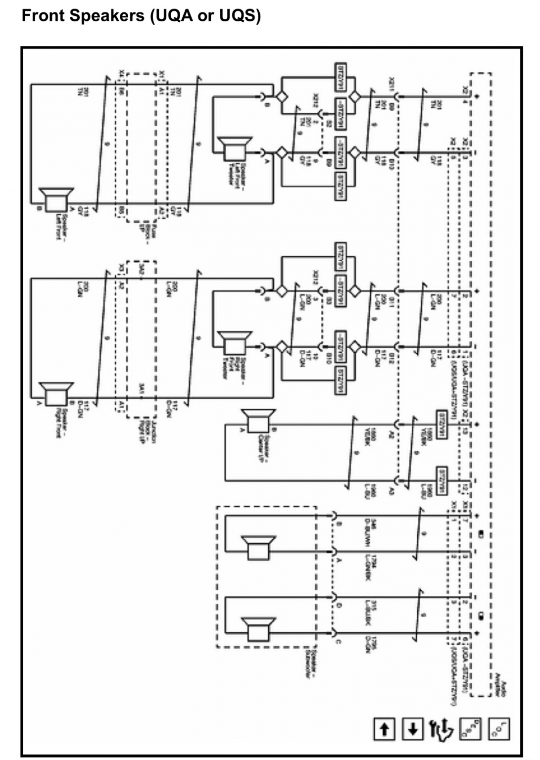

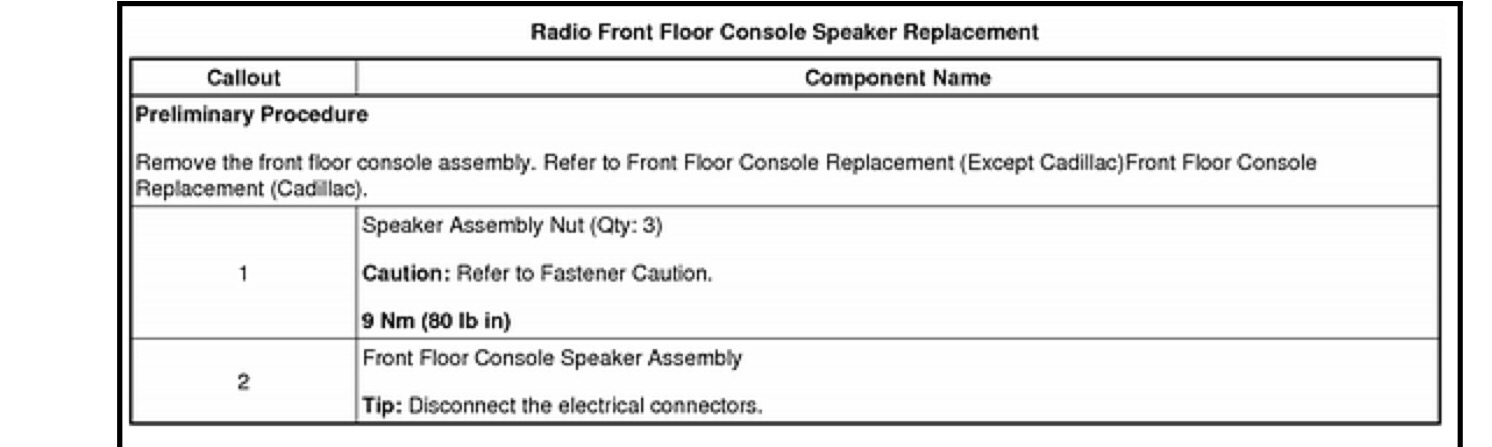

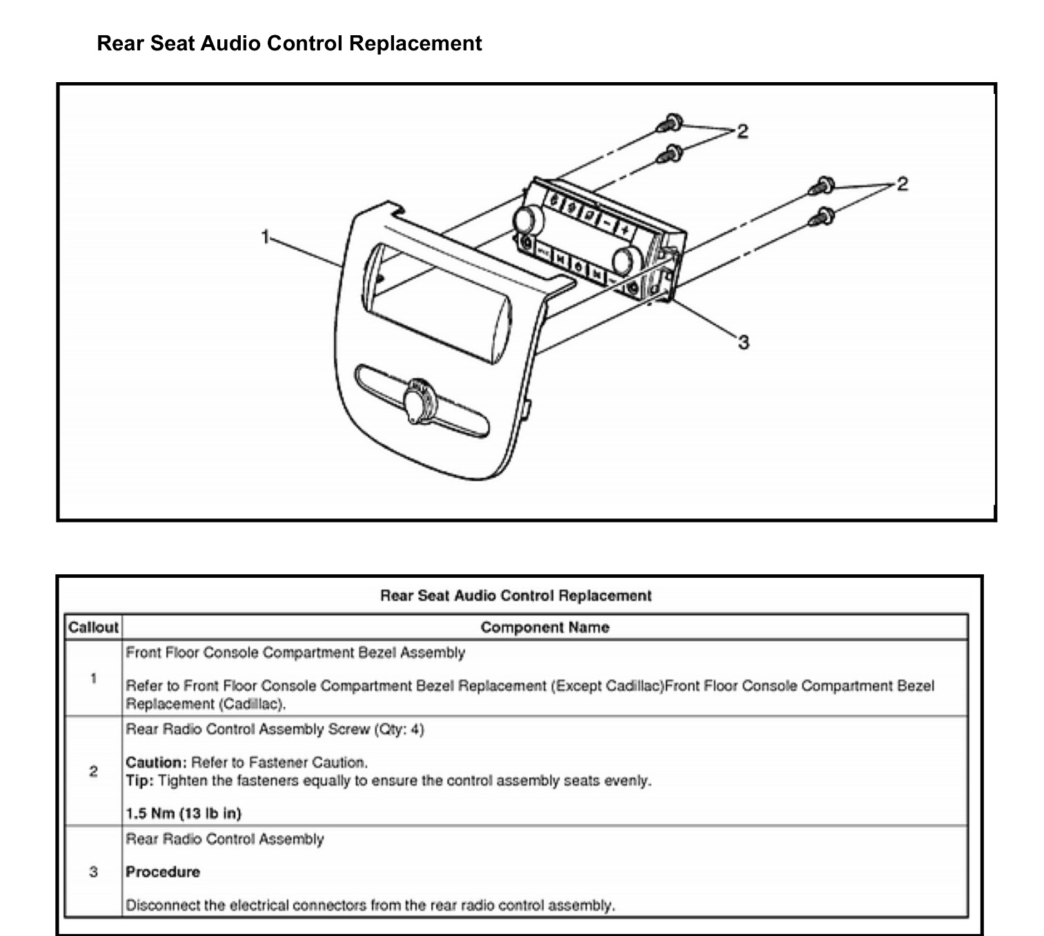

Just got these yesterday. I think it should help out the site.

I see that it shows an amp for UQ3 also, I was under the assumption there was no external amp with that speaker code.
