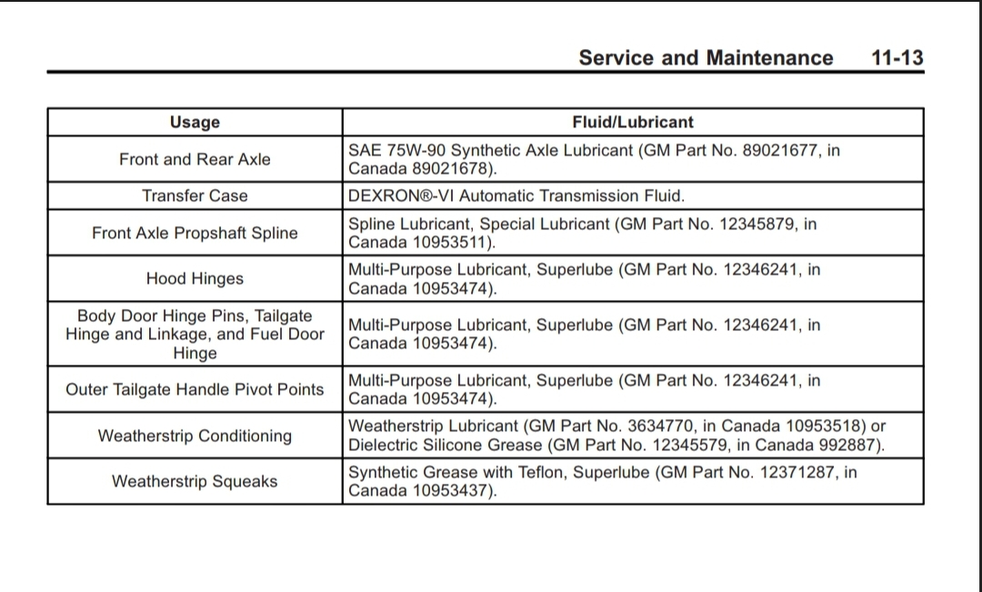

I get lazier and lazier every day, it seems. It is my bi-yearly time to clean and lube the sun/moon roof rubber surround seal and the doors/rear hatch rubber surround seals. I could look it up in my owners manual but it is raining and as I said, I am lazy. Anyone have the GM part # for the lube? I know it comes in a squeeze tube, or it used to anyway, and I think it is a silicone base.
Besides a wet cloth or a soapy wet cloth, what do you use to clean them before applying the lube? Seems to me that using a soapy wet cloth means cleaning the soap off before application.
Any and all help and part #'s is appreciated.
