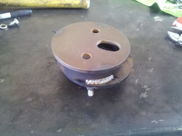

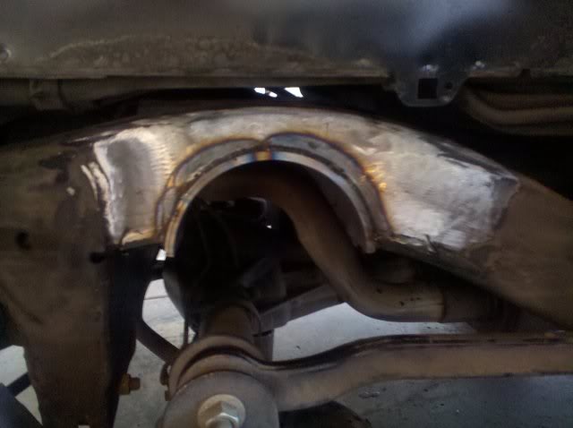

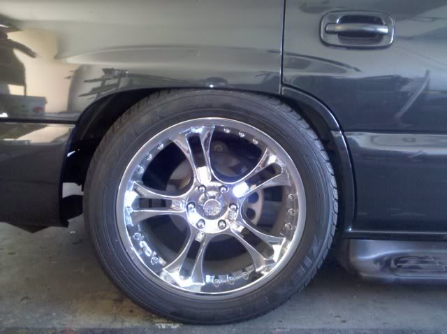

going to pick up my hoe later on today from the shop it is now bagged but not 100% complete yet i got to bring it back prob next week to get my guage pod for my psi guages and for a notch and smaller tires..... cant wait i will post pics when i get it back for now i just got a few pics of it in the shop
any one have any good ideas for tire size the rimsa are 22's
front bracket
in the working
front almost done and no rear springs

You're going to want to run 285's at least to tuck in the rear and you still might have issues. The problem is the axle shifts to the passenger's side as it get's lower so you'll hit the tire when you lower it. You should also have the shop grind down the fender lips for you. I am having an adjustable pan hard fabbed up right now so I can get the axle back over to the driver's side and tuck both rear wheels. You might want to run 275/40's.
Did you get Mob's whole set up....4link and rear axle? If so never mind what I said, he had the rear axle shortened if I remember correctly and the 4 link will eliminate the panhard......

ya i bought mobs set up but only the bags and tank and compresser and valaves witch out of the hole kit i only used the valves i have the other stuff still witch ill be selling but the shop want me to run 265/30 s witch i think is pritty small lol he seys they will tuck fine thats what he has on his show truck but this is a daily driver so and whats this adjustable pan hard you are having done what is is is it a custom thing school me on this haha i have no idea on what you r saying

265/30's will certainly be fine but also rubber bands....yikes, I hope you have nice streets where you live.
Basically the pan hard bar keeps the axle centered but on our trucks as the truck gets lower the pan hard bar kicks the axle to the passengers side, why....I have no idea bad design. At any rate in order to pull the axle back to the driver's side the pan hard bar need to be shorter. They do not sell an adjustable pan hard bar or a pan hard for lowered Tahoes/Yukons so I am having my buddy fab an adjustable pan hard up so wee can dial in the rear axle. This is very common on mustangs and hot rods but being that 6Klb SUV needing an adjustable pan hard is fairly uncommon they are not available. You could do the math and just make a shorter bar but with an adjustable you can really dial it in. I run 285/40/24's and I need 1/4'' in my passenger's side to tuck and get down all the way but I have like 3/4-1'' on the driver's side. Also, make sure they either roll the rear fender lip or just cut it off(mine are just cut and ground down) or you run the risk of cutting your wheels up......

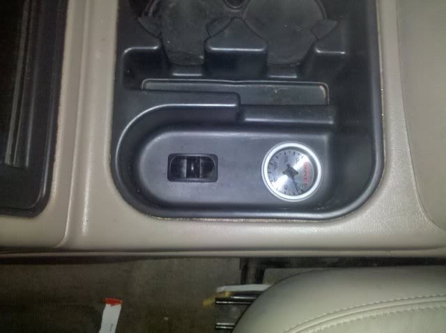

just pick it up a little while ago its bad ass i been driving around for about 2 hours messing with it lol ill post pics tomaro i only got 1 question for bagged ppl my service ride control light is on is ther a way to trick that n get it off?

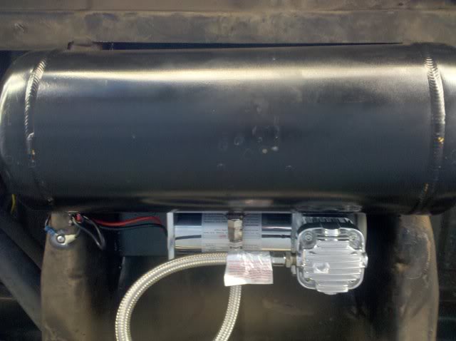

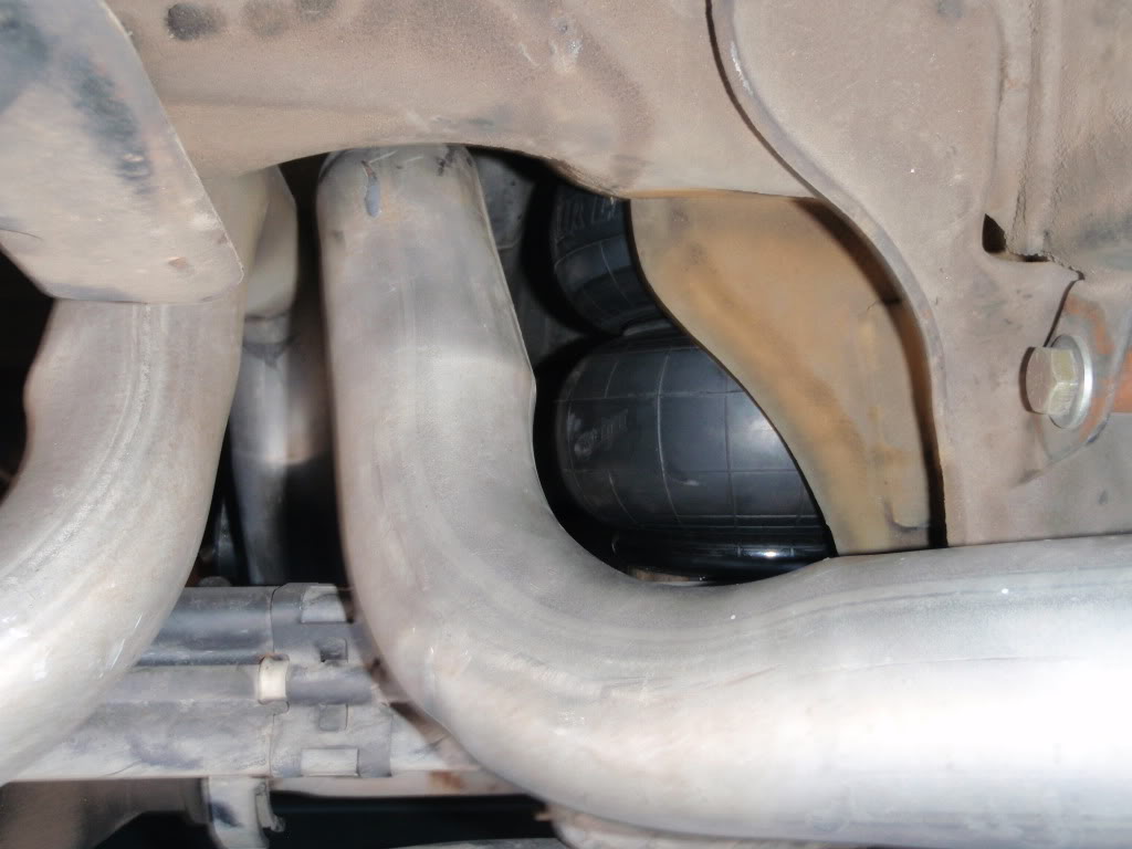

pics are in
i got to do some undercoating

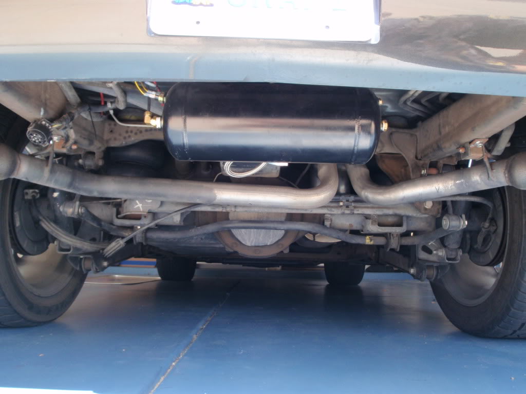

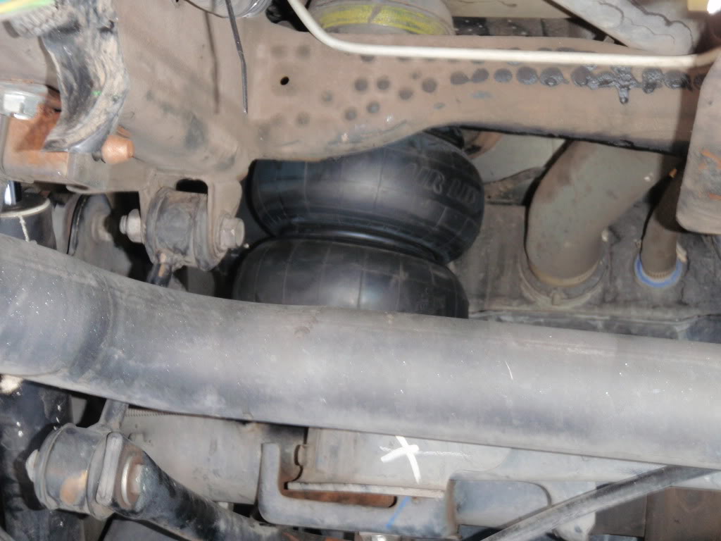

cant wait to see the pics! and also how low the rear will go with the notch...get a pic of all the stuff under the truck so we can see the set-up!
with the notch it should go about 3 inches lower but when im getting the notch im also going to get smaller tires im running 305 40s

thankx and im not running any shock didnt no i should be what do u run this thing feels like your jumping on a pogo stick it hopes every were do u have a pic on your rear

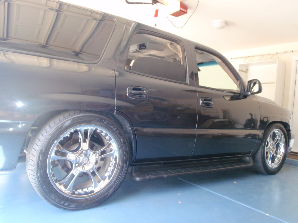

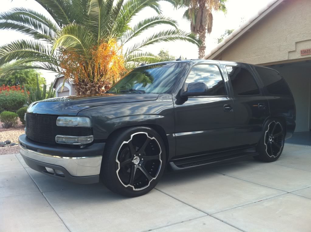

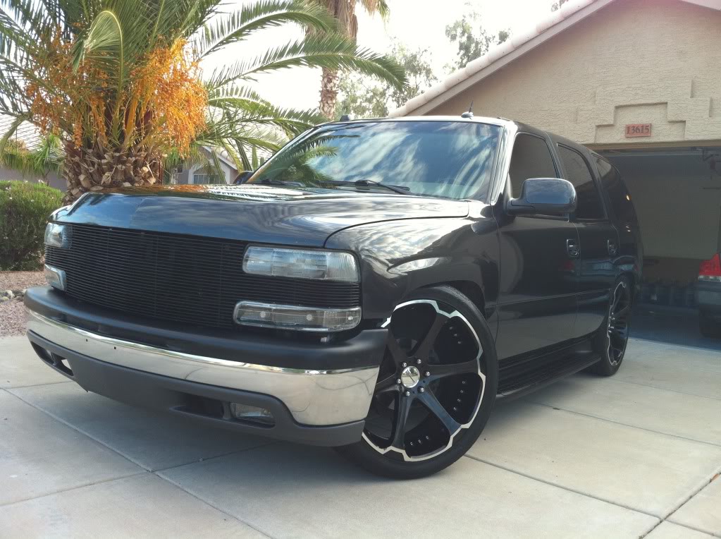

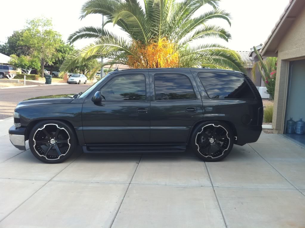

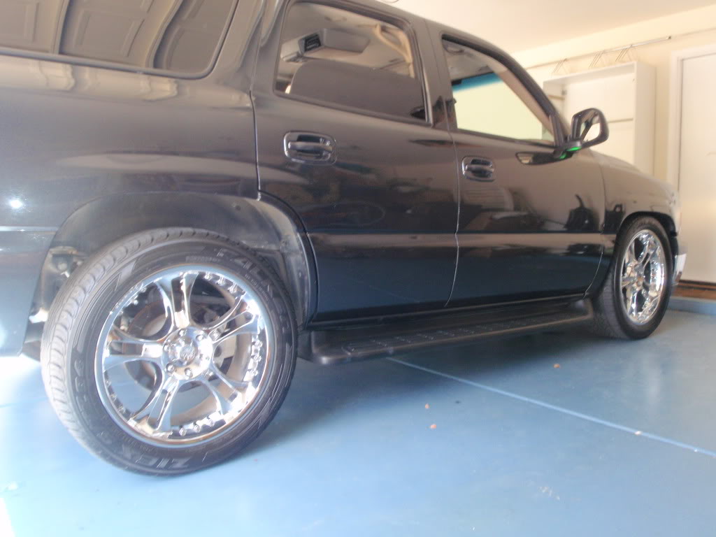

Get some shocks homie.... I am just running my McGaughy's drop shocks but am thinking about going with some Billsteins. Here are some pics of my rig...
Before new wheels.....
As she is now:

Good call. It looks like you might need shorter end links on your sway bar as well, that could be causing a lot of sway for sure if you have the stock end links on. Was your truck lowered before the bags? If it wasn't lowered at least 5'' in the back you need a few things:
-shorter end links on your sway bar
-sway bar needs to move over about 2'' to the passenger's side to clear the pan hard bar. You just have to move the driver's side bracket over
an 1'' or so and get offset end links
-Trailing arm relocators. These will help with your pinion angle(I'm pretty sure that is what they do) but you need them for a 5''+ drop.
If you don't have any or some of those components that is certainly the cause of the sketchy ride. If you have those things then the shocks should hem it up. It also looks like dude left your bump stop brackets in with no bump stops, you should just cut the whole bracket off it will give you a lot more travel. It's like 30-45min work with a sawzall. They will have to come off when he notches it anyway.
I'll tell you what....looking at your undercarriage makes me soooooo glad I live in AZ. That is some rusty ass shit there........
