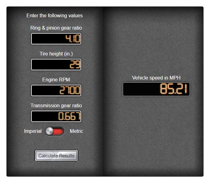

My question is the following: Just like all of you, I assume, I have the 5.3 LMG with 6 speed 4L80 and 3.07 rear diff. I will never take the tahoe above 100 max and would like to tow with it (my rubicon and hellcat.) So I want to re-gear... I know stock tahoes are 3.73 but they also have taller tires. (Eventually I will increase the tire size a little) I am thinking of getting 4.10 gears - for quick take off and good towing, but need to figure out how high the RPM's will be on the freeway doing 80-85mph. Does the tahoe have a double OD? Final gearing ratio? anyone have some first hand knowledge on gearing to 4.10 and stock ppv tire size? Is there a good calculator for this somewhere that I missed in my search?

This site helps a lot:
https://spicerparts.com/calculators/transmission-ratio-rpm-calculator

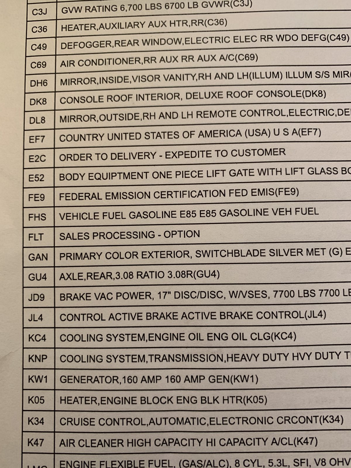

Your transmission is a 6L80, and it has 2 overdrive's. 6th gear is a .667, you'll need that number when using the site I added. Your PPV may have 3:42 rear gears, GU6 is the code for that I believe.
Thanks for the calc. I def have 3.08’s. Thinking 3.73 might be the way to go.

Thank guys, looks like I found my answer. I'll go with the 4.10 gears, as at this point doing 85mph I would be running at only 2700rpm. Once I'll up the tires to 30/31, it will drop down to 2600/2500. This should make the truck a lot more driveable as most of the time I run these speeds is me going from Phoenix (1000ft) to Flagstaff (7000ft) and currently it's constantly downshifting go get more power just to maintain the speed uphill. I know the mpg's will suffer but I didn't buy the Tahoe for its great mpg's. (Actually deactivated the AFM as soon as I got it.)
@mikeyss Thanks for the link and the .667 as that was my missing link.
