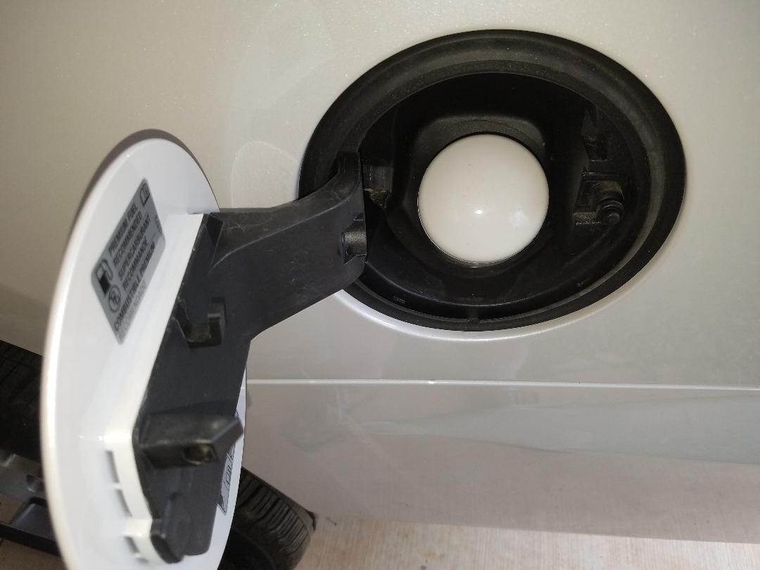

Yeah, weird, huh?
But if you really want one...
https://amistyling.com/cap-less-fuel-filler-dust-cap-6540

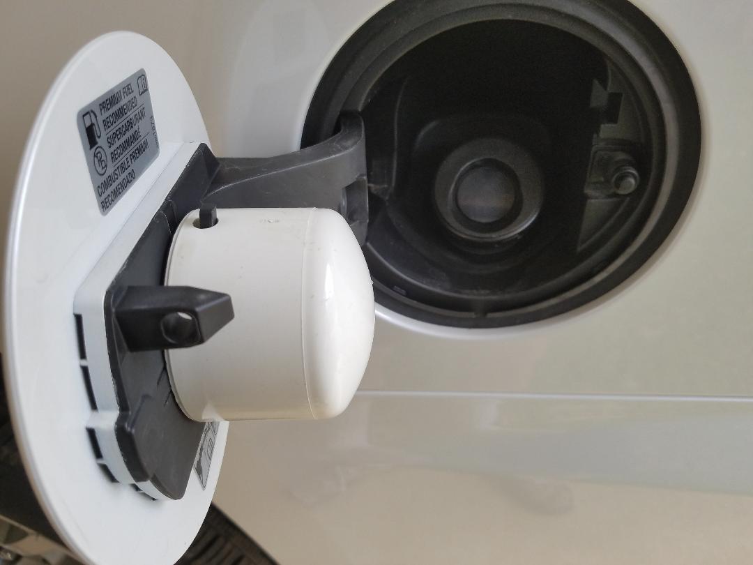

Then there is Sch 40 PVC 2" pipe cap for about a Buck. Drill a hole towards the bottom and hook it to the door. Water tight and dust proof , matching colors for White and Black vehicles .......

It's been on a couple months and doesn't seem to affect anything. The "capless "filler is sealed so there isn't any venting concerns. I've knocked it off the hook while filling a time or two and that is the only drawback I've had. I've noticed some water and dust behind the door at times so this is just a little extra insurance

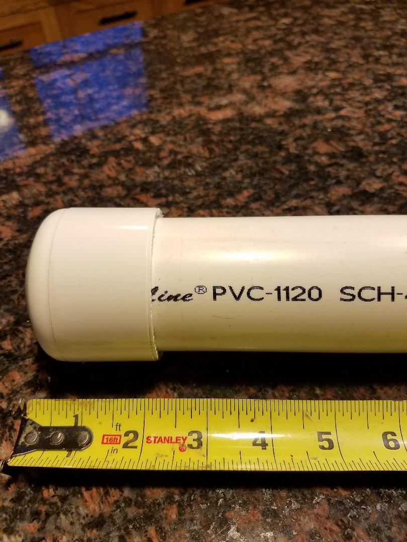

2"I'D Sch 40 PVC Cap is 2 3/8 ID. Works like a charm. Drill u a little hole and hank it on the hook or attach some cord.
Yep, 2-3/8" ID
Nope, no workie for me. Mine just slides around on the slightly raised area. It doesn't stay on there. It looks like mine needs to be 2-3/4".

What year is yours? Mine is 2 3/8 diameter and slips right to the base of the filler. I'll take more measurements in the AM and post it. Sorry it didn't fit

Cap I'm using is 2 1/4 long, 2 3/8 ID. SCH 40 PVC. Fits all the the way to the bottom of the filler. Someone posted vinyl caps on this site to cover the filler for about @ $10..... My Denali is an '18 .
